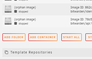

The way you are meant to configure/add folders is under the docker/vm page so goto e.g the docker page then at the bottom there is a add folder button (same for vm)
i can see how this might be confusing as every other plugin you can just goto plugins/plugin name
GuildDarts thank you so much for the swift reply and the great work you've done!
Works like a charm now.

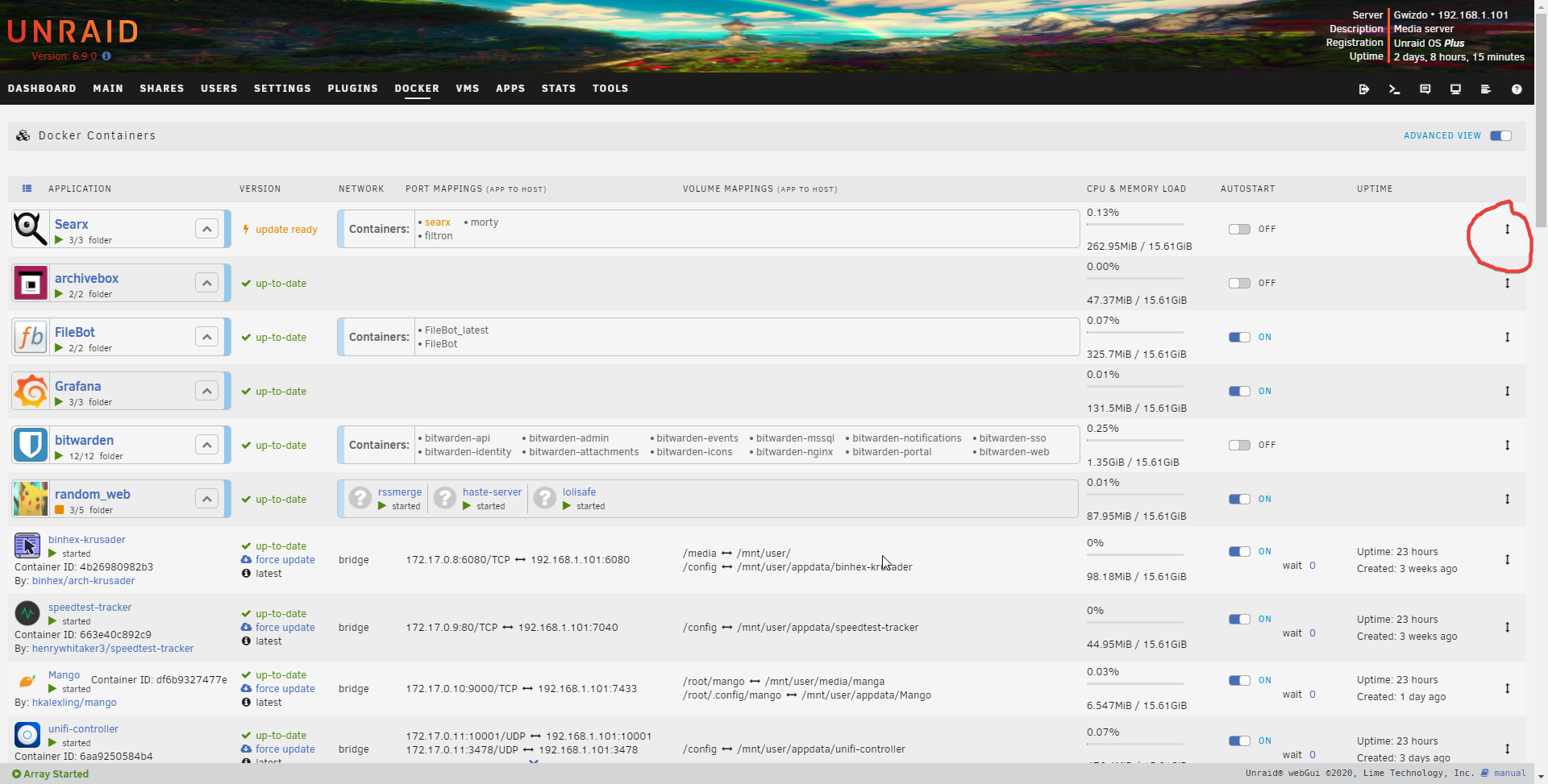

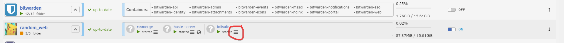

@GeneM @Alex.b
In unraid 6.9.0 you have to drag via the new icon on the far right
This also caught me off guard at first :)

Has the Log button also disappeared with the 6.9 update? This is now only possible via the context menu. In the folder settings there is also no possibility for it.
Yeah i think it has, tho thats a default unraid change
