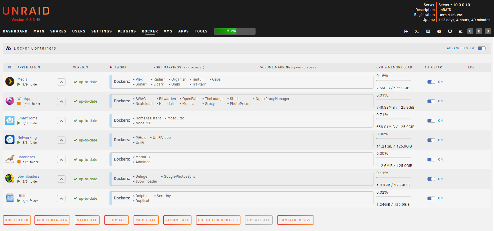

8 minutes ago, sjb217 said:
I created a new folder with only stopped dockers. As soon as I clicked SUBMIT, I lost all folders.
Now when I click on the IMPORT/EXPORT button, the only folder showing is the one that killed it.
if you do
cat /boot/config/plugins/docker.folder/folders.json
can you see all your folders or only the one the killed it all
What did you name the folder that killed it, in your screenshot the folder has no name

The folder was named "stopped"
@sjb217 this has me pulling my hair out. Can't seem to figure out why that would happen.
Just made a folder named "stopped" added only stopped dockers and it works
I really wanna figure out why this is happening but don't know where to start :/
could you try another reinstall and if it happens again, tell me what you did to cause it :)
Edited by GuildDarts
Sure, I'm rebuilding my folder structure now.
@GuildDarts i had this issue when i've updated the plugin but the folders.json file had version 2 and there was no settings  variable inside of it. @sjb217 might also have the lower  version inside that file, hence the reason why it is not working as expected. Deleting the file and then refreshing browser twice made new file with correct version and everything just worked as intended
P.S. re-install of the plugin wont fix the version or any issues with folders.json for some reason
Edited by darki73
@GuildDarts , I have re-installed the plug-in and set up my folders.
I can safely re-order the folders and re-order the dockers within the folders.
All is stable again. The folders.json is version 4 and I see the settings variable.
But at the moment, all folders have at least one running docker inside.
I predict that if I create/modify a folder to have no actively running dockers, the plug-in will fail.

On 3/13/2020 at 10:38 AM, Roxedus said:
By not adding (more like forgetting) to add a icon, the folder actually never shows, and are nowhere to be found in the gui. Deleting the folder in the json squid mentioned does not resolve the issue, only deleting the whole file helped.
Edit: seems like it was not the missing icon, rather the space in the name
A punctuation in the folder name seems to have caused a similar issue. Renaming the folder to a new name with no symbols fixed my issue.

I have a problem that my folders do not appear on the Dashboard.
It worked for a short time some weeks ago and then it stopped working.
Is there any setting I am missing that disables the folders on the Dashboard?
I reinstalled Docker Folders to check if this helps but it did not.
sorry about that
sort of recently i added VM support and it looks like if VMs are not enabled the dashboard does not work.
Might be what causing it for you, try enabling VMs and see if that fixes it also check browser console for errors :)
 in any case will fix that as it is an issue but might not be yours ^_^
Edit:
Just pushed an update that should fix the dashboard not working with VMs disabled.
Hope this was your issue if not check your browser console for any errors ^_^
