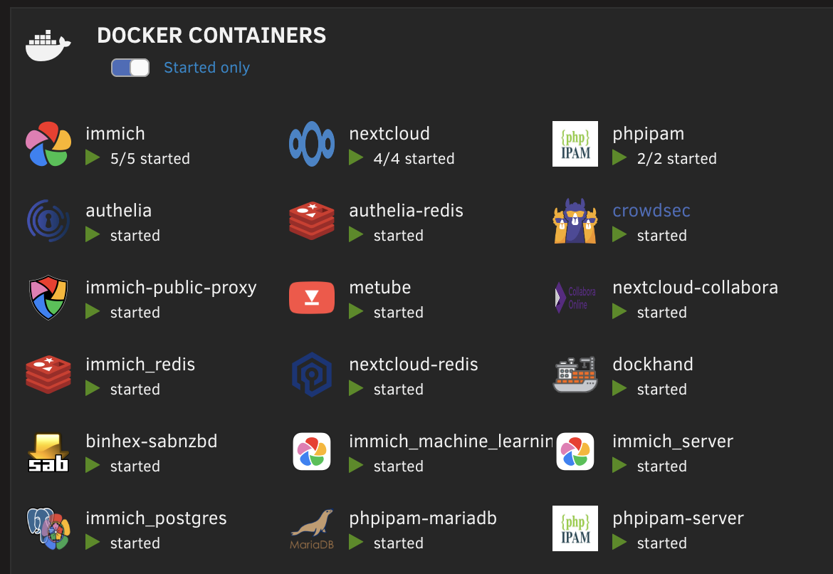

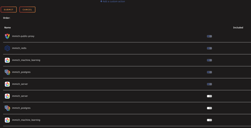

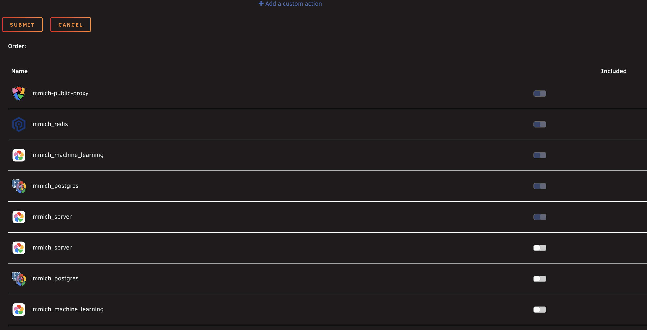

  3. Yes I am on the stable branch of your fork. I got the toggle and tried both, on and off. I can give you more details on how it behaves. My scenario: I have 3 folders created manually. I added labels to some containers to sort them into the 3 folders. All other containers are not labeled or sorted into a folder. On the Docker tab everything is like expected. Labeled container are being sorted into the folders, not labeled containers just get listed below. On The Dashboard tab I can see the folders and the containers. But the wrong containers are being sorted into the folders. E.g. immich contains 5 other (not labeled) containers and not the immich labeled containers. When I click "expand" on the folder I can see the wrong containers getting expanded. Could this be a caching issue with the old plugin? What do I need to do to start over completely fresh (deleting all previous folders, icon and so on currently generated and maybe cached)?
  4. I am having an issue on the unraid dashboard when adding the containers to the folders via labels. The dashboard shows the folders with "x/x started" but also each container of the folder as well again. When I view the folder settings I can see that the container got automatically added to folder via the label but somehow shows up again below those. On the Docker tab they are only shown within the folder. But on the Dashboard tab folder and additional containers are showing.

  6. I think there was a misunderstanding. @bmartino1 is talking about appdata folders on the filesystem. I was talking about folders in folder-view. Anyway, I testet precreating the folder.view folder. Then startet my stack and the container are getting sorted into the folder. So just adding the label is not enough, we have to create the folder.view folder before. Maybe this can be added to the first post of this thread.
