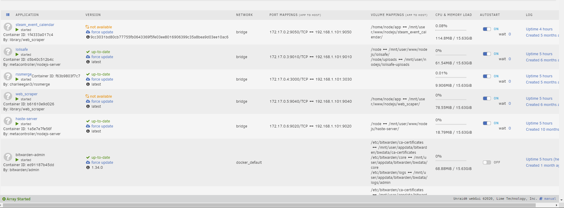

On the docker list page, the only issue now is that the version could show a long string and reproduce the issue of the page stretch. For example:
You may notice this is abnormal behavior, which it likely is. Some of my dockers aren't added via Unraid, so they show values like this, but the dockers still work perfectly fine.
I dont think this is a docker.folder related issue more of a unraid itself issue
What you could do its use theme engine and then in "Custom styling (advanced)" add something like

So it still happens without docker.folder that you have to horizontal scroll, however its no where near as bad as when the docker is inside a folder.

For Unraid 6.9.0-beta23 I have added a truncation of the version identifier to prevent too long strings.

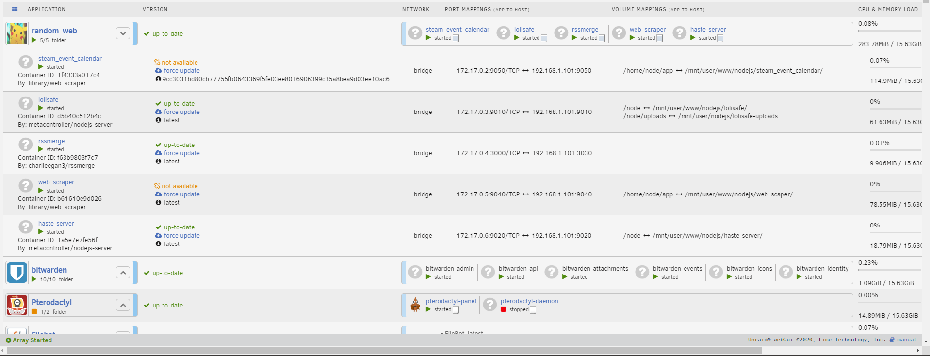

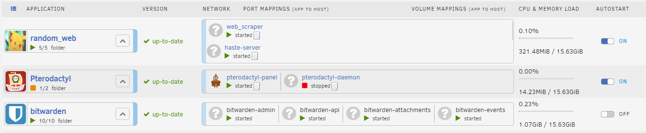

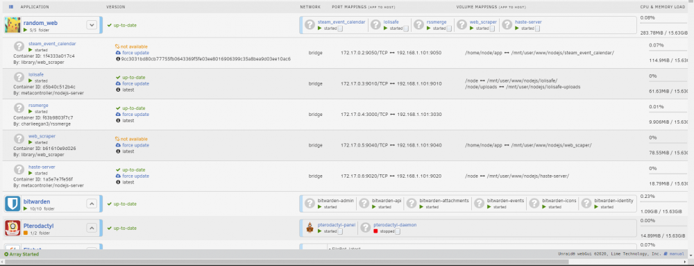

  • When docker folder is open and closed whole table "jumps around". See pictures below
Closed
Open
Columns Application, Version and Autostart stays in place but Network jumps to the right and Ports a Volumes to the left. Additionally Docker preview list jumps to right too. I would prefer if all columns stays static. Maybe it would be better to indent only Application column (to give it subcategory feeling) and leave all other aligned. I guess this originate from time when there was only simple folders but now (at least for Docker preview list) it looks weird (not aligned with column header).
Will see what i can do about this, but no promises

  • Fixed: expanding folder shifting EVERYTHING

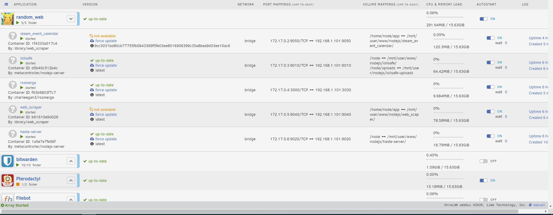

Looks much better now but columns in table header still jump little bit. But it's more like cosmetic issue with low priority when you have time.
For me only one of my folders makes the header jump a bit, and thats my bitwarden folder. I think it happens because the network text is wider, so that adds a bit of width and shifts the port and volume colums. Does it happen for all your folders or only some like me?
i'm a bit unsure of the best way to fix this, but will try and figure it out ^_^

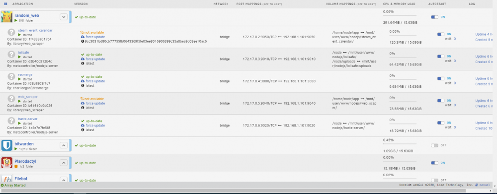

For me it happens for all folders. But it looks like it depends on content of all three (Network, Port, Volume) columns. For bridge network it jumps to the left, for container ref network it jumps to the right. And when there is long volume path then network column is narrower (easily visible on container ref network because it overflow to another line when it's on one line in another folder).
You will probably be able to simulate it if you change width of your browser window. I'm using Tree style tab on right side in Firefox so my view area is more like old 4:3 monitor :)
And when I think about it maybe docker tab table is designed this way, to rearrange itself based on content. Only it isn't visible because it always show all containers so it remains stable. But for your plugin it doesn't work well.
I think you're spot on. I have an idea of how I might be able to fix it, will try it later today and see how it goes :)
edit:
So after a bit of playing around i found a fix.
What i do is get the width of all the columns before the folders are created then apply the width once folders are created.
I have attached a zip file with the changes so you can check if its works for you, as i was unable to get it to happen on all my folders even with Tree style tab on firefox. If it works for you and there are not issues, then i will add it as and option ^_^ DockerFolder_Docker.zip (just replace the existing one in '/usr/local/emhttp/plugins/docker.folder/')
Yeah, this works perfectly. Tried "madly" clicking around and table stays nice and static :)
