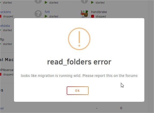

Hi i have this error since last update ???
Well dang, your the second person the report this which makes me kinda worried :/
In any case just a bit up the thread Moose_Flunky is reporting the same thing.
You can try and goto "/boot/config/plugins/docker.folder" there is folders.json and folders.backup.json.
if you dont mind could you attach both of them in a post so i might be able to see why its failing.
If i can't figure out why you can just rm folder.json and remake your folders, not ideal but should fix the error
it's ok now.
i have rm this 2 json files...
4 minutes ago, troyan said:
it's ok now.
you only need to rm the folders.json but can do both.
there are 0 folders in the json ;(
did you have any folders or did you just have the plugin installed?
asking because Moose_Flunky only had it installed with no folders so that might be linked
Edited by GuildDarts
i have only installed plug-in :(
i have no folder...

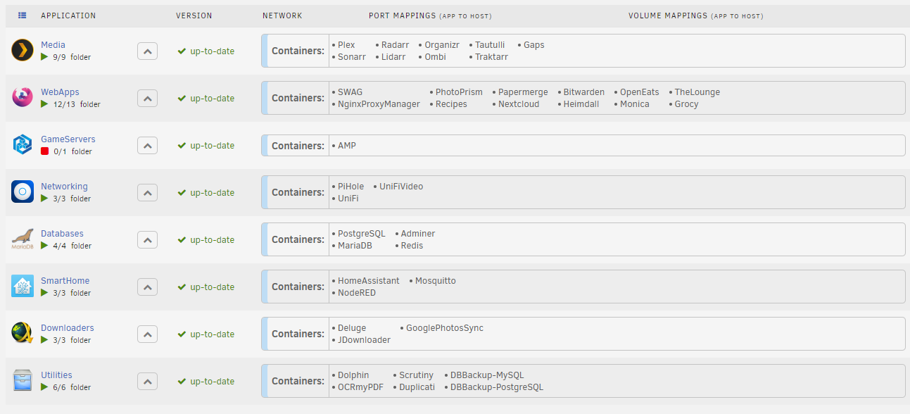

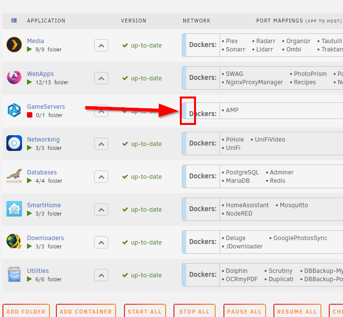

This is fantastic and has allowed me to be way more comforterable having more containers and even working on more containers myself.
One thing that I noticed today, if you make a folder with only one container in it, the "Dockers" label gets all wonky looking.
It is centered vertically, but the height of the table it's in, is cut in half it seems since there's only one container.
It would look much better if even with one container in the folder, that it stays the same height.
This is my OCD. :)
EDIT: Forgot image
2 minutes ago, jonathanm said:
@GuildDarts,I have a really pedantic observation, act on it or not, doesn't matter. It's becoming common usage anyway, regardless of accuracy.
The applications managed by the docker engine are containers. Dockers is a clothing brand.
To be technically accurate, the label referenced in this report should be "Containers" not "Dockers"
Yeah you're right, think i even fought myself about it but just decided that docker was the more friendly thing. Will change it ^_^
Update
  • Fixed: Align preview no-icon text with only one container
  • Fixed: folderId showing instead of folderName
  • Change: Use "Containers" not "Dockers"

Awesome, thank you so much for this!
I spent a lot of time figuring out exactly what settings I wanted to get it looking like this.
Will SOME DAY go through and pick custom icons for the folders, but right now I'm just using some primary apps as the icon.
My OCD is cured, almost!
If I had an option I'd personally prefer that the single-item folder is still the same hight as all the others, but either way it's centered now and looks better than before!
EDIT: Forgot screenshot (again)
Edited by CorneliousJD
Update
  • Change: Make preview no-icon fixed height
    @CorneliousJD Hope this cures your OCD xD

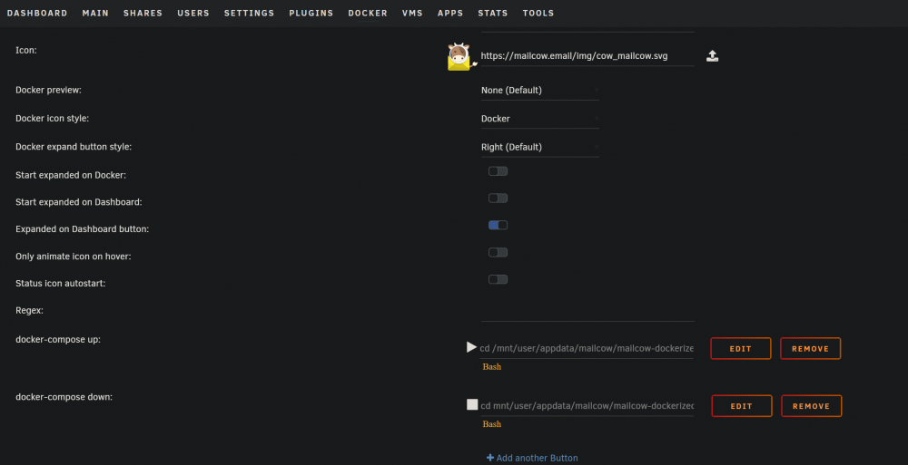

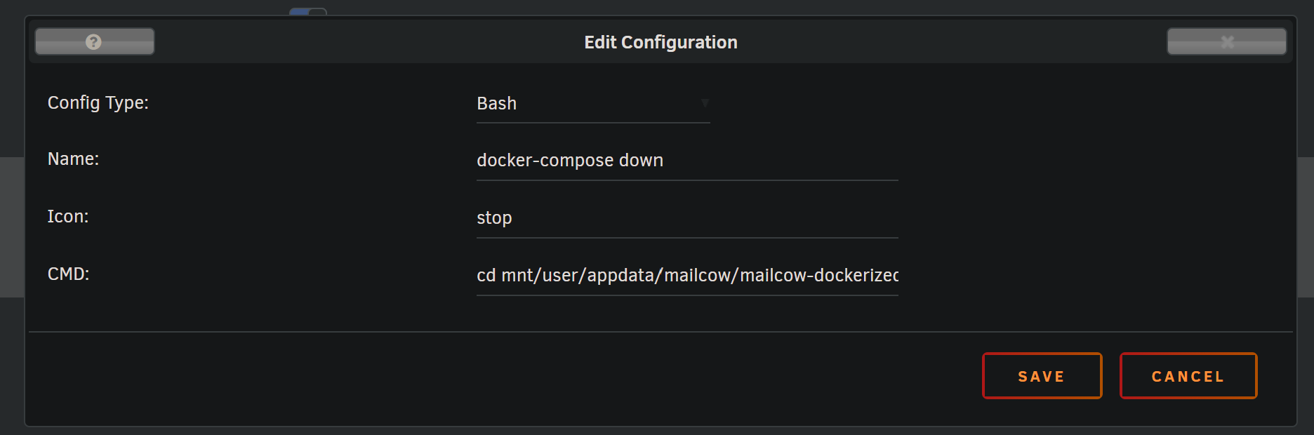

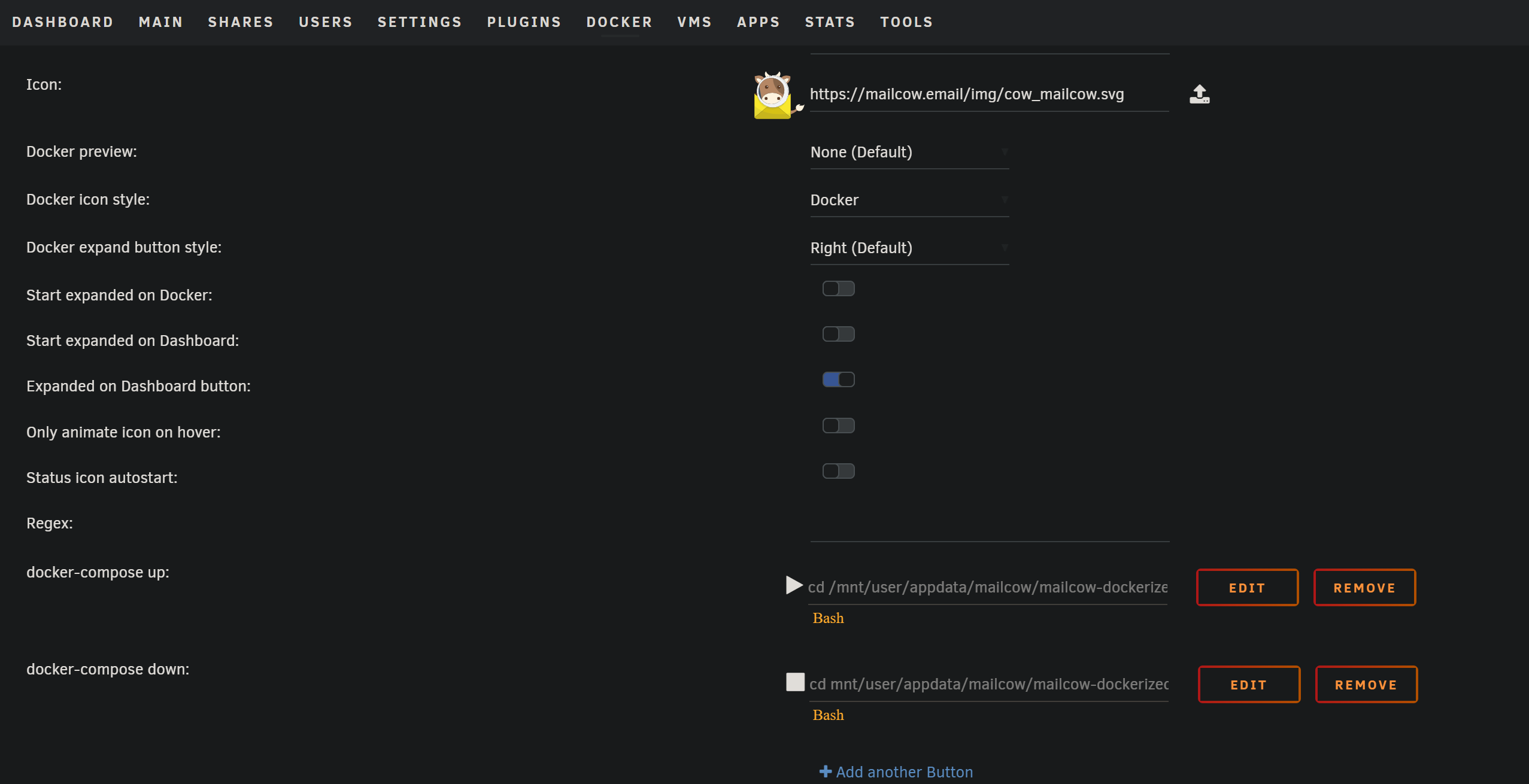

Thanks for the plugin. I even started a thread requesting this as a feature.. and another user pointed me here. Does everything i wanted! Thanks!
Question.
I installed the mailcow compose, created a folder for them, clicked on the label I want to bring out the docker-compose-up-d buttons and docker compose down.
I do it this way:
But the team doesn't work. Is there anything you can do to make it work?
cd /mnt/user/appdata/mailcow/mailcow-dockerized; docker-compose up -d;
cd /mnt/user/appdata/mailcow/mailcow-dockerized; docker-compose down;
Edited by muwahhid

@muwahhid just tried the bash action on the latest version and its not working, will fix this.

I'll wait for the bash to be fixed, a very necessary function for me.
