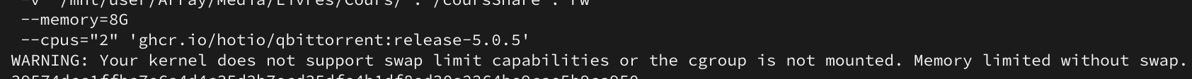

  5. And when i build the container i have this message if it's can help

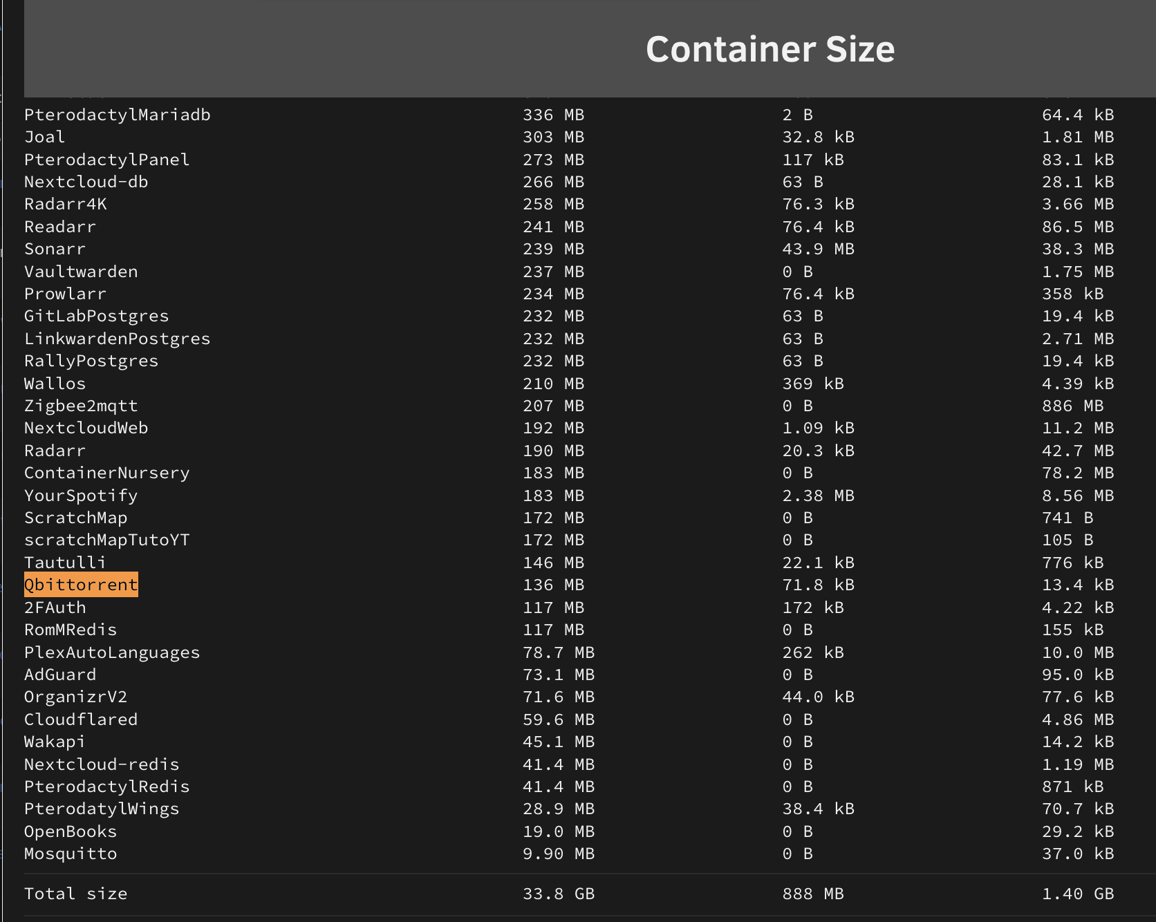

  6. After few tests the crash came from my Qbitorrent docker container i try to shutdown the container and after a week the server working well and 24h after re-start the container the docker service crash again... I don't understand why, i limit the ram and the cpu for the container but nothing change always crash... jamesserver-diagnostics-20250425-0941.zip

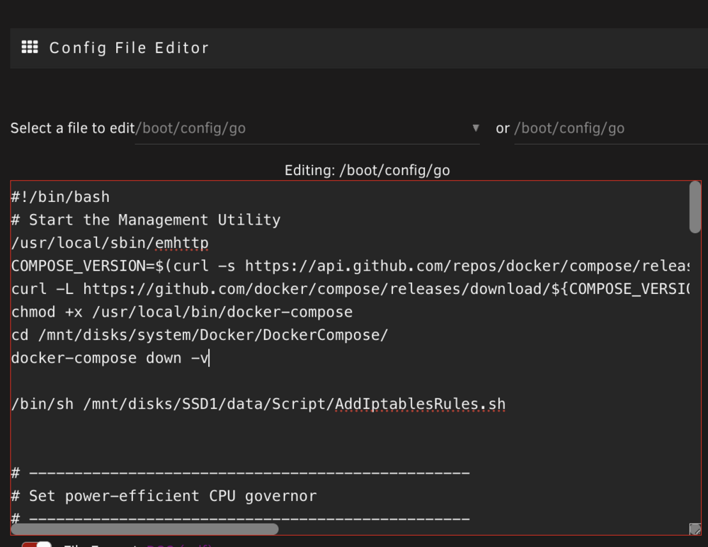

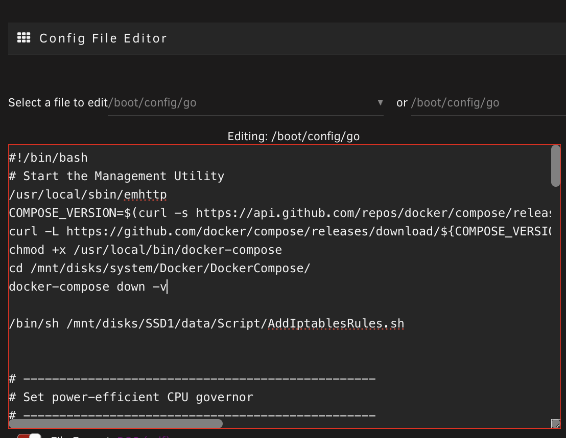

  7. It's work few days on yesterday the docker crash again... jamesserver-diagnostics-20250407-2217.zip jamesserver-syslog-20250407-2017.zip
  8. My bad i think it's here
  9. I put it here ?
  10. I'll try it out, thanks
