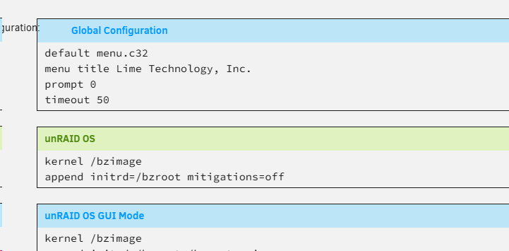

On that screen, but not where the cursor appears to be in that screenshot. Go to the top under menu default and add to the append line
Select menu view, top right, then add it to the green option, after /bzroot, like the mitigations option here.
