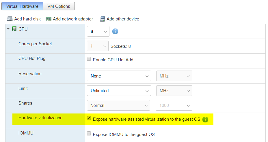

So...I have Unraid running under ESXi 7.0 as well, but can't do PCI passthrough and also have Hardware Virtualization enabled so I can use VM Manager. If I try and enable it I get an error - "Failed - PCI passthrough devices cannot be added when Nested Hardware-Assisted Virtualization is enabled." Is there a hack to get this to work? Or has it always been the case that you can only choose one of the other?
