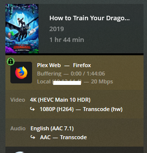

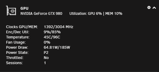

This is perfectly fine, have you also tried to transcode another file? I think the GTX 980? Eventualy a file that has not the profile high 10?
What seems off to you from the output?
Ok I figured it out for some reason my gtx 980 can't handle mp4 files properly but mkv files work just fine. Would this be the same if I had a P2000? You've been a great help and maybe this info will help someone else if they are having a similar issue.

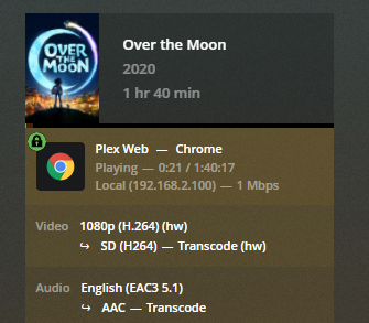

after a fresh reboot transcoding 4K HDR:

and then after following a sleep (via unraid web GUI) and WOL command. Same file, same transcoding preferences:

verified by a 46% CPU load on the system and no 'hw' tag on the Plex dashboard.

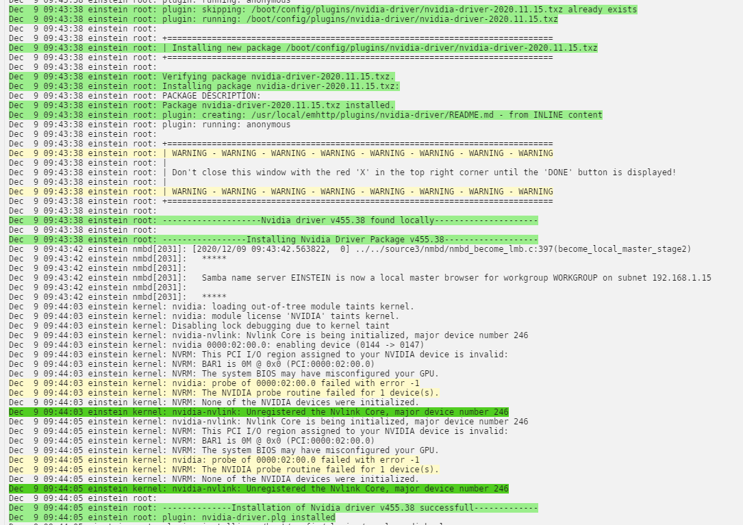

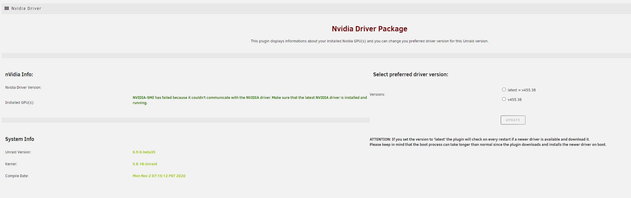

Thank you for this plugin. I followed the instructions but unraid isn't recognizing my quadro p2200. How can I troubleshoot further? Attached is the diagnostic zip as well. Thank you again for any help!
It's showing up on my system devices and isn't bounded to VFIO
Here's what I see from the plugin page
Here's what I see from the unraid logs
nvidia-smi output

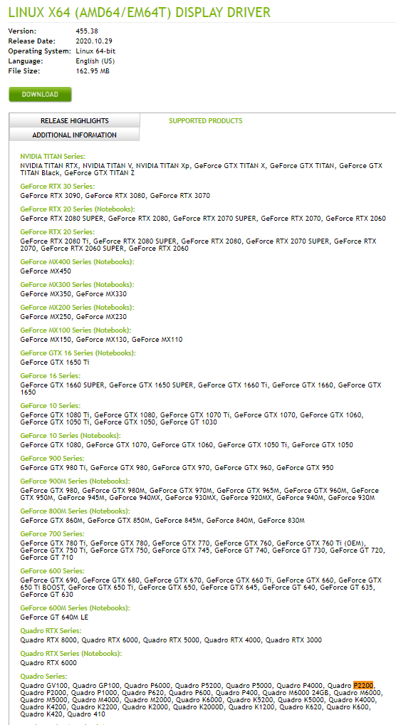

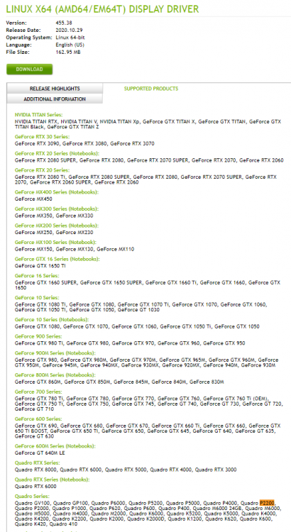

I've also confirmed that the Quadro P2200 is supported by the 455.38

Thank you for the report, can you tell me a little bit more about your system do you use secure boot?
Also the log says there could be anything misconfigured in the BIOS that taints the Kernel.
I've also looked up your board Gigabyte 7TESM and it's based on the Intel 5520 Chipset, is the BIOS on the latest version?
Can you try to enable above 4G decoding?
Is this the first time you try to use this combination of hardware/graphics card to use in docker containers?

I think it has something to do with the BIOS and that it doesn't allocate the resources right. Please be sure to write down the settings that you have now in the BIOS if you are not too familar with it.
Also please look out for the option above 4G decoding.

12 minutes ago, badatusernames said:
First off, just the information I'm getting on my GPU seems off.  When I watch smi for some reason has my GPU-Util at `N/A`.  And then my GPU stats has N/A for a lot of sections.
You are using a pretty old GPU, even on my card (GTX1050Ti) I can't see how much power it draws because it lists it as N/A, some features are simply NotAvailable for some cards.
But when I go to transcode a movie, the smi still has `No running processes found` even though Plex says it should be using it.
Your screenshot, which shows the transcoding, tells you that you are encoding with hardware acceleration, have you eventually also a Intel iGPU that is capable of encoding and you also handed it over to Plex?
Btw: you are decoding the stream in software but that's because your card isn't capable of decoding HEVC 10.
That would make replying to your inbox message difficult too!
Yea, I just upgraded my desktop GPU after ~6 years of using that one. Makes sense that it's old.
Well that might be my problem.  I just assumed you could just pop a GPU in and let it help out the whole machine.  I do not have an Intel iGPU.  Actually using an AMD Ryzen 3.
Just for more information, is there somewhere I could see what it is capable of, or what cards are capable of doing it?
