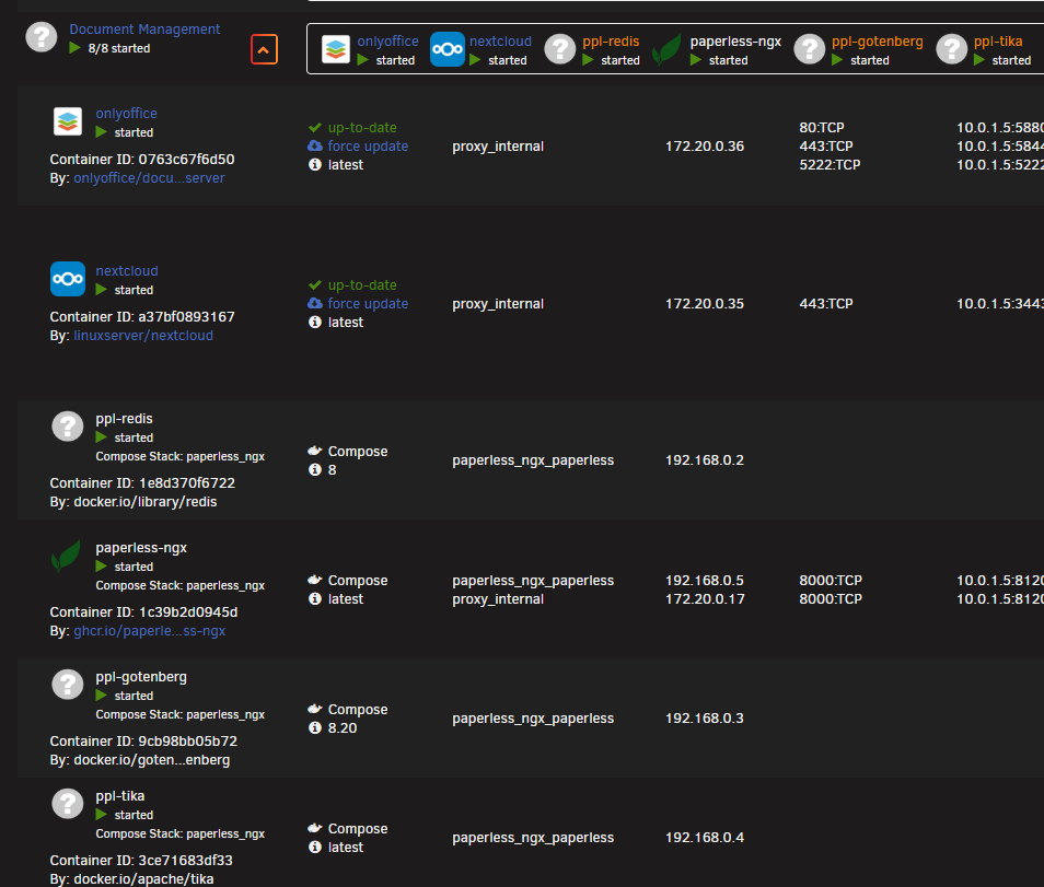

  2. No for compose containers you would usually update them by running "update stack" on the compose manager site. I don't think you can apply an update to compose containers from the normal view. Also in the folded out view it does not show the "apply update" for compose containers - as you see here: All the paperless containers are compose containers, and for some reason, it is showing updates available for 3 of them, when in reality there are none. Just looking at the screenshot now, I noticed that the ones that are indicating an update are from dockerhub, whereas paperless-ngx is from ghcr.io. Might have something to do with that....
  3. Well if it would work correctly, I would love to have orange text on update for compose containers. If it's broken (and can't be fixed), I would much rather have the compose containers excluded from the orange highlighting alltogether.
  4. The issue with compose is not necessarily solved by hiding the update column. Compose containers often times get highlighted in orange, to indicate an update, when there really is none. Of course, you can disable the highlighting in the folder settings, but then you break the update highlighting of normal docker containers in the same folder.
