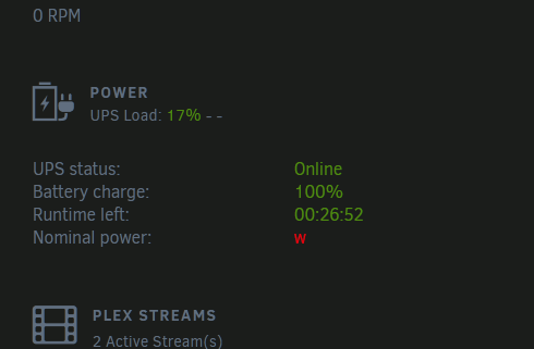

  18. Hello i'm experiencing a strange issue it started after upgrading UNRAID to 6.11.0, after a while in the Dashboard Memory usage show 0%, after a reboot %MEM usage show good values and then fall to 0% after few days... Wrong %MEM values showed in Dashboard but everything is running fine (dockers, etc). Can somebody know what to do to fix that ? Here are the screen of the dashboard and from htop:
