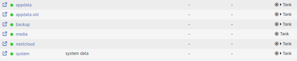

  2. Thanks for your answer. It appears that I have disk stats: And shares are working: What is missing is then mount dependant functions: pool usage pool information and operations (scrub, etc...) ... It was working with this configuration right after I set up the subpool with cli, and until rebooting . The culprit is at mounting during emhttp startup. I will live with that.

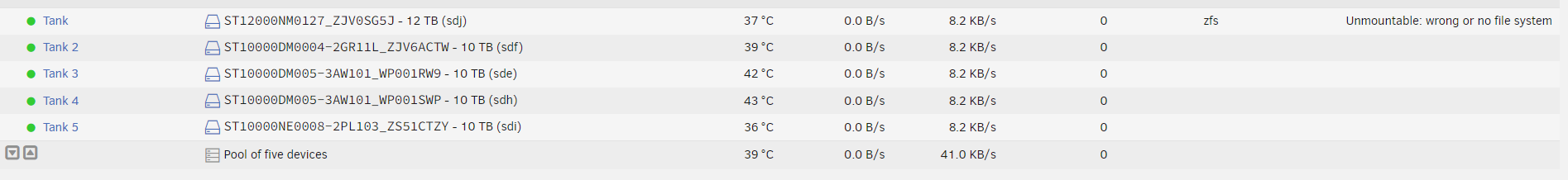

  3. Hi, I have this specific configuration: (buffer will sool retire, that's a temporary storage and a test pool, hence the indirect-2 thing). As you can see, logs, cache, and special are from partition from 2 SSD's. This seems not supported by the gui and wont mount Issue is partly solved if I manuallyI import the pool this way: /usr/sbin/zpool import -f -m -N -o autoexpand=on -d /dev/sdj1 -d /dev/sdf1 -d /dev/sde1 -d /dev/sdh1 -d /dev/sdi1 -d /dev/nvme0n1p1 -d /dev/nvme1n1p1 -d /dev/nvme0n1p2 -d /dev/nvme1n1p2 -d /dev/nvme0n1p3 -d /dev/nvme1n1p3 9470125657551839798 tank This command is from emhttp but with ssd partitions added. GUI still report unmountable, but ZFS master plugin show correctly the datasets mounted, and my containers/vm work. 2 questions please: Are logs and cache partitions necessary for importing? (I think so) Can I manually edit tank~{subpool}.cfg files so the pool mount automatically without error? Thank you, Reynald

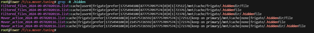

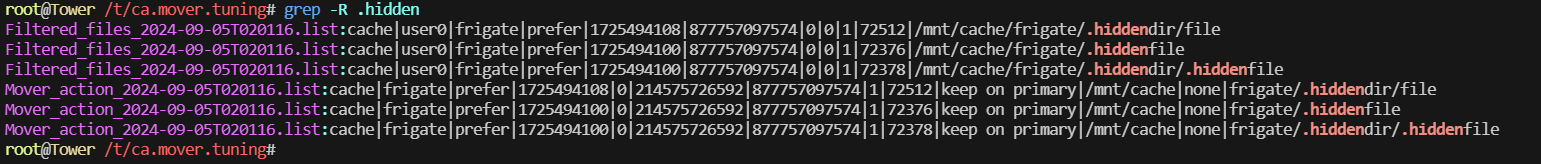

  14. 2024.09.05.0222 Fix find not finding hidden files Thanks to solidno8 from forums. (R3yn4ld)
