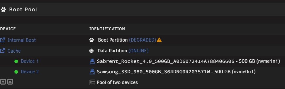

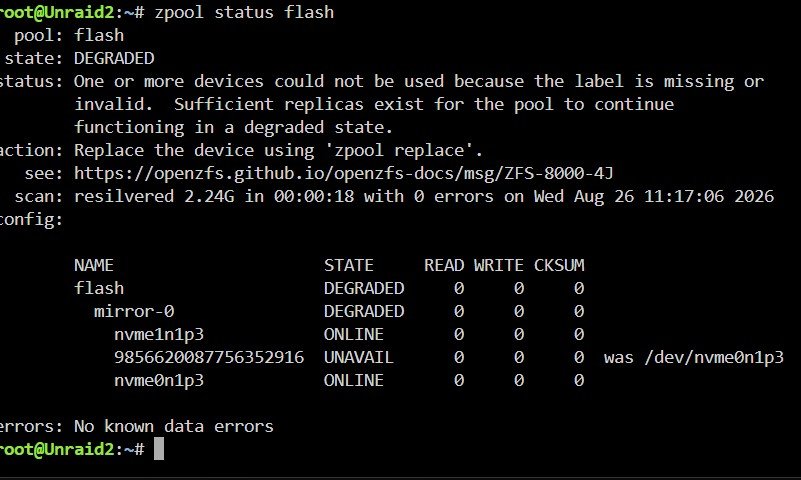

Internal flash degraded after drive failure
WOW thanks that did it after reboot have sent some beer money
As title suggest one of my nvme cache drives failed so i replaced but now when rebooting and putting online my internal flash boot is degraded, can anyone help please see screenshots. I believe this can be fixed with command line but even after AI still nothing.
