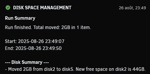

Thank's @strike that's exactly what I needed, when there's nothing to move, and when the plugin move files 👍 I have just noticed that the free space for a disk after a move in the notification (both mail and unraid notification) is 0.00 (according to my choice, it should be around 50GB) Is it normal ?

I agree. Personally, I also prefer option 1. I think the duplicate and improper formatting part in the message isn't too annoying for me.

Yes you're right, a summary for notification and more details for other agents. It would be great if you could do that. Thank you for considering my request :-)

This plugin is usefull for me. Thank's for sharing it. I'm using notifications. Two notifications are sent , one for the start of the script, and one for the end of the script. But no summary. Woul'd it be possible to send only one notification, at the end of the script, with informations about the job (start time end time), the log content for the move, or a summary of what the script did ? Thank's
