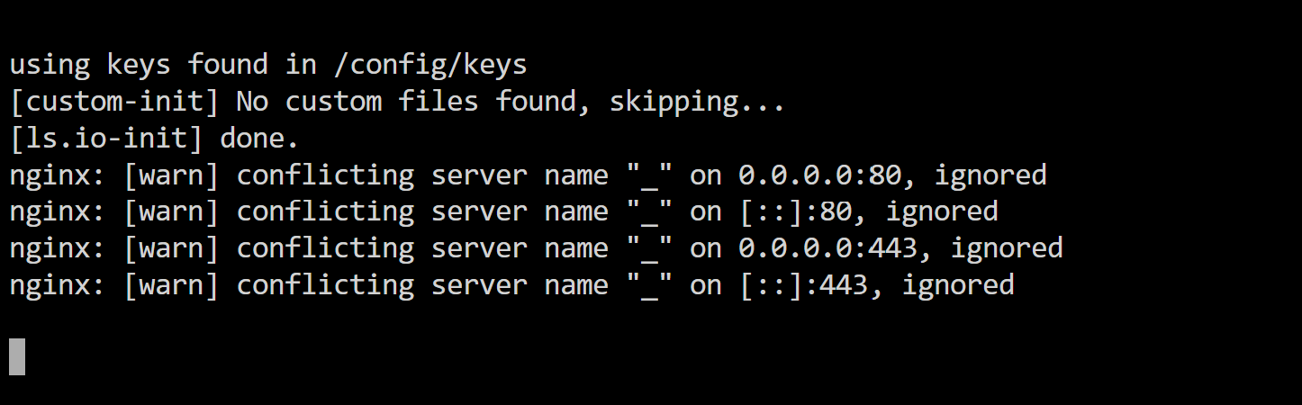

Just want to drop this here for anyone upgrading from older versions to the latest 28 version.
I was getting setting.js errors in the console when trying to download multiple files complaining about multiple versions being added.
I needed to update the built in nginx appdata\nextcloud\nginx\site-confs\default.conf file to match their sample file. I updated all the location entries to match the sample.

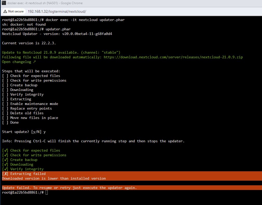

It seems that I've fouled up my Nextcloud install when updated the container from LinuxServer. I had not used NextCloud for a long time so it was very out of date. I've tried following a number of suggestions from various forums, but I think I should just uninstall and re-install NextCloud and MariaDB. to get a fresh start. What is the proper way to do this?  Thank you for your help.
Link to comment
What exactly are the errors that you are getting? For me, the update to version 28 seems to have messed something up (check earlier post).
If you are REALLY out of date, you could roll back a few versions, and see if an incremental update will fix things. This did it for me in the past.
(you can check older versions here: https://github.com/linuxserver/docker-nextcloud/releases )

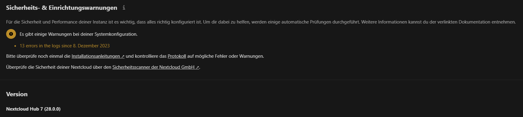

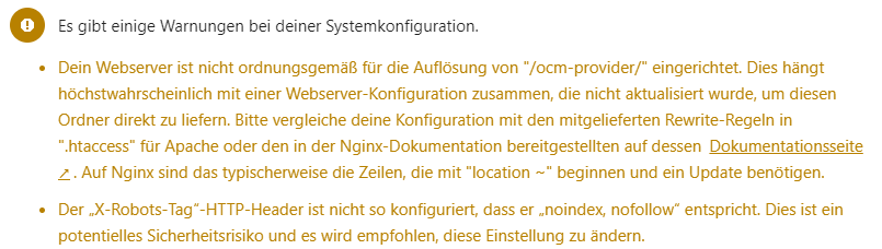

I am having similar issues that several other users have raised. However I have not seen any resolution yet. Are there any suggestions?
Security & setup warnings
It's important for the security and performance of your instance that everything is configured correctly. To help you with that we are doing some automatic checks. Please see the linked documentation for more information.
There are some warnings regarding your setup.
189 errors in the logs since December 19, 2023
Please double check the installation guides ↗, and check for any errors or warnings in the log.
Check the security of your Nextcloud over our security scan ↗.
Version
Nextcloud Hub 7 (28.0.1)
Latest log:
Brought to you by linuxserver.io
To support LSIO projects visit:
https://www.linuxserver.io/donate/
GID/UID
User UID:    99
User GID:    100
using keys found in /config/keys
Initializing nextcloud 28.0.1.1 (this can take a while) ...
Upgrading nextcloud from 28.0.0.11 ...
Setting permissions
Setting log level to debug
Turned on maintenance mode
Updating database schema
Updated database
Updating <settings> ...
Updated <settings> to 1.10.1
Starting code integrity check...
Finished code integrity check
Update successful
Turned off maintenance mode
Resetting log level
Initializing finished
**** The following active confs have different version dates than the samples that are shipped. ****
**** This may be due to user customization or an update to the samples. ****
**** You should compare the following files to the samples in the same folder and update them. ****
**** Use the link at the top of the file to view the changelog. ****
│  old date  │  new date  │ path                                                                   │
│ 2023-06-24 │ 2023-08-13 │ /config/nginx/ssl.conf                                                 │
│ 2023-06-23 │ 2023-12-22 │ /config/nginx/site-confs/default.conf                                  │
[custom-init] No custom files found, skipping...
[ls.io-init] done.
Am I missing something?
Thanks.
Lev

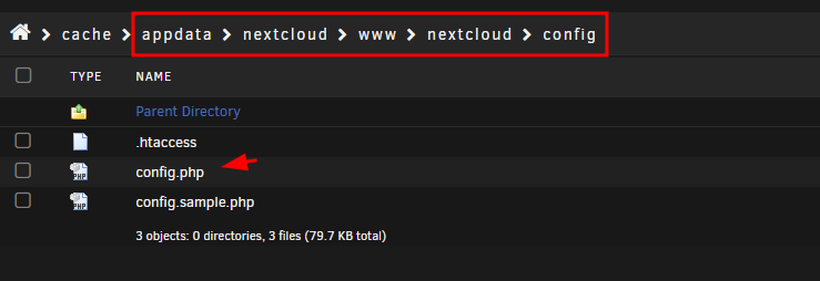

Just wanted to post the steps I followed to get nextcloud, SWAG, and postgresql15 all working.
Installed this nextcloud docker with default settings and ran web setup one time.
Got into postgresql15 console
psql -U postgres -W
CREATE USER nextcloud WITH PASSWORD 'nextpass';
CREATE DATABASE nextclouddb TEMPLATE template0 ENCODING 'UNICODE';
ALTER DATABASE nextclouddb OWNER TO nextcloud;
GRANT ALL PRIVILEGES ON DATABASE nextclouddb TO nextcloud;
Then went back to swag subdomain config file, where it suggested I add in some info to
/mnt/user/appdata/nextcloud/www/nextcloud/config/config.php
<?php
$CONFIG = array (
  'datadirectory' => '/data',
  'instanceid' => 'oc0w4lt90dch',
  'passwordsalt' => 'xxxxxxxxxxxxxx',
  'secret' => 'xxxxxxxxxxxxxxx',
  'trusted_domains' =>
  array (
    0 => '192.168.11.54:444',
    1 => 'nextcloud.mydomain.com',
  'dbtype' => 'pgsql',
  'version' => '28.0.1.1',
  'overwrite.cli.url' => 'https://nextcloud.mydomain.com/',
  'dbname' => 'nextclouddb',
  'dbhost' => '192.168.11.54:5432',
  'dbport' => '',
  'dbtableprefix' => 'oc_',
  'dbuser' => 'nextcloud',
  'dbpassword' => 'nextpass',
  'installed' => true,
  'trusted_proxies' =>
  array (
    0 => 'swag',
  'overwritehost' => 'nextcloud.mydomain.com',
  'overwriteprotocol' => 'https',
  'memcache.local' => '\\OC\\Memcache\\APCu',
  'filelocking.enabled' => true,
  'memcache.locking' => '\\OC\\Memcache\\APCu',
  'upgrade.disable-web' => true,
added the subdomain to my CNAME in DNS hosting, added the "nextcloud" to the SWAG config, restarted, bob's your uncle.
Once I logged into the admin panel > Overview, there are many things to fix in there, I'll start adjusting those settings like the suggestion next.

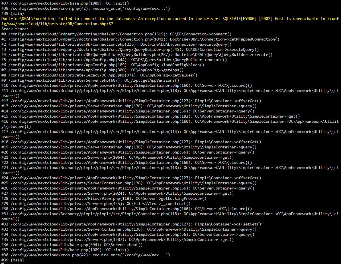

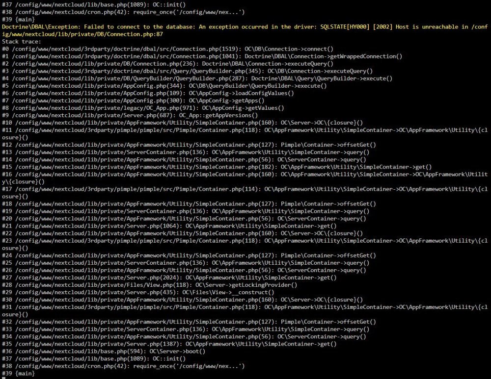

I have migrated to another unraid server. Everything seems fine said for my Nextcloud.
I upgraded to latest version before using the Restore/Backup appdata tool.
MariaDB is online and I can connect to my nextclouddb via adminer
I can login to the nextcloud instance but I get an internal error at the dashboard. I have tried to manually put the files and contacts url as well making sure it is not only the dashboard.
The nginx appdat/log files are full "permission errors". So I looked at the permissions on the old working Nextcloud vs the new I see no difference. Attached is the log file in question. Not sure if there are different step for nextcloud miration.
I migrated
mariahdb
bitwarden
nginx proxymanager
unifi-controller
All of these are working just fine?
NGerror2.log

After research I can adjust this config/config.php which I can't find. Neither in the appdata nor in the nc data directory nor on the Unraid file system /var/www/ or /usr/local/www.
Source: https://docs.nextcloud.com/server/20/admin_manual/configuration_server/language_configuration.html
Where can I find this confg file or do the time zone adjustments have to be made somewhere else?
I currently have a mixture of two time zones in my calendar, which is not very clear.
Thanks for your help
Link to comment
on the lsio Docker its located at ... (so may look again ;) a little closer ...)
  • Thanks 1
