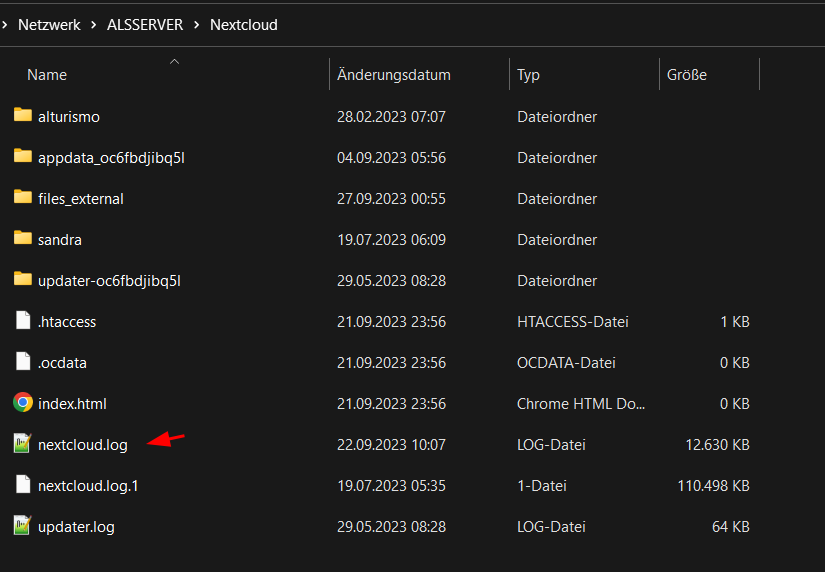

Since the last view updates (I don't know, maybe 3 or 4 docker container updates ago) the nextcloud container keeps on spnning my parity drive and the drive on which the nextcloud share is located up.
Does somebody else see this behaviour?
As mentioned, couple of version ago it was working fine. Yes, the drives had to been spun up, each time I enter the webinterface of nextcloud by still the drives were able to spin down.
The share for nextcloud is setup as Cache -> Array.
Link to comment
actually this behaviour was always like this ... depending on usage and installed plugins ...
just look whats on your NC data Share and it should be clear ... simple sample ...
then you must have been very lucky or you never had any activity in NC at all (which is uncommon) like sync clients etc ...
also a reason why NC data Share shouldnt be running on a array Share when you like your disks in spindown ... recommended is a SSD Share (cache drive) and Backups ...
Link to comment
