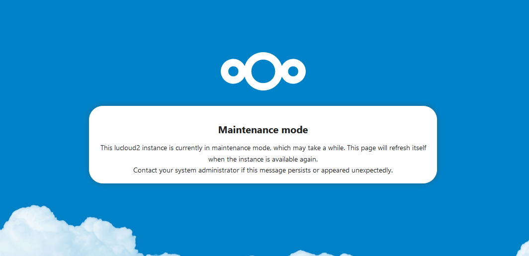

Hi there,
I recently updated the Nextcloud docker as well as restartet the whole server; I am not sure which exactly lead to my issue, I only noticed it after both.
My Nextcloud is in maintenance and won't come out of it. I didn't set it manually. I waited around 48h, no avail.
I tried googling for a solution and while I found people with the same issues, I somehow found no solution.
I attached the log of the Docker, anyone has an idea?
Best Regards
nextcloudLog.txt
Link to comment
