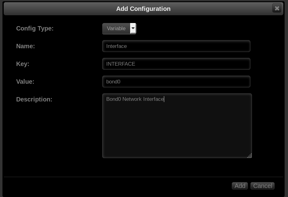

  6. LOL . Thanks. As per the instructions it reads that the KEY should be bond0. That's how it's read imo. It's a little confusing. But all good. I finally got it to work.
  7. One would think so but this is the only way it works. I tried the method that was described here and it doesn't work. If in deed my setup is wrong then I would not be able to view the webgui, login to the web admin or successfully connect from any device. This will lead me to the conclusion that there is something amiss with the docker.
  8. My OpenVPN-AS setup to use Bond0: 1. Config Type: Variable 2. Name: Interface (I think you can name it whatever you like) 3. Key: INTERFACE 4. Value: bond0
