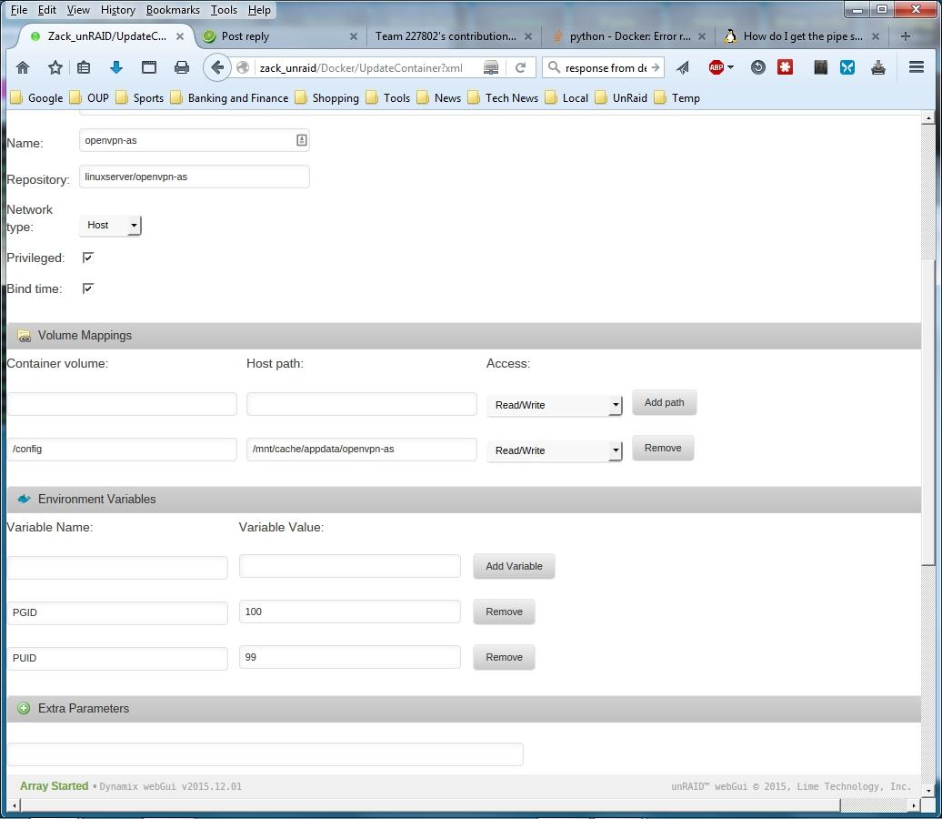

it must be run in both host and privileged modes.

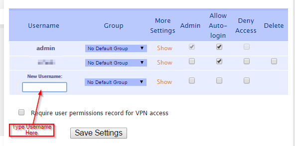

I'm sorry for asking such a blatant question, but how do I add user?
I know that I can add users in the "User Permissions" tab from the Web interface, but as far as I know these must some how correlate to the users in Unraid.
I appreciate the help.
Daniel
@schpongo, I am away from my machine right now so I am sorry for bad information. I believe you add users in the tab you mentioned. The trouble is you cannot set a password for those users. For now I believe you can only use the admin user really.
Daniel
Hi schpongo,
The users in OpenVPN-AS / Unraid do not correlate at all, they are separate. See the attached file, that will who you how to add users under the "User Permissions" Section.
Once you have saved the user, click "Show" and there you configure the password.

I am having two issues:
(1) When I configure the docker to use "host" (versus bridge) I cannot access the tool via the Web GUI. It works fine when using "bridge" but in reading the instructions, this is not correct. Screen shot attached.
(2) When trying to change the admin password via the instructions at the docker hub("docker exec -it openvpnas passwd admin ") I get "Error response from daemon: no such id: openvpnas
Any ideas would be most appreciated - Thanks!
Try
docker exec -it openvpn-as passwd admin
  obviously change passwd to whatever you want the password to be.

I seem to be having an issue with the installation of the OpenVPN-AS docker. After installing the docker App via CA Plugin I accessed the App GUI.
I have nothing downloading and plenty of b/w available to the app. 2.5MB/s to be exact. I logged on using the default user id and password and am stuck on the installation screen which says:
"Please click here to continue to download OpenVPN Connect. You will be automatically connected after the installation has finished."
It has been about 45 mins and I am still stuck on the installation web page (see screenshot).
I have tried reloading the URL and logging in again. Takes me straight back to the installation web page.
There is nothing in the log that I can see that is wrong so far. Here it is. Can anyone help?
