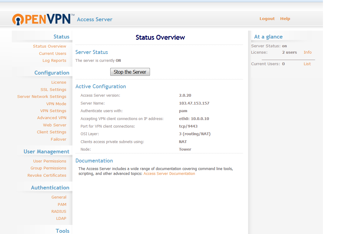

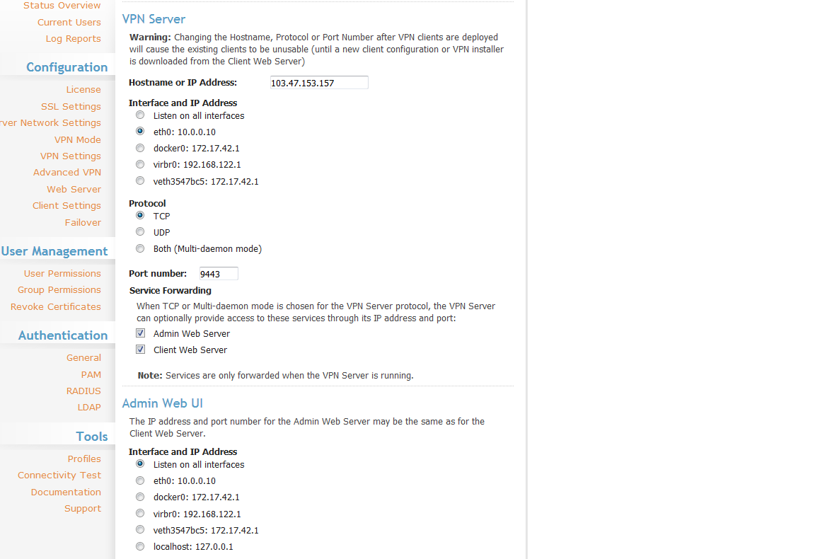

HKR, we're completely unable to help, without at least some more info, like screenshots etc.
I have attached 2 screenshots, please take a look.
Under server setting no matter what Interface i select i cannot connect to the server.
I'm going to assume you have tried connecting from outside your home network and have setup port forwarding on your router/firewall?
Once thing you could test is try connecting locally to the openvpn instance just as a proof of concept that the docker is running correctly.

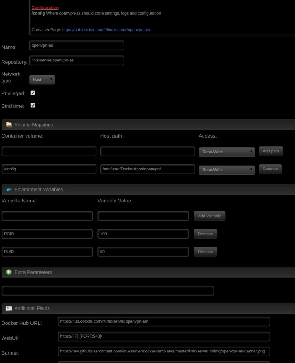

Just installed docker. Tried to launch webui received the error: connection refused. Docker setup is all defaults, as shown in screen shot.
http://hydra/mnt/user/DockerApps/openvpn//log/openvpn.log reports: ...
2016-01-14 21:10:29-0800 [-] Server agent initialization failed (6/6 attempts) because the following network resources are unavailable: set(['eth0'])
2016-01-14 21:10:29-0800 [-] Server Agent is inactive due to the following errors: {'errors': {'admin_ui.https.ip_address': [('error', "LOCAL_ADDR eth0 : bad local address name or interface is not up; must be 'all', 'localhost', a local IP address, or an interface name:
What do I need to change to fix this? Thank you for your help
###EDIT###  Resolved. See reply #45 for fix..
/closed ticket/
Instead of using /mnt/user/..... use /mnt/cache/.... or /mnt/disk1/.... (or whatever disk you're storing this on)
Some containers don't play well with user shares, but be sure to delete the container and the /mnt/user/... first.
I deleted my container in webUI; ssh and deleted the folder I was using on the user share. Made a new Docker Container, pointed /mnt/disk1/FOO per suggestion.
Same issue as before, error connection refused. Tried https://192.168.0.101:943/  (correct IP) and https://localhost:943/
Also have the same error in openvpn.log.
What else should I try? Thanks.

I'm a noob, but guessing from the ifconfig my docker needs to be pointed at br0 and not eth0 (default)? And if correct, I don't know how to go about doing that but I guess I can keep digging.
I suspect it's down to the fact you've got bonding enabled on your Unraid machine as that's the only difference I see between my setup and yours.
What's the output of ifconfig from a terminal?
I went into webUI - edit page for docker; added a variable INTERFACE with a value of bond0 -- I can now access port 943. So I think my issue is resolved, but before I get too comfortable I just want to ask is this fix kosher? Also before this, I didn't realize I could do this. I.e. is there a technical reason it's mapped to eth0, or it's just default (you have to start somewhere)?
Again, thank you for your assistance and time (not to mention patience to deal with this noob).
Looks good to me, most of us don't use bonding so eth0 would be a logical place to map it to, given that as far as I know, it's a fairly standard description for an ethernet interface in Linux.  I can't see any reason why you can't use bond0 as that is what your Unraid box is using.

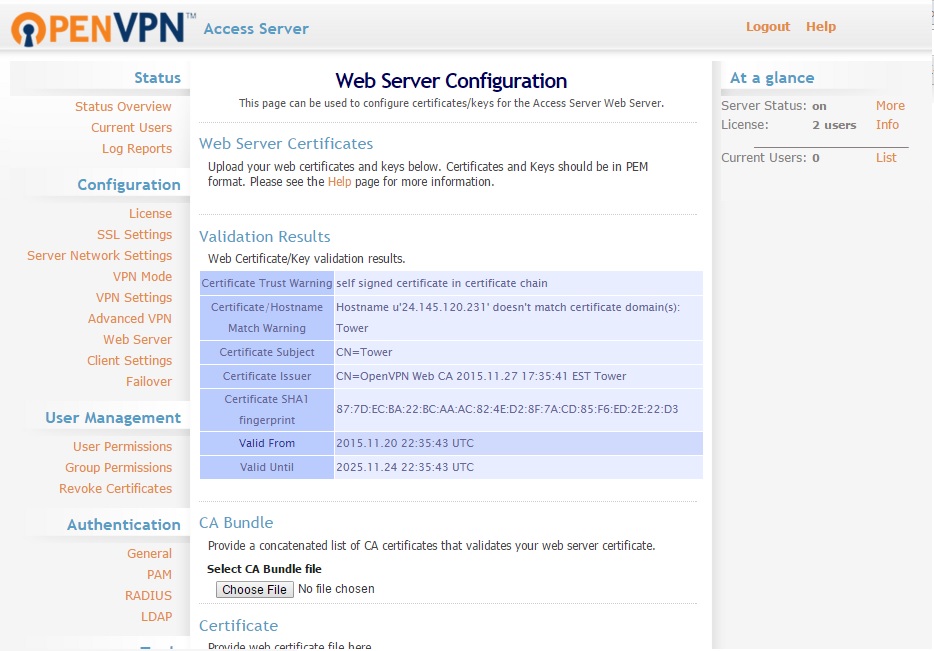

In order to use this docker, do I need to download openssl and go through all that to generate a certificate?  Isn't there a newb guide to this?  I have gone through all the openvpn docs and it all seems like so much just to get a simple tunnel going.
I have mine all set up finally and am able to connect locally, but can anyone direct me where to figure out how to get the certificates working right?  No matter where I try to connect from, or even the web client tells me the site is not signed and give me certificate errors.
You'll need to create your own certificates I would imagine.  I used StartSSL.  Guide here...  Can't help you anymore than that though as I don't use this container.  But unless you own a domain name and can validate it, then you will get a warning regarding unsigned certificates.
So basically, I can use the unsigned certificate then and it will still be secure?
