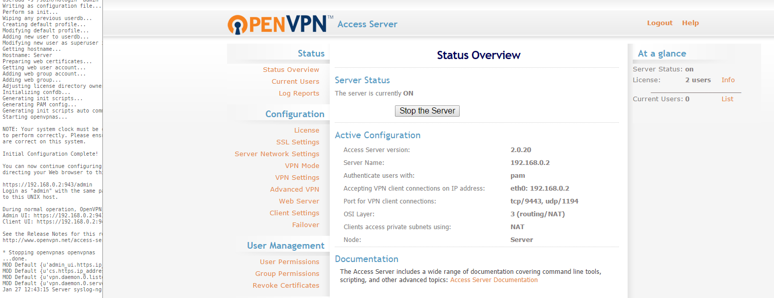

Just set this up here. Webui has booted up fine. Fresh install.
openvpn-as.txt
2016-01-27_12_48_14-OpenVPN_Access_Server_Status_Overview.png.bcd26066a0b9799e14b30643505805d2.png
