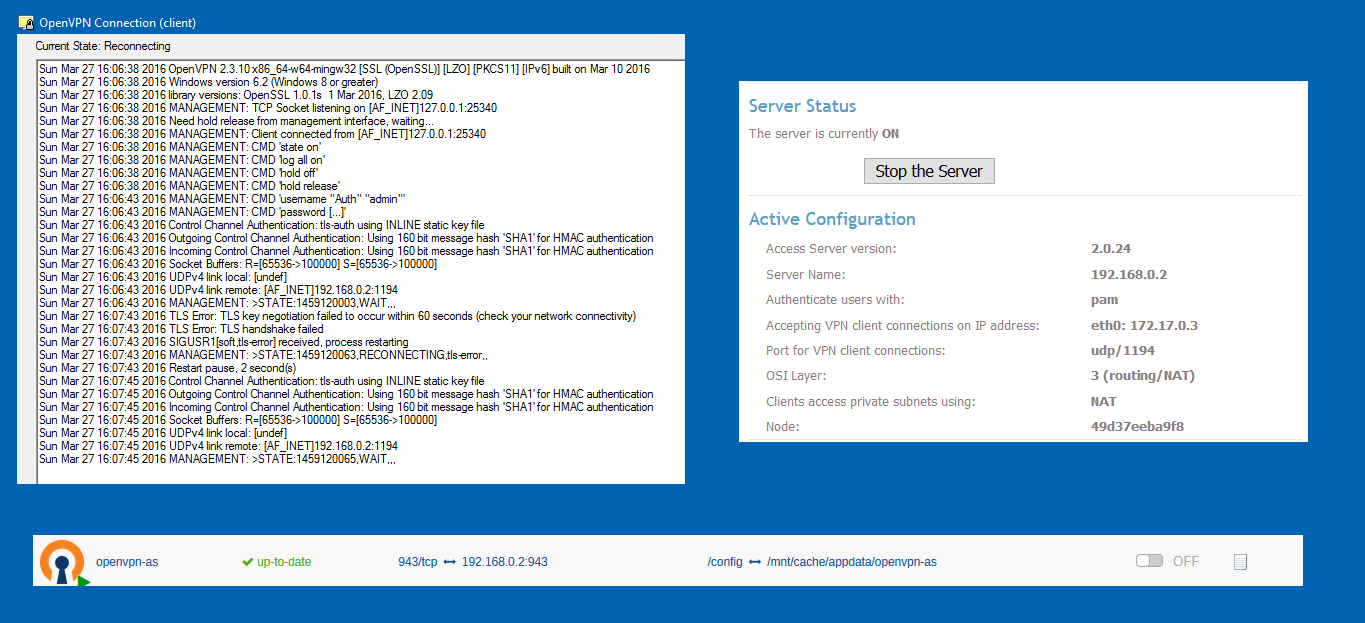

Should I be able to test OpenVPN internally from a machine on the network? (I have the AS Host Name set to UNRAID local IP)
I can't seem to get OpenVPN GUI on Windows to connect to the Server:
This Docker is set to Bridge with Privileged On, see attached screenshot for a few settings/error:

I think you should be able to do this.
Note that the Docker is set to run in Host mode. Please see this from the docker hub page linked to in the first post of this thread:
IMPORTANT, will not operate unless in host mode.
https://hub.docker.com/r/linuxserver/openvpn-as/
Now this is NOT strictly true. You CAN operate in Bridge mode AFTER you have setup the application in host mode OR if you have decided which ports the services are going to operate on. What I did was set OpenVPN-AS to run the VPN Server on port 1194 and the Admin / Connect services to run on 943 and tested it worked. Then I switched from Host to Bridge and mapped Container ports 1194 and 943 to the Host. Obviously IF I ever want to change these ports I won't be able to change the ports in the OpenVPN-AS Admin web gui (like I would be able to if I had this setup in Host mode) I will have to change the ports of the Bridge mode setup.
You might ask why I did this and it was because I have a bonded NIC setup and this setup wasn't playing well with this Docker in Host mode. In bridge mode it worked perfect.
Anyway, I digress. Setup the docker working in host mode and AFAIK you should be able to do what you are trying.

I think that might be my problem, I can't access the Web GUI at all in Host mode, so had to set to Bridge mode to access.
What do I need to do/change to setup in Bridge mode? I'm want to use UDP 1194.

That could be because you have some port conflicts but without more information I don't know. Anyway, if the goal is to get you running quickly the fact that your setup is like you explain, well, thats good, that means your setup is just like mine is on my Main Server. Setup like this and I promise it works great:
Admin and Connect URL (assuming your unRAID Server is called Tower OR has an IP of 192.168.1.2):
http://Tower:943 OR http://192.168.1.2:943
External Open VPN Port (assuming your domain name is www.example.com OR Dynamic DNS is my_sample_name.dyndns.org OR IP Address is 111.222.333.444 ):
example.com:1194 [uDP] OR my_sample_name.dyndns.org:1194 [uDP] OR 111.222.333.444:1194 [uDP]
And don't forget your router config:
Thanks for the guide/help danioj, all working perfect now!  8)

So I just installed this docker, and right now I'm having two issues:
1) I can't change my admin password, when I use the "docker exec -it openvpn-as xxxxxx admin" command, it returns "exec" "xxxxxx": executable file not found in $PATH"
2) I have my networking set up as a bond (bond0), how do I set my application to recognize this. Currently I can only access the webGUI if I set the Networking Type to Bridge (I want host, correct?)

I'm a noob, but guessing from the ifconfig my docker needs to be pointed at br0 and not eth0 (default)? And if correct, I don't know how to go about doing that but I guess I can keep digging.
I suspect it's down to the fact you've got bonding enabled on your Unraid machine as that's the only difference I see between my setup and yours.
I went into webUI - edit page for docker; added a variable INTERFACE with a value of bond0 -- I can now access port 943. So I think my issue is resolved, but before I get too comfortable I just want to ask is this fix kosher? Also before this, I didn't realize I could do this. I.e. is there a technical reason it's mapped to eth0, or it's just default (you have to start somewhere)?
Again, thank you for your assistance and time (not to mention patience to deal with this noob).

Thank you very much, that did the trick. Also the "advanced" option needs to be turned on in the upper right corner for any who find this in the future.

Anyone know how to get this docker to update the version of OpenVPN-AS?
I'm on 2.0.24 which is the original I got when i first downloaded the docker. I've edited and restarted the container several times (like plex and rutorrent) but it isn't grabbing the latest(2.0.26)
So I managed to make the password change without a problem, but then I made a few changes to my container settings and it updated the container. The admin password was then reset to the default and didn't remember the new password I had set
Is there a way to fix this? I don't want to have to change the admin password everytime the container receives an update
Also, @Nem ... did you ever figure this out? I had the same problem when I had jus tried to edit/restart the container to grab the most recent openvpn-as version
anyone?
My volume mapping is /config ==> /mnt/cache/appdata/vpn/ literally everything else in the docker setup is unchanged from default
