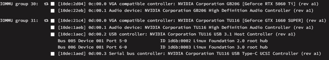

  1. Thanks, enabled Above 4G Decoding & Resizable BAR support and both cards are visible now. I haven't noticed these settings as being prerequisites in the first post, but I might have missed something.
  2. Hi Just upgraded my server to 7.2.4, I've got a GTX 1660 Super and an RTX 5060 TI, but the OpenSource driver (needed due to the 5XXX card) only detects the 5060. Just for checking, I've tried the production branch, and no GPU was detected. Attaching my diagnostics... small-diagnostics-20260228-2045.zip Thanks in advance

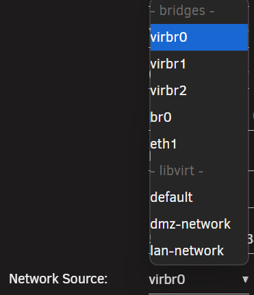

  9. So does it matter which one I choose when creating a new VM? Virbr1 is LAN-network, for instance
  10. Thanks @SimonF and @JorgeB , seems that 7.1.4 indeed fixed the issue. Only thing I've noticed which is a bit strange (don't remember how it was on 7.0.1) - when creating a new VM and trying to choose the custom network, I've too many options (If I recall correctly, on 7.0 brunch had only the bridges to choose from): Anyway, thanks for the fix
