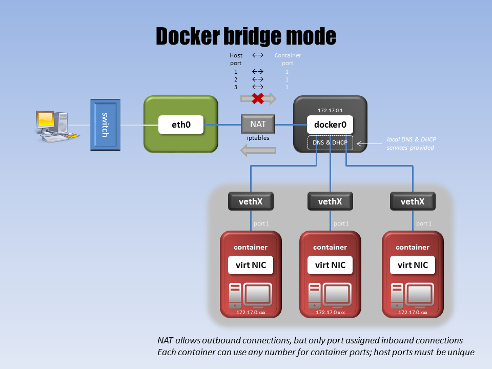

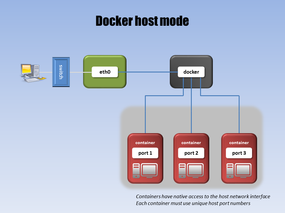

I've had this container set up and working for about a week now, but I have one question. Is there a downside to have it set up in bridge mode? I've seen several post about setting it up in host mode.. If I have it working in bridge mode why should I change to host?
I'd always run something in bridge mode as opposed to host mode personally.  But now I'm thinking about it, I'm not sure I can give you a good coherent answer as to why....  ???
Yeah, same here. I installed the container and got it working in bridge mode, but when I looked at the support thread I saw several post about it should be run in host mode. Even the usage instructions on github and docker hub says "--net=host IMPORTANT, will not operate unless in host mode." So now I'm wondering if I should change..(?) But I'm not sure why I need to if I have it working.. Hence my question if there is a downside to running in bridge mode with this container.(?) The only ports I mapped was 943 to get to the webui and 1194 to able to connect to the server.
I have created some drawings to clarify Docker host and bridge modes. Perhaps this helps?
Thanks bonienl.  That's pretty much what I'd got in my head but couldn't think of a good way to express it.  :-[
You know the saying about pictures... Saves you from writing a long story :D
Thanks bonienl, that helps a lot! :) It doesn't really answer why it says this container MUST be run in host mode to operate, as it clearly works in bridge mode too. But hey, if I don't NEED to change it for some reason I leave it in bridge mode.
