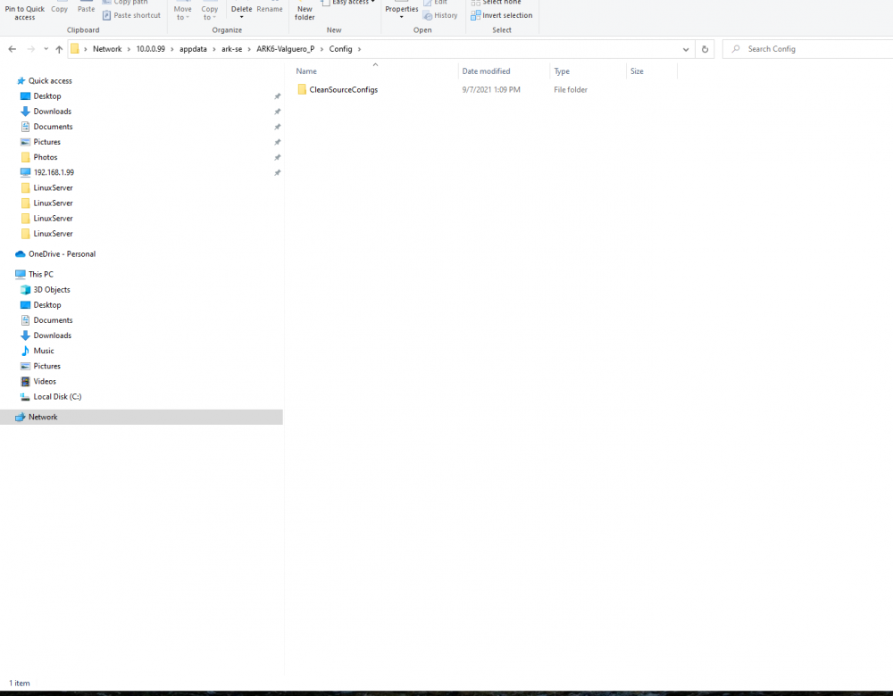

I destroyed the first one long time ago thinking it was an error on my part, but this is the second docker container producing the same results.
root@bd552e6a9928:/# cd /serverdata/serverfiles/ShooterGame/Saved/Config/LinuxServer bash: cd: /serverdata/serverfiles/ShooterGame/Saved/Config/LinuxServer: No such file or directory root@bd552e6a9928:/# This is the second attempt with a fresh docker and still get the same results
I tried dropping in the linux folder with settings and it still didn't work root@bd552e6a9928:/# ls bin boot dev etc home lib lib32 lib64 media mnt opt proc root run sbin serverdata srv sys tmp usr var root@bd552e6a9928:/# ls -al total 0 drwxr-xr-x 1 root root 182 Sep 10 18:04 . drwxr-xr-x 1 root root 182 Sep 10 18:04 .. drwxr-xr-x 1 root root 728 Sep 18 2020 bin drwxr-xr-x 1 root root 0 Jul 10 2020 boot drwxr-xr-x 5 root root 340 Sep 16 13:45 dev -rwxr-xr-x 1 root root 0 Sep 10 18:04 .dockerenv drwxr-xr-x 1 root root 1314 Sep 10 18:04 etc drwxr-xr-x 1 root root 0 Jul 10 2020 home drwxr-xr-x 1 root root 110 Sep 18 2020 lib drwxr-xr-x 1 root root 1250 Sep 18 2020 lib32 drwxr-xr-x 1 root root 40 Aug 3 2020 lib64 drwxr-xr-x 1 root root 0 Aug 3 2020 media drwxr-xr-x 1 root root 0 Aug 3 2020 mnt drwxr-xr-x 1 root root 14 Sep 18 2020 opt dr-xr-xr-x 886 root root 0 Sep 16 13:45 proc drwx------ 1 root root 30 Aug 3 2020 root drwxr-xr-x 1 root root 16 Aug 3 2020 run drwxr-xr-x 1 root root 1056 Sep 18 2020 sbin drwxrwx--- 1 steam users 60 Sep 10 18:05 serverdata drwxr-xr-x 1 root root 0 Aug 3 2020 srv dr-xr-xr-x 13 root root 0 Sep 16 13:45 sys drwxrwxrwt 1 root root 10 Sep 10 18:05 tmp drwxr-xr-x 1 root root 80 Sep 18 2020 usr drwxr-xr-x 1 root root 90 Aug 3 2020 var root@bd552e6a9928:/# cd serverdata root@bd552e6a9928:/serverdata# ls serverfiles Steam steamcmd root@bd552e6a9928:/serverdata# cd serverfiles root@bd552e6a9928:/serverdata/serverfiles# ls ARK10-Genesis2 ARK1-TheIsland ARK3-Aberration ARK5-Ragnarok ARK7-CrystalIsles ARK9-Genesis dynamicconfig linux64 ShooterGame steamclient.so version.txt ARK11-Lost_Island ARK2-ScorchedEarth_P ARK4-TheCenter ARK6-Valguero_P ARK8-Extinction clusterfiles Engine PackageInfo.bin steamapps SteamCMDInstall.sh root@bd552e6a9928:/serverdata/serverfiles# ls -al total 35800 drwxrwx--- 19 steam users 4096 Sep 15 11:28 . drwxrwx--- 1 steam users 60 Sep 10 18:05 .. drwxrwx--- 6 steam users 66 Sep 8 15:25 ARK10-Genesis2 drwxrwx--- 5 steam users 49 Aug 21 02:29 ARK11-Lost_Island drwxrwx--- 5 steam users 49 Aug 18 21:18 ARK1-TheIsland drwxrwx--- 6 steam users 66 Sep 13 23:29 ARK2-ScorchedEarth_P drwxrwx--- 6 steam users 66 Sep 8 23:29 ARK3-Aberration drwxrwx--- 5 steam users 49 Aug 18 22:35 ARK4-TheCenter drwxrwx--- 6 steam users 66 Aug 28 21:39 ARK5-Ragnarok drwxrwx--- 5 steam users 49 Sep 10 18:08 ARK6-Valguero_P drwxrwx--- 6 steam users 66 Sep 9 12:25 ARK7-CrystalIsles drwxrwx--- 6 steam users 66 Sep 13 10:36 ARK8-Extinction drwxrwx--- 6 steam users 66 Sep 8 14:16 ARK9-Genesis drwxrwx--- 3 steam users 22 Aug 23 17:46 clusterfiles drwxrwx--- 2 steam users 114 Aug 21 02:31 dynamicconfig drwxrwx--- 7 steam users 80 Aug 18 21:16 Engine drwxrwx--- 2 steam users 28 Sep 15 02:47 linux64 -rwxrwx--- 1 steam users 5208045 Sep 15 11:27 PackageInfo.bin drwxrwx--- 6 steam users 117 Sep 10 23:50 ShooterGame drwxrwx--- 5 steam users 86 Sep 15 11:28 steamapps -rwxrwx--- 1 steam users 31433351 Sep 15 02:46 steamclient.so -rwxrwx--- 1 steam users 272 Sep 10 20:07 SteamCMDInstall.sh -rwxrwx--- 1 steam users 9 Sep 15 11:27 version.txt root@bd552e6a9928:/serverdata/serverfiles# cd ShooterGame root@bd552e6a9928:/serverdata/serverfiles/ShooterGame# ls -al total 16 drwxrwx--- 6 steam users 117 Sep 10 23:50 . drwxrwx--- 19 steam users 4096 Sep 15 11:28 .. -rwxrwx--- 1 steam users 4 Sep 10 23:38 AssetRegistry.bin drwxrwx--- 4 steam users 32 Aug 18 21:16 Binaries drwxrwx--- 5 steam users 252 Sep 10 23:50 Config drwxrwx--- 31 steam users 4096 Sep 15 11:28 Content drwxrwx--- 5 steam users 49 Sep 10 18:08 Saved -rwxrwx--- 1 steam users 709 Sep 10 20:08 ShooterGame.uproject root@bd552e6a9928:/serverdata/serverfiles/ShooterGame# cd Config root@bd552e6a9928:/serverdata/serverfiles/ShooterGame/Config# ls -al total 300 drwxrwx--- 5 steam users 252 Sep 10 23:50 . drwxrwx--- 6 steam users 117 Sep 10 23:50 .. -rwxrwx--- 1 steam users 633 Sep 10 19:55 DefaultDeviceProfiles.ini -rwxrwx--- 1 steam users 1247 Sep 10 23:37 DefaultEditor.ini -rwxrwx--- 1 steam users 841 Sep 10 23:37 DefaultEditorUserSettings.ini -rwxrwx--- 1 steam users 195354 Sep 10 23:37 DefaultEngine.ini -rwxrwx--- 1 steam users 68841 Sep 10 19:55 DefaultGame.ini -rwxrwx--- 1 steam users 947 Sep 10 23:37 DefaultGameUserSettings.ini -rwxrwx--- 1 steam users 22908 Sep 10 23:37 DefaultInput.ini drwxrwx--- 2 steam users 27 Sep 10 23:50 Linux drwxrwx--- 2 steam users 100 Sep 10 23:50 Localization drwxrwx--- 3 steam users 18 Aug 18 21:16 OSS root@bd552e6a9928:/serverdata/serverfiles/ShooterGame/Config# cd .. root@bd552e6a9928:/serverdata/serverfiles/ShooterGame# cd / root@bd552e6a9928:/# ls bin boot dev etc home lib lib32 lib64 media mnt opt proc root run sbin serverdata srv sys tmp usr var root@bd552e6a9928:/# ls a- ls: cannot access 'a-': No such file or directory root@bd552e6a9928:/# ps axfww PID TTY STAT TIME COMMAND 87 pts/0 Ss 0:00 bash 104 pts/0 R+ 0:00 \_ ps axfww 1 ? Ss 0:00 /bin/bash /opt/scripts/start.sh 11 ? S 0:00 su steam -c /opt/scripts/start-server.sh 12 ? Ss 0:00 \_ /bin/bash /opt/scripts/start-server.sh 58 ? Sl 4:41 \_ ./ShooterGameServer Valguero_P?listen?SessionName=D1R7YS_Valguero?ServerPassword=XXXX?ServerAdminPassword=XXXXX.?Listen?Port=7787?QueryPort=27020?MaxPlayers=25?RCONEnabled=True?RCONPort=27030?customdynamicconfigurl="http://172.17.0.2/dynamicconfig.ini" -server -log -nowrite -clusterid=D1R7Y -ClusterDirOverride=/serverdata/serverfiles/clusterfiles -UseDynamicConfig -ForceRespawnDinos root@bd552e6a9928:/#

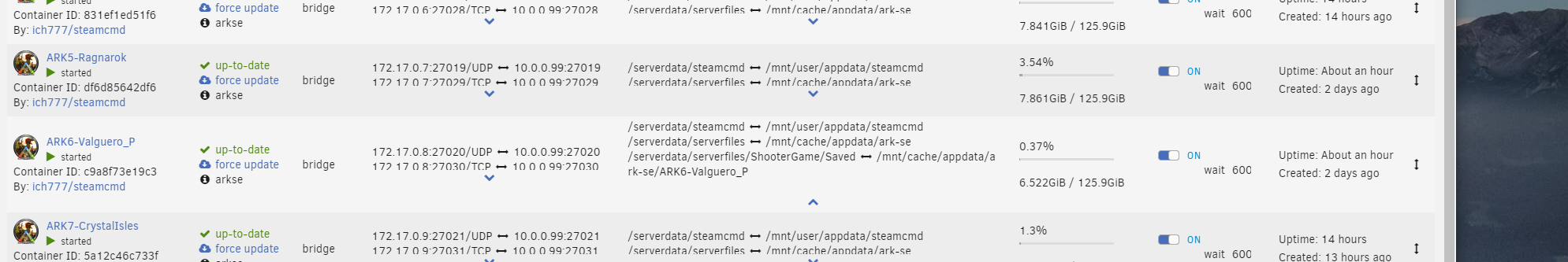

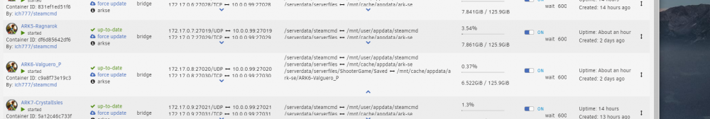

1. All my other containers are working properly. 2. The permissions match all of the other Ark Dockers and the folders match 3 Contents are the same except for the missing forlder /linuserver 4. .ark files are present 5. Server starts normally, and it even shows up in the cluster, I can transfer there and back but with no config settings, I can't install my mods and settings. 6. Logs shows the docker starts up normally. root@Tower:/mnt/cache/appdata/ark-se# clear root@Tower:/mnt/cache/appdata/ark-se# ls -al total 35800 drwxrwx--- 19 nobody users 4096 Sep 15 11:28 ./ drwxrwxrwx 12 nobody users 153 Aug 18 20:57 ../ drwxrwx--- 5 nobody users 49 Aug 18 21:18 ARK1-TheIsland/ drwxrwx--- 6 nobody users 66 Sep 8 15:25 ARK10-Genesis2/ drwxrwx--- 5 nobody users 49 Aug 21 02:29 ARK11-Lost_Island/ drwxrwx--- 6 nobody users 66 Sep 13 23:29 ARK2-ScorchedEarth_P/ drwxrwx--- 6 nobody users 66 Sep 8 23:29 ARK3-Aberration/ drwxrwx--- 5 nobody users 49 Aug 18 22:35 ARK4-TheCenter/ drwxrwx--- 6 nobody users 66 Aug 28 21:39 ARK5-Ragnarok/ drwxrwx--- 5 nobody users 49 Sep 10 18:08 ARK6-Valguero_P/ drwxrwx--- 6 nobody users 66 Sep 9 12:25 ARK7-CrystalIsles/ drwxrwx--- 6 nobody users 66 Sep 13 10:36 ARK8-Extinction/ drwxrwx--- 6 nobody users 66 Sep 8 14:16 ARK9-Genesis/ drwxrwx--- 7 nobody users 80 Aug 18 21:16 Engine/ -rwxrwx--- 1 nobody users 5208045 Sep 15 11:27 PackageInfo.bin* drwxrwx--- 6 nobody users 117 Sep 10 23:50 ShooterGame/ -rwxrwx--- 1 nobody users 272 Sep 10 20:07 SteamCMDInstall.sh* drwxrwx--- 3 nobody users 22 Aug 23 17:46 clusterfiles/ drwxrwx--- 2 nobody users 114 Aug 21 02:31 dynamicconfig/ drwxrwx--- 2 nobody users 28 Sep 15 02:47 linux64/ drwxrwx--- 5 nobody users 86 Sep 15 11:28 steamapps/ -rwxrwx--- 1 nobody users 31433351 Sep 15 02:46 steamclient.so* -rwxrwx--- 1 nobody users 9 Sep 15 11:27 version.txt* root@Tower:/mnt/cache/appdata/ark-se# cd ARK6-Valguero_P root@Tower:/mnt/cache/appdata/ark-se/ARK6-Valguero_P# ls -al total 8 drwxrwx--- 5 nobody users 49 Sep 10 18:08 ./ drwxrwx--- 19 nobody users 4096 Sep 15 11:28 ../ drwxrwx--- 3 nobody users 32 Sep 10 18:07 Config/ drwxrwx--- 2 nobody users 29 Sep 10 18:07 Logs/ drwxrwx--- 2 nobody users 4096 Sep 14 15:52 SavedArks/ root@Tower:/mnt/cache/appdata/ark-se/ARK6-Valguero_P# cd SavedArks root@Tower:/mnt/cache/appdata/ark-se/ARK6-Valguero_P/SavedArks# ls -al total 939492 drwxrwx--- 2 nobody users 4096 Sep 14 15:52 ./ drwxrwx--- 5 nobody users 49 Sep 10 18:08 ../ -rwxrwx--- 1 nobody users 2055 Sep 11 12:40 76561198038289467.arkprofile* -rwxrwx--- 1 nobody users 43918337 Sep 14 15:52 Valguero_P.ark* -rwxrwx--- 1 nobody users 43631870 Sep 12 19:14 Valguero_P_12.09.2021_22.14.02.ark* -rwxrwx--- 1 nobody users 43633182 Sep 12 21:24 Valguero_P_13.09.2021_00.24.02.ark* -rwxrwx--- 1 nobody users 43633182 Sep 12 23:34 Valguero_P_13.09.2021_02.34.02.ark* -rwxrwx--- 1 nobody users 43635900 Sep 13 01:44 Valguero_P_13.09.2021_04.44.02.ark* -rwxrwx--- 1 nobody users 43657801 Sep 13 09:02 Valguero_P_13.09.2021_12.02.27.ark* -rwxrwx--- 1 nobody users 43673960 Sep 13 11:12 Valguero_P_13.09.2021_14.12.27.ark* -rwxrwx--- 1 nobody users 43687464 Sep 13 13:22 Valguero_P_13.09.2021_16.22.27.ark* -rwxrwx--- 1 nobody users 43698185 Sep 13 15:32 Valguero_P_13.09.2021_18.32.27.ark* -rwxrwx--- 1 nobody users 43708960 Sep 13 17:42 Valguero_P_13.09.2021_20.42.27.ark* -rwxrwx--- 1 nobody users 43708960 Sep 13 19:52 Valguero_P_13.09.2021_22.52.27.ark* -rwxrwx--- 1 nobody users 43715560 Sep 13 22:02 Valguero_P_14.09.2021_01.02.27.ark* -rwxrwx--- 1 nobody users 43718299 Sep 14 00:12 Valguero_P_14.09.2021_03.12.27.ark* -rwxrwx--- 1 nobody users 43718299 Sep 14 02:22 Valguero_P_14.09.2021_05.22.27.ark* -rwxrwx--- 1 nobody users 43720840 Sep 14 04:32 Valguero_P_14.09.2021_07.32.27.ark* -rwxrwx--- 1 nobody users 43720840 Sep 14 06:42 Valguero_P_14.09.2021_09.42.27.ark* -rwxrwx--- 1 nobody users 43726243 Sep 14 08:52 Valguero_P_14.09.2021_11.52.27.ark* -rwxrwx--- 1 nobody users 43964557 Sep 14 11:02 Valguero_P_14.09.2021_14.02.27.ark* -rwxrwx--- 1 nobody users 43917052 Sep 14 13:12 Valguero_P_14.09.2021_16.12.27.ark* -rwxrwx--- 1 nobody users 43918338 Sep 14 15:22 Valguero_P_14.09.2021_18.22.27.ark* -rwxrwx--- 1 nobody users 43635900 Sep 13 06:52 Valguero_P_AntiCorruptionBackup.bak* -rwxrwx--- 1 nobody users 43635900 Sep 13 07:07 Valguero_P_NewLaunchBackup.bak* root@Tower:/mnt/cache/appdata/ark-se/ARK6-Valguero_P/SavedArks# cd .. root@Tower:/mnt/cache/appdata/ark-se/ARK6-Valguero_P# ls -al total 8 drwxrwx--- 5 nobody users 49 Sep 10 18:08 ./ drwxrwx--- 19 nobody users 4096 Sep 15 11:28 ../ drwxrwx--- 3 nobody users 32 Sep 10 18:07 Config/ drwxrwx--- 2 nobody users 29 Sep 10 18:07 Logs/ drwxrwx--- 2 nobody users 4096 Sep 14 15:52 SavedArks/ root@Tower:/mnt/cache/appdata/ark-se/ARK6-Valguero_P# cd Config root@Tower:/mnt/cache/appdata/ark-se/ARK6-Valguero_P/Config# ls -al total 0 drwxrwx--- 3 nobody users 32 Sep 10 18:07 ./ drwxrwx--- 5 nobody users 49 Sep 10 18:08 ../ drwxrwx--- 2 nobody users 23 Sep 10 18:07 CleanSourceConfigs/ root@Tower:/mnt/cache/appdata/ark-se/ARK6-Valguero_P/Config# cd .. root@Tower:/mnt/cache/appdata/ark-se/ARK6-Valguero_P#
Can you examine this docker problem where the Valguero config settings are not showing up in the appdata folders. my-ARK6-Valguero_P.xml

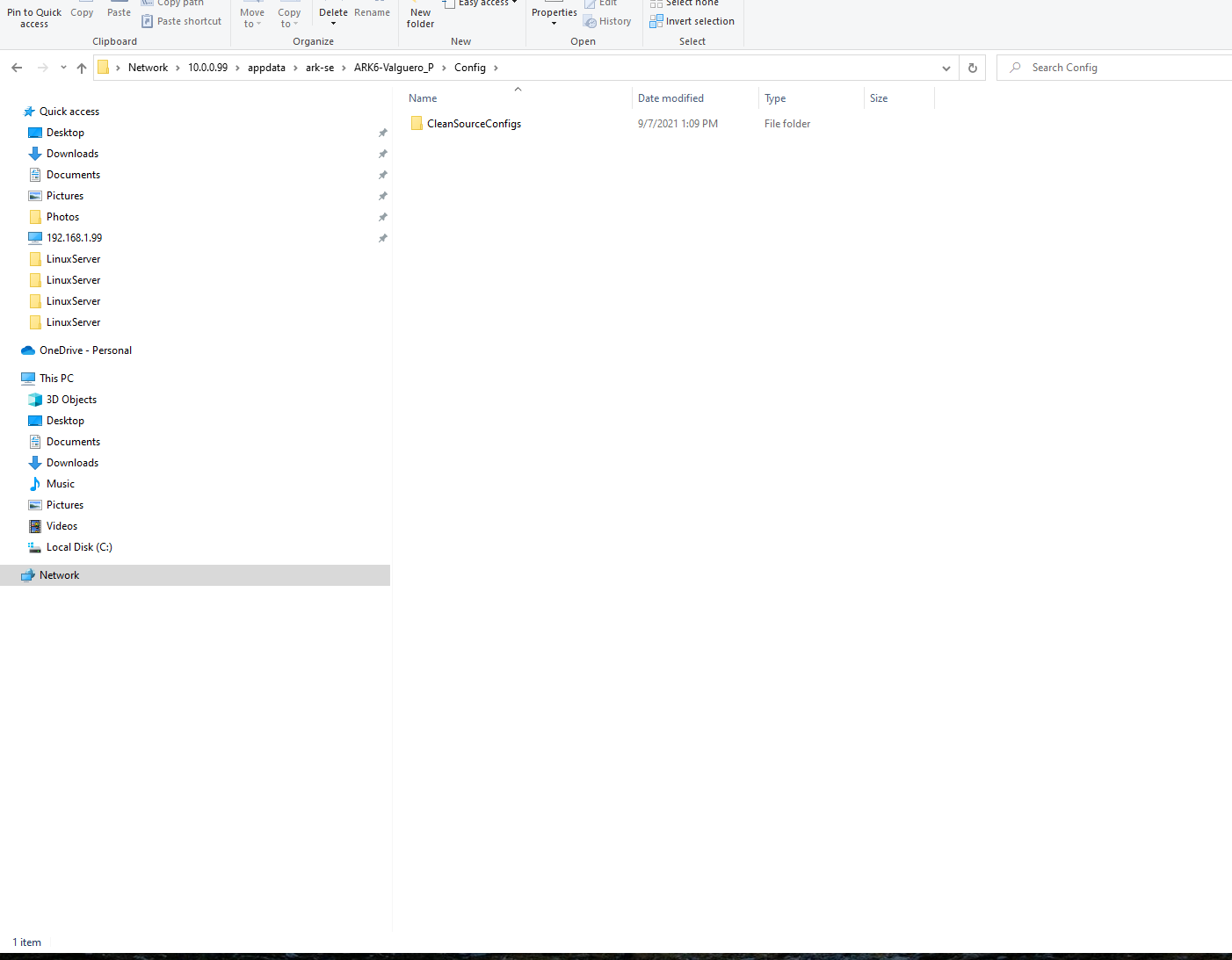

No, its not there
I have another unusal problem with an ARK Docker, Where the config files are missing but the server is listed and working. I am using @Cyd Templates for the ARK Cluster all is working but the config files location /linuxserver is missing on map Valguero_P config Here is my Docker config file The docker is up and running and even found in the browser. When I browse to that location, no config files to be found.
