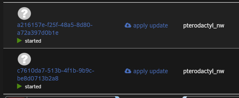

Question... I am new to pterodactyl and I realize it will create these bogus looking images that we just need to leave alone... but why does it say apply update to each one? I wouldn't want to do that correct? My panel and daemon containers are up to date. Thanks

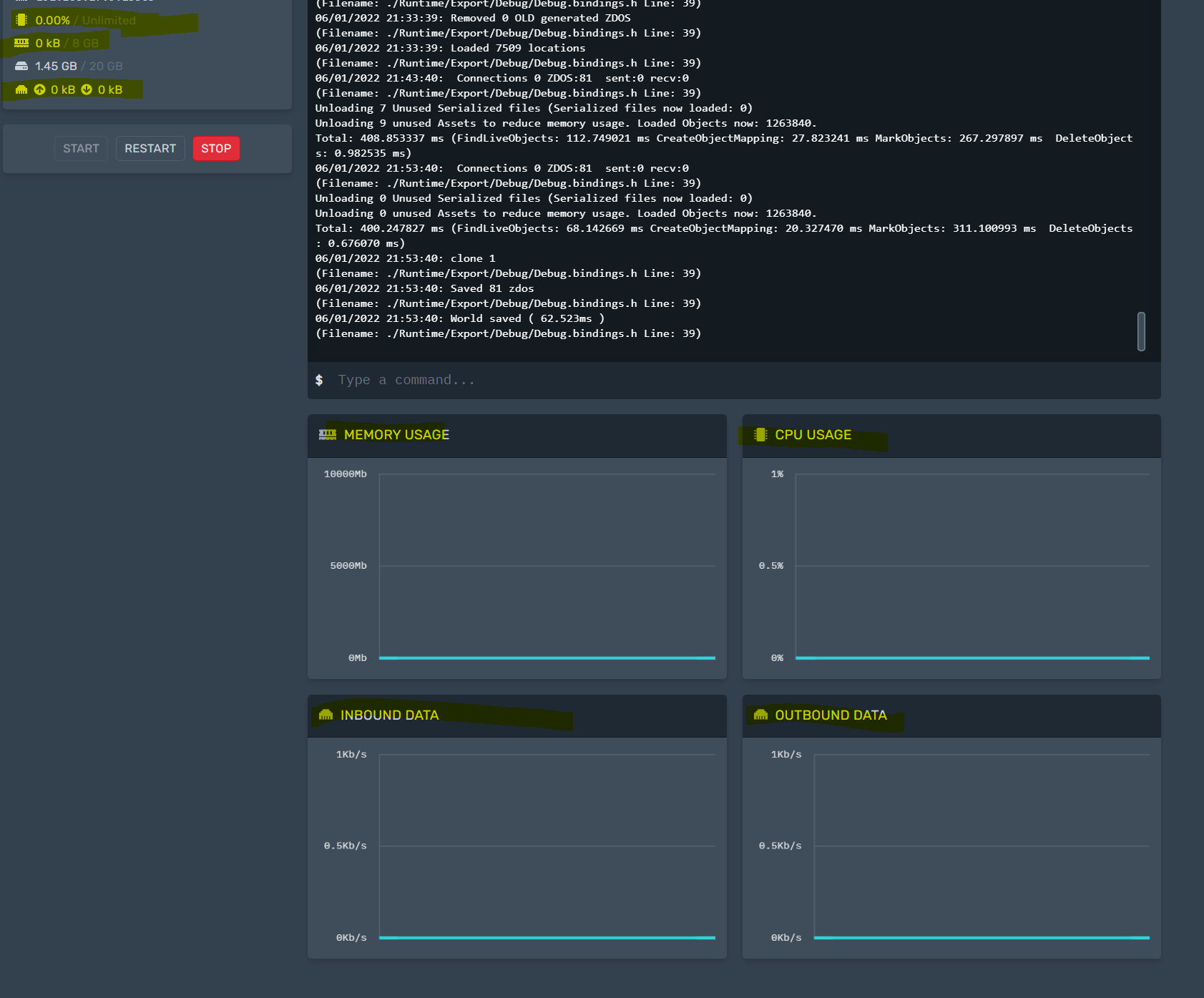

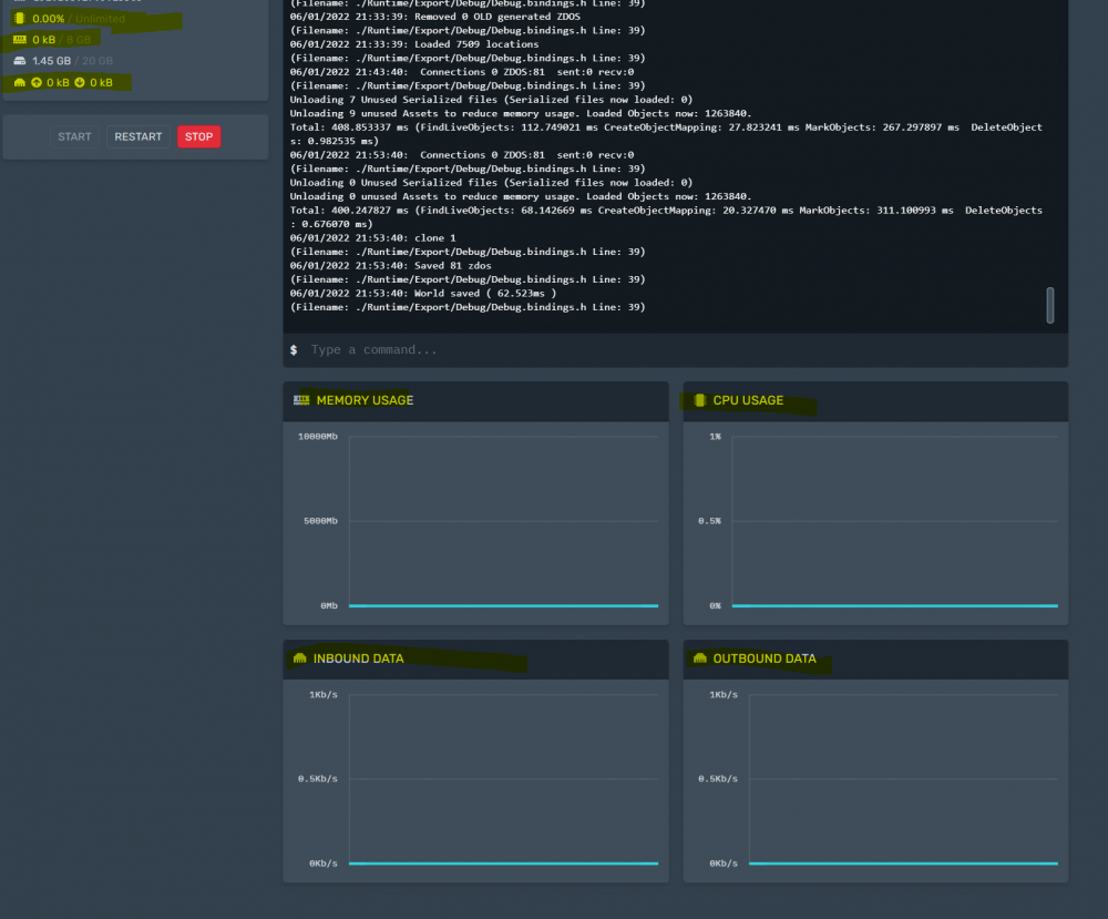

Also another question... my cpu/ram usage and other graphs all show zero. Any ideas? Thanks
