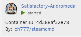

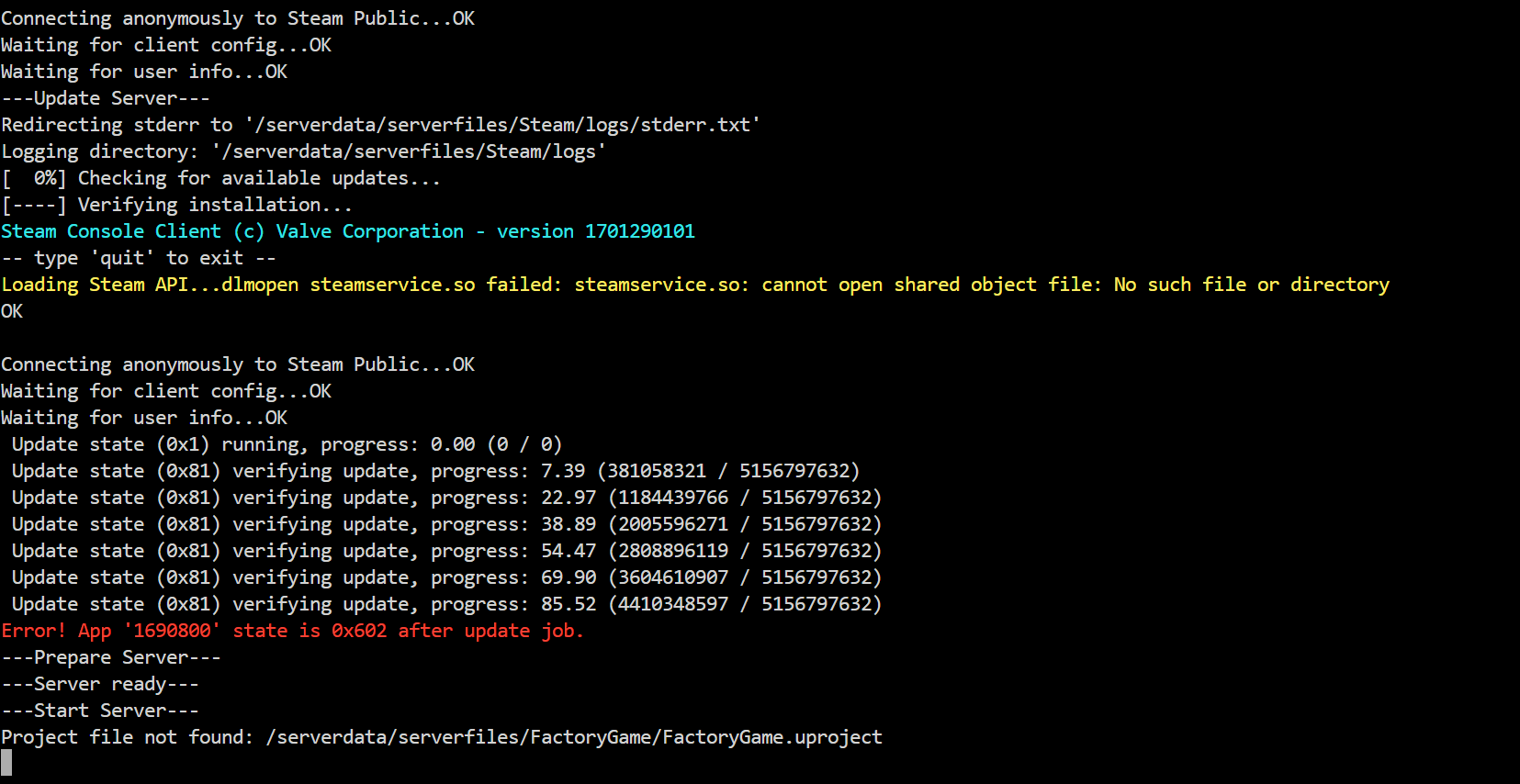

  2. Hi, I have a problem with the Satisfactory container. I have been running multiple Satisfactory servers for a while but stopped playing the game early 2023. I have now started again with some friends since the new game update. One of the containers is having trouble starting a lot of the time. I tried removing the container and installing it again. That does not work. Rebooting my Unraid server does seem to work most of the time, but that is not an option for me. The logfile shows an error but closes when the container reboots. I managed to get this screenshot: Trying to reinstall this container sometimes even gives me the error "can't find excecutable". My other Satisfactory container does start just fine, but this one keeps giving me trouble. Any help would be greatly appreciated.

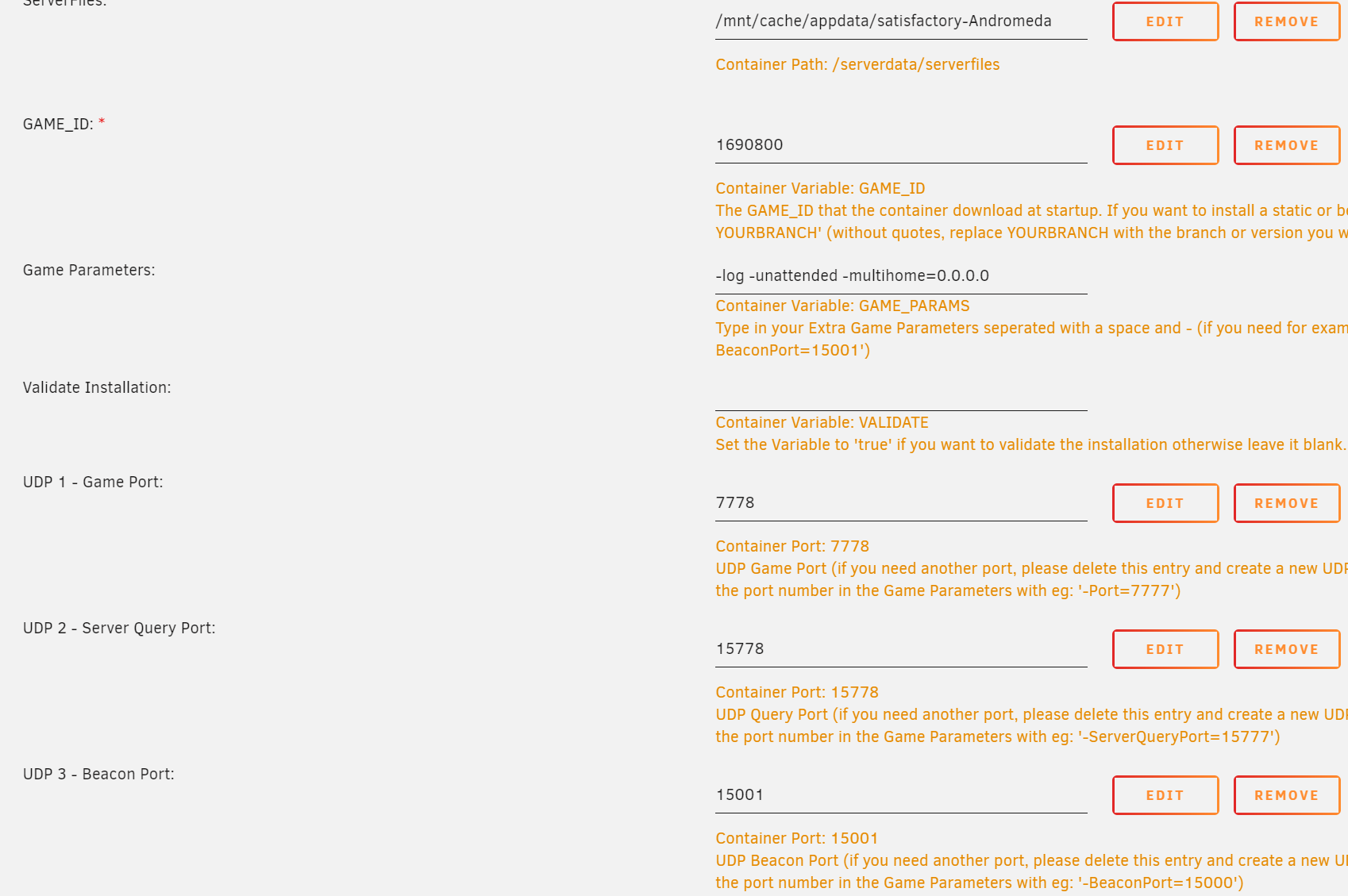

  5. I have the same issue. Can't stop, pauze or restart a container. I am curious if anyone knows a solution. I am on version 6.12.5. This issue started after upgrading from 6.9.2 to 6.12.5

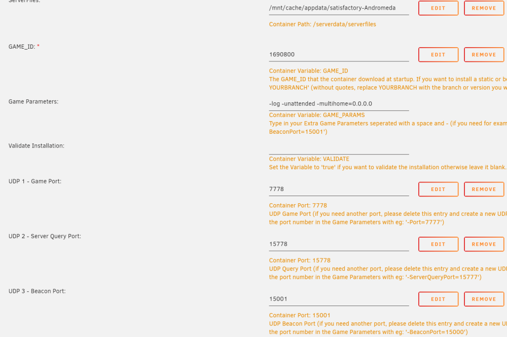

  6. Ah, now I see the option. I never looked at those settings in the container template. I will add the ports there. I have also managed to connect to my server in update 8. Quite buggy but that is expected from the experimental branch. Thanks for your help!

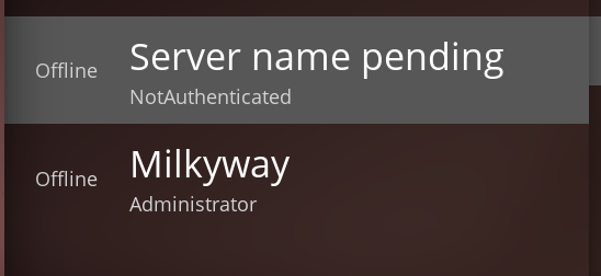

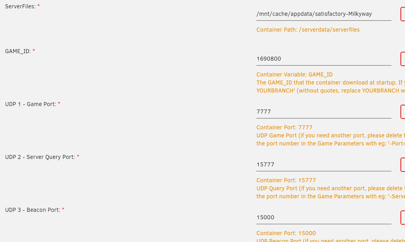

  7. U have updated the containers and am trying to boot into the experimental one in a few minutes. My game is now updating on Steam. What config file do I need to change? I am now scrolling through the Satisfactory folder in my appdata looking for config files. The only one that I have found now is the serverconfig. But if I open that with Notepad++, it only shows me weird data. I don't remember chaning a config file before, but it could be that I just forgot what I did back then
  8. Hi, I am running 2 Satisfactory servers. They both ran update 7 and different saves. Server 1 ran on the default ports, and server 2 ran on the default ports +1 (7778 instead of 7777). With the release of update 8 I wanted to try and switch one over to the experimental branch. Unfortunately, the server kept bootlooping. I assumed that I did something wrong and switched it off with the intention of fixing that later and wanting to play the game. I tried booting the server that I didn't touch, but that one was also broken. I then figured out that while I had the servers running on different ports, they were using the same Satisfactory folder in my appdata. Anyway, to fix it, I decided to remove both servers and templates and then install them again. I now can't get the second server to run properly again even though nothing should be changed. Server 1 is running just fine on the default ports; I can connect to that server and play the game. I then tried setting up the second server. I installed the container. Before installing it, I changed the ports to these values; I did remove the old ports and then added these as instructed. The server seems to install correctly and boot. The logfile shows that it is tying to use the ports 7777 and 15000 even though I have changed those; The server does not appear online in my game; I checked the port forwarding, and found no issues. These ports have not changed and 2 days ago, both servers were running happily on these ports. I have been trying to get this to work again, but don't know what I can try. Everything seems to be as it was before. Does anyone know how to fix this?
