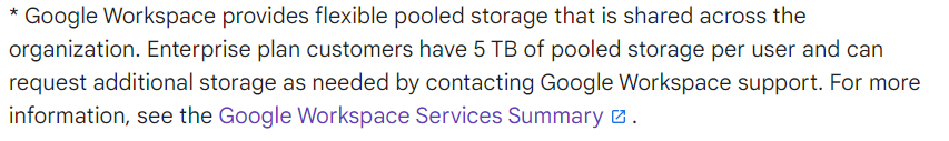

I just contacted support. They told me that I could add another account to double the storage, or contact sales to see what they can offer me. They did not have an answer for me as to why the enterprise account says unlimited storage, but is only 5TB. I am now looking at dropbox. They are quite a bit more expensive, but taking power consumption, drive costs and capacity in mind, it might be worth it. I am going to be trying the trial of Dropbox to see if streaming works well. -

I have started uploading and because I have an enterprise standard, I assumed that I have unlimited storage. Google drive shows that I have a maximum of 5TB and I just got a mail telling me that if I exceed it, the files will become read only. Looking at the ways to increase the size, I see that I have to contact support and request more storage. Does anyone else have to do this? Or is the 5TB limit not enforced? -

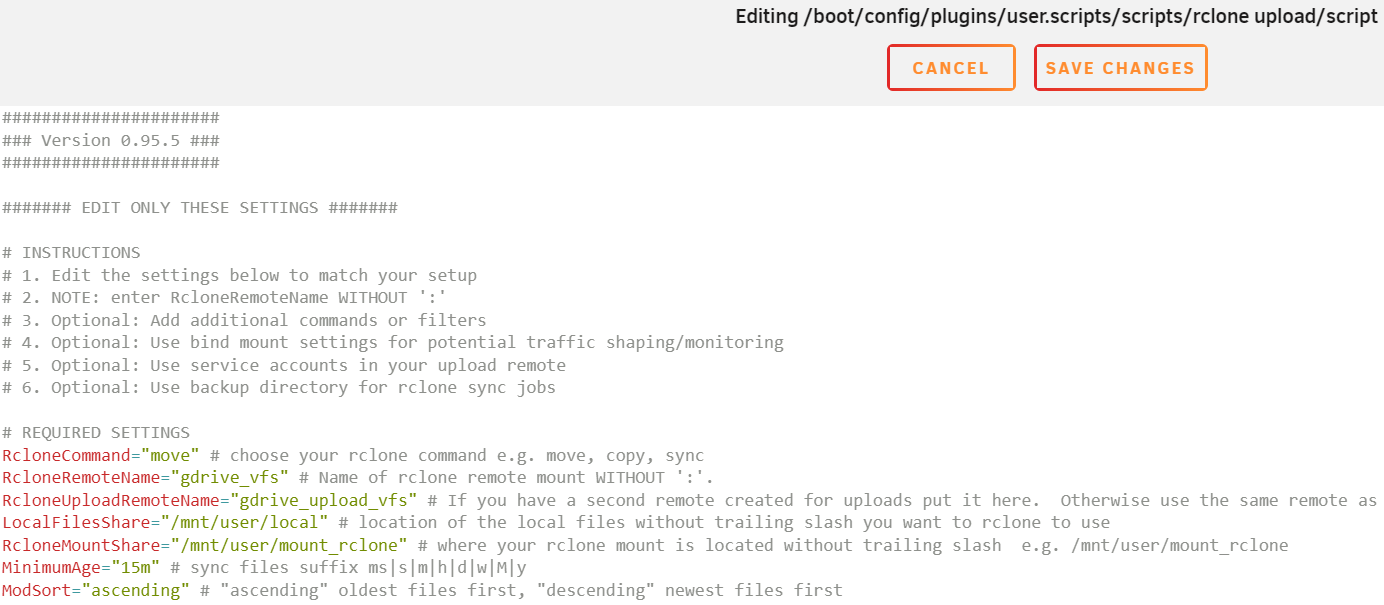

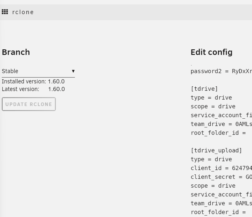

I think that I might still not understand fully how to set it up then. I get how it works now (I think) but am not sure if I did set it up correctly now. I think that I did use a service account to create the mount. I noticed that I didn't have to login to Google to verify myself when creating these mount points. Is this mount correct?; The service account file is the first file in the folder: I assume that when the upload reaches 750gb, it shuts itself down, and like you said, the next time it starts from a cron job, it will use the second account? Or do I have something setup wrong and need to change things? Sorry for asking so many questions. I am trying but am not that good when it comes to new things like these. EDIT: I realised that I didn't change any parameters in the upload script for the service accounts: I guess that I need to change these as well. I will do that now: -

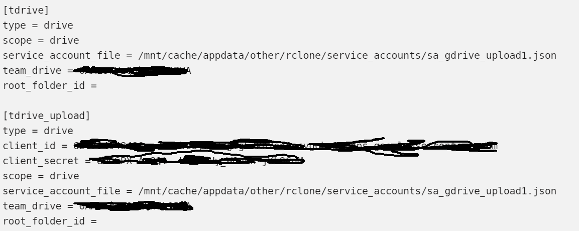

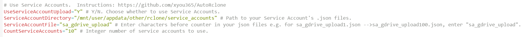

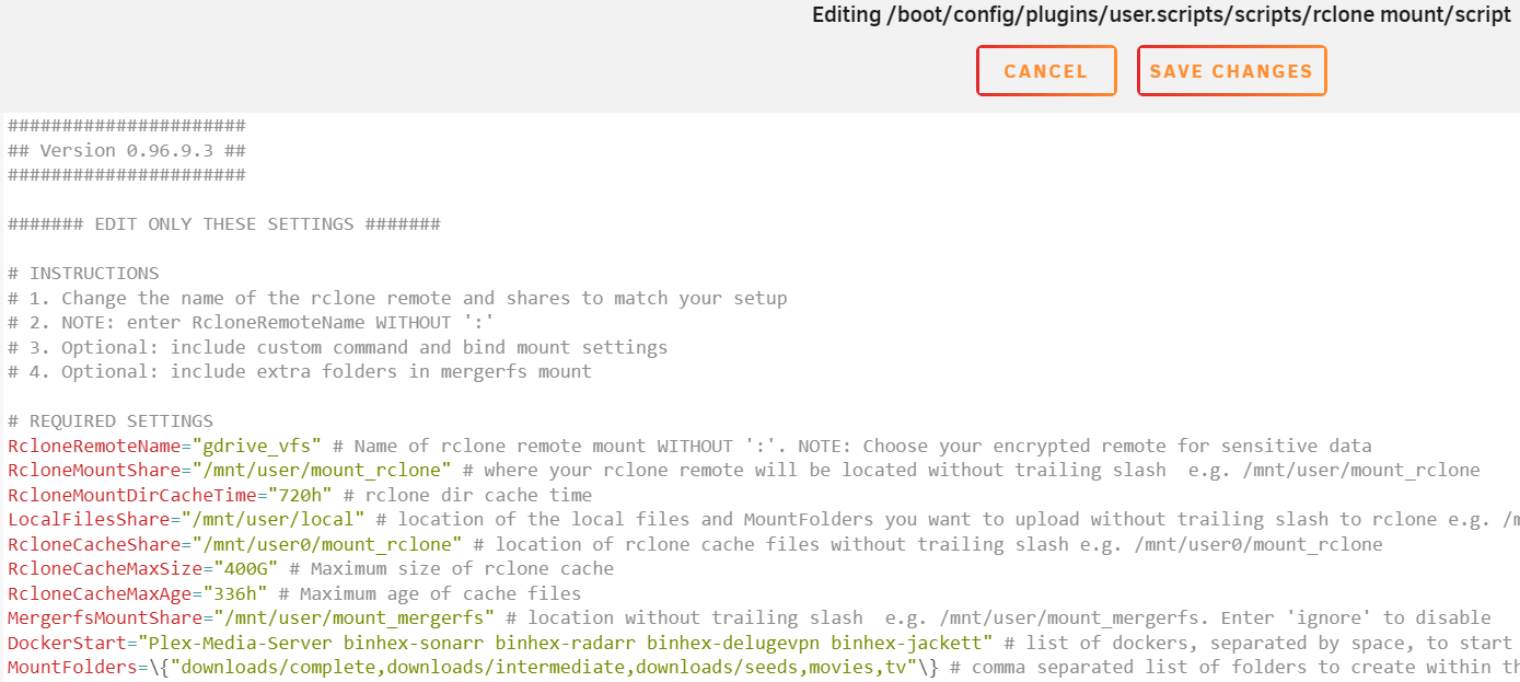

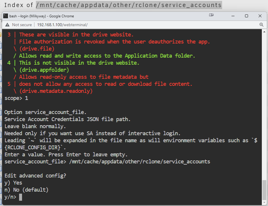

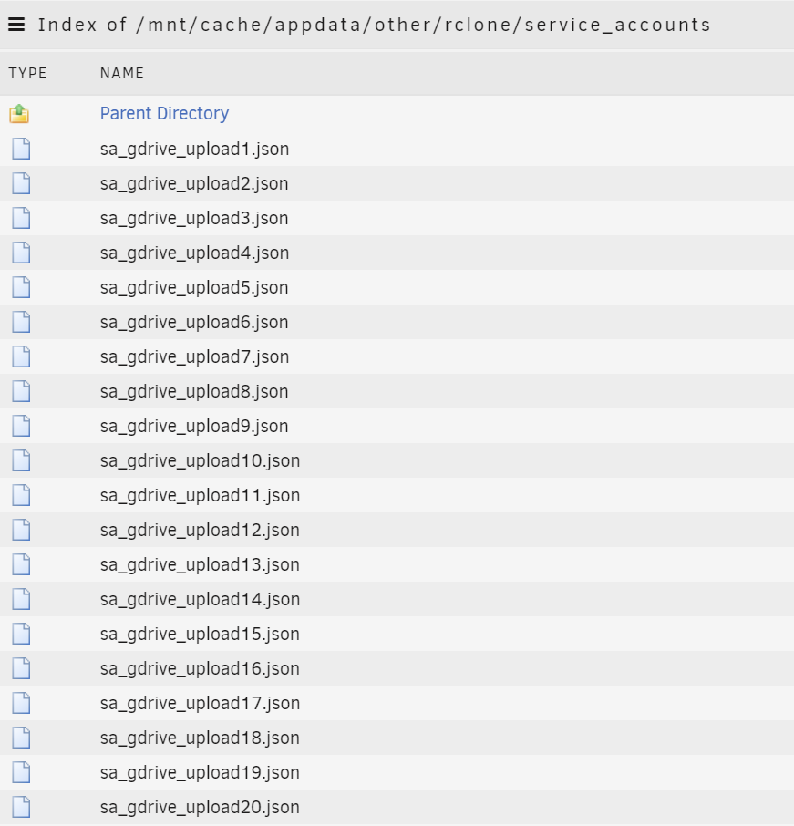

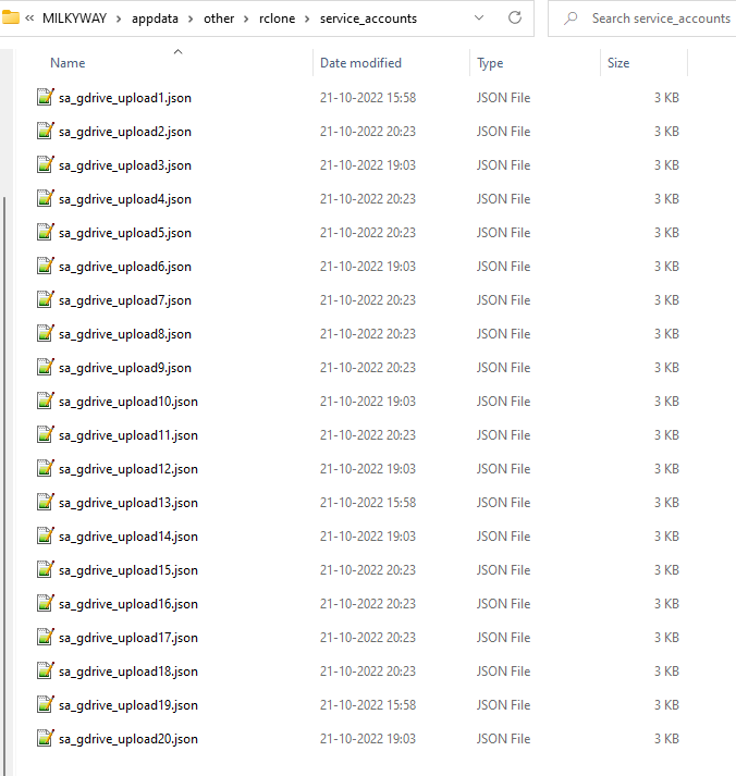

I cant figure out how to add them and what window you mean. I assume this window: What I did (for testing) is instead of pointing the SA location in the previous post to the folder containing all 20 SA accounts, I now went a level deeper and gave it the path to the first SA account in that folder. It now points to: Then created new upload and mount scripts, and now it has been uploading for half an hour at full speed. I hope this works and that it will change over to a new service account when it reaches the 750gb mark. -

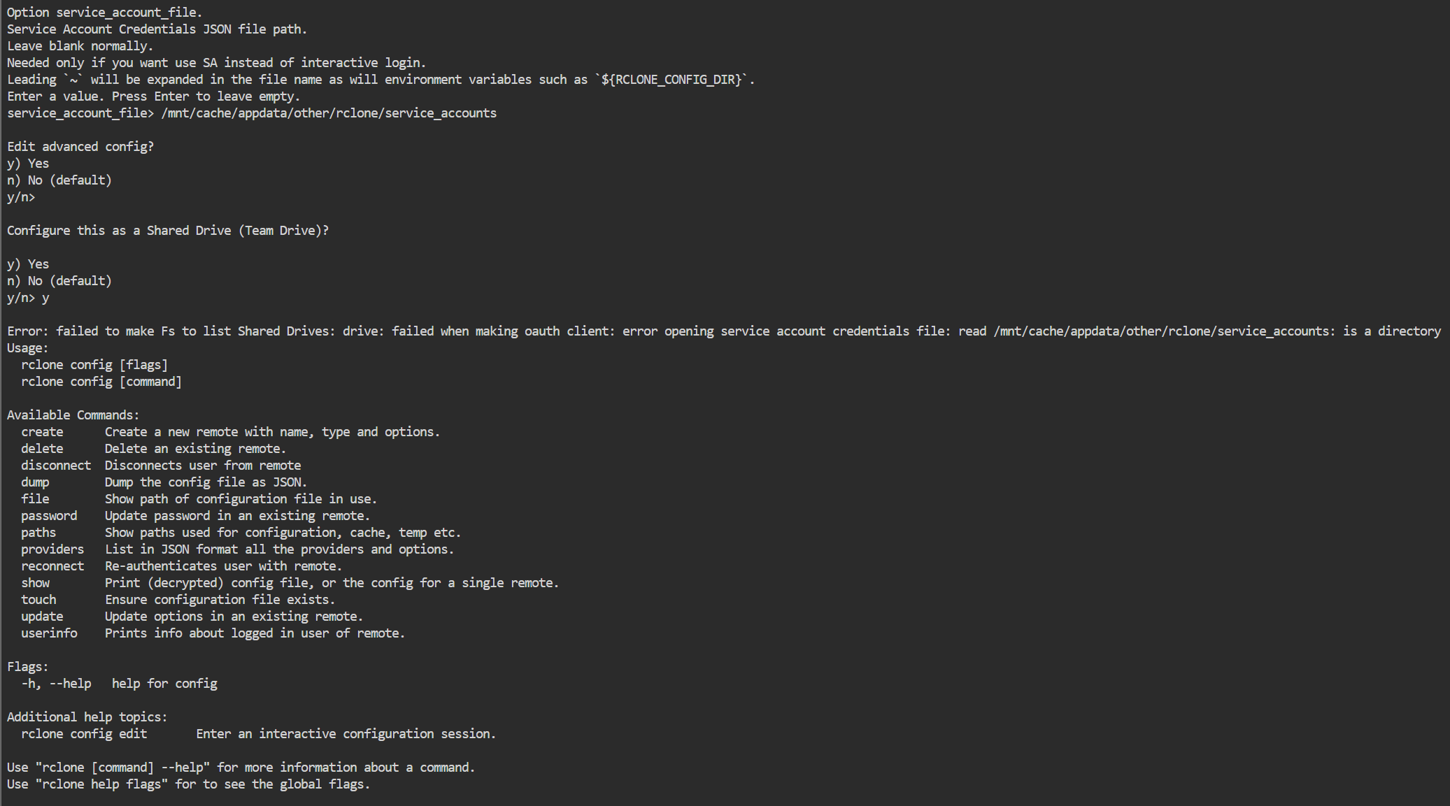

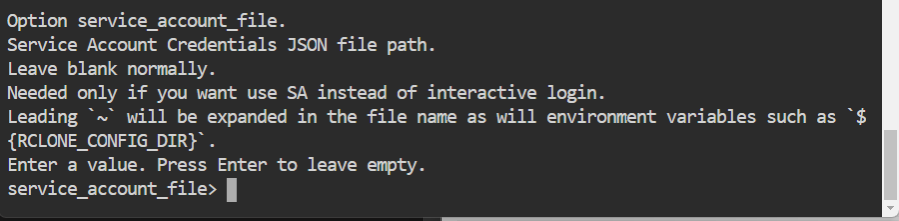

Thanks for the info. I still have a copy of all the accounts saved somewhere, so they are safe. I tried creating a tdrive and got to the part where it asks me the location of the SA credentials: I assume that I need to put the path of the SA accounts there. That would be: I had to save them there according to the renaming instructions. But when I enter that path, it doesn't work: because it can't find the files in the next step where I say that it is a team drive: I see that it is asking for a file, and not a path, but I thought it needed the path to all 20 accounts? What am I supposed to put there? -

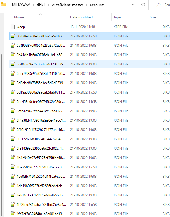

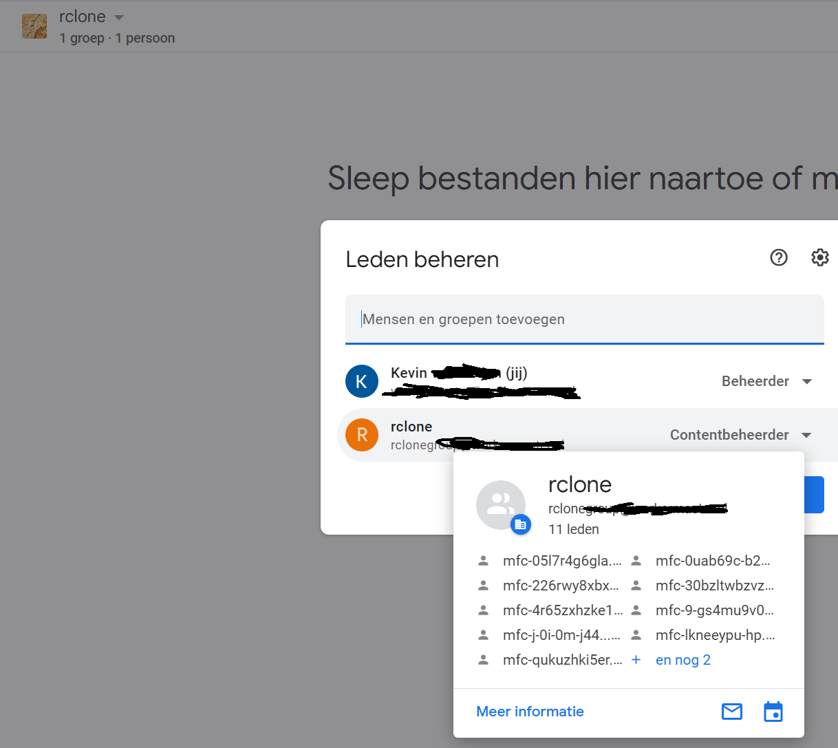

So, I am almost there. Turns out that I created about 800 SA. Some with a new project and some not. I don't think that should matter. I have removed a lot of them and only kept 20. Of these 20, I have added 10 to the group and added that group to the teamdrive. The accounts are saved in appdata and renamed according to the instructions. As far as I can tell, this only leaves the editing of the mount and upload script. I do need a little bit of help here because I can't figure out how to edit them so they point to a teamdrive and not just Google drive. This is the upload script I have now: And this is the mount script: They pointed to the drive at the top but now need to point to the teamdrive: And (hopefully my last question) how do I move the data that is already uploaded in the secure folder, to the teamdrive? Someone mentioned using the move command in Rclone, but I don't know how to use that. Can I just have 2 mount scripts running at the same time and copy the data already uploaded to my local sytem and then later have it moved to the teamdrive? -

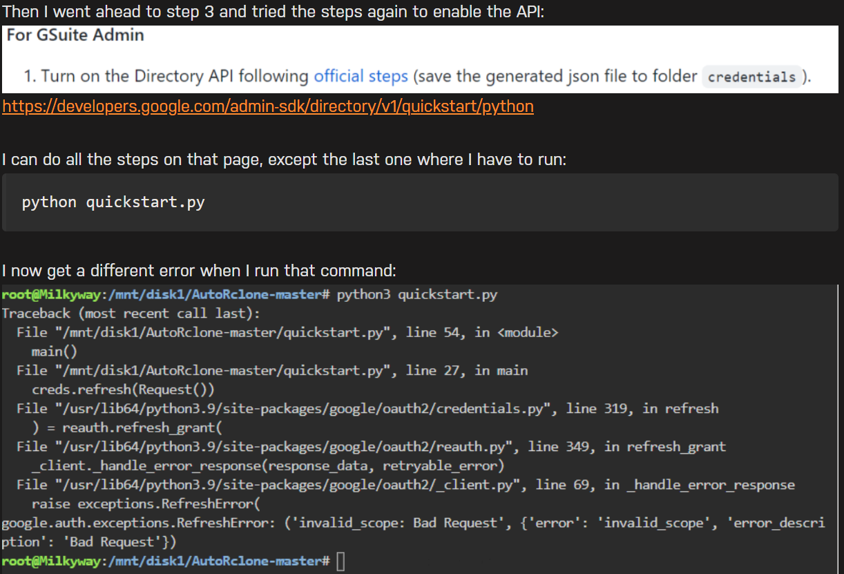

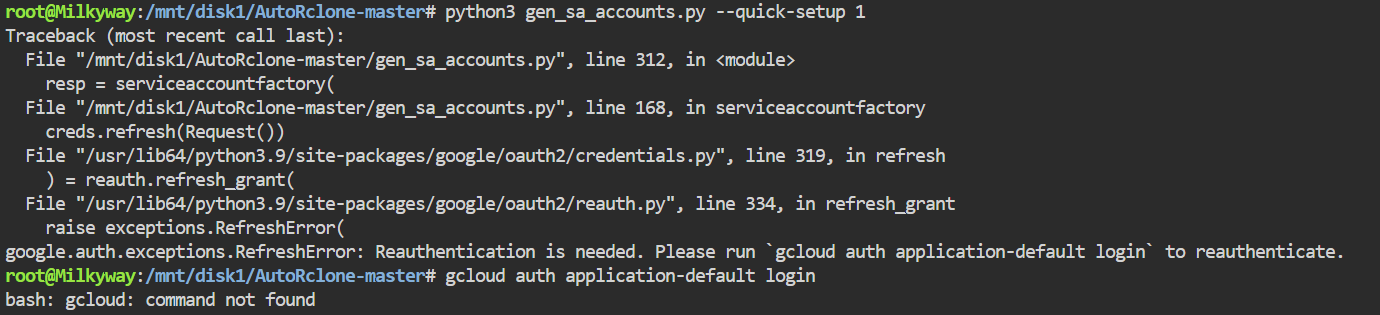

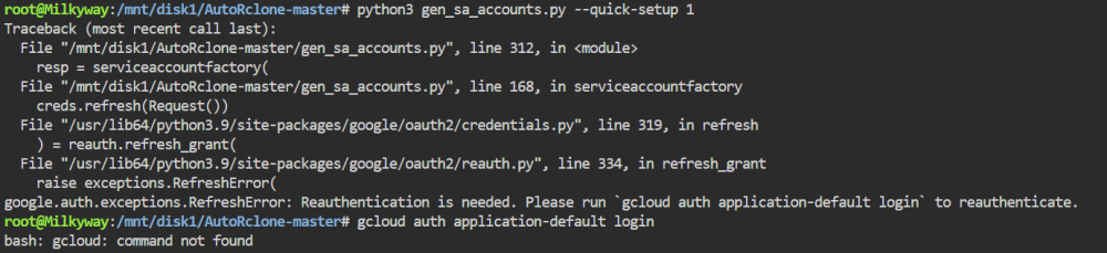

Thanks for the help. I tried running this the command agian to create the service accounts (wanted to start a few steps back to make sure that I do everything correctly). I get an error telling me to authenticate again, but I don't know how to do that. I also tried to continue with the accounts that I already have, but got an error telling me that the index is out of range: I realise that the last step is optional. You can also add the accounts manually to the group. Do you know how to do that? I made some screenshots in this post asking how to do it: Do I need to copy the emailadresses from the service accounts and paste them somewhere? EDIT: I think that I figured it out. I opened up 10 of the SA .json files and copied the email address inside. Then added that to the goup and then added the group to the teamdrive: I have only done 10 for now, but 7.5TB per day is plenty for me. So now I have to figure out how to rename the service accounts, where to save them and how to edit the mount and upload script so they both know to use the teamdrive. -

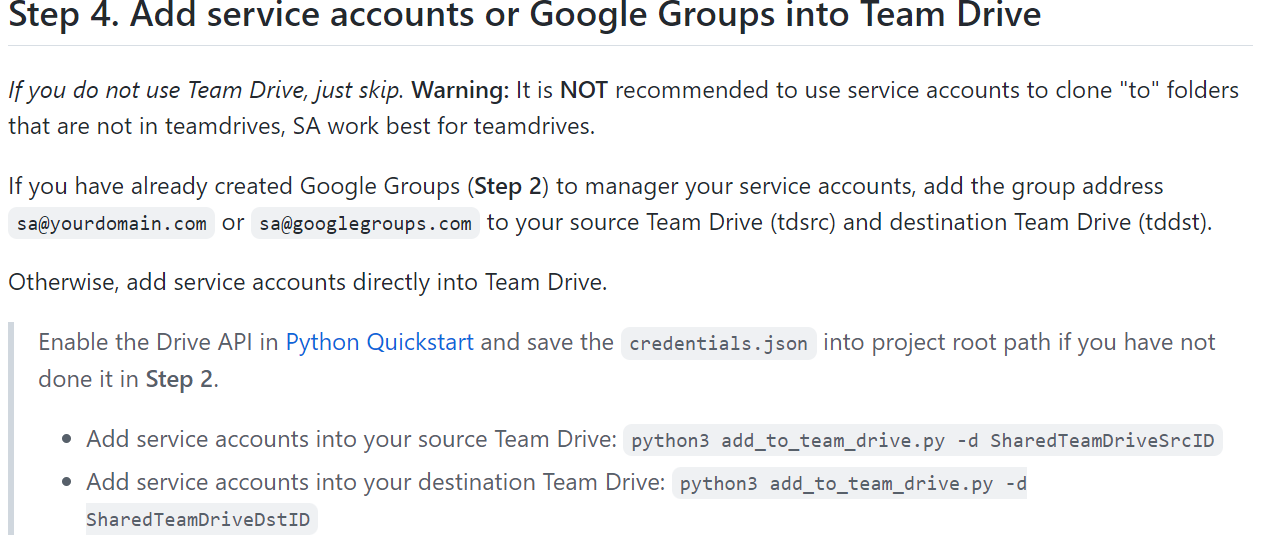

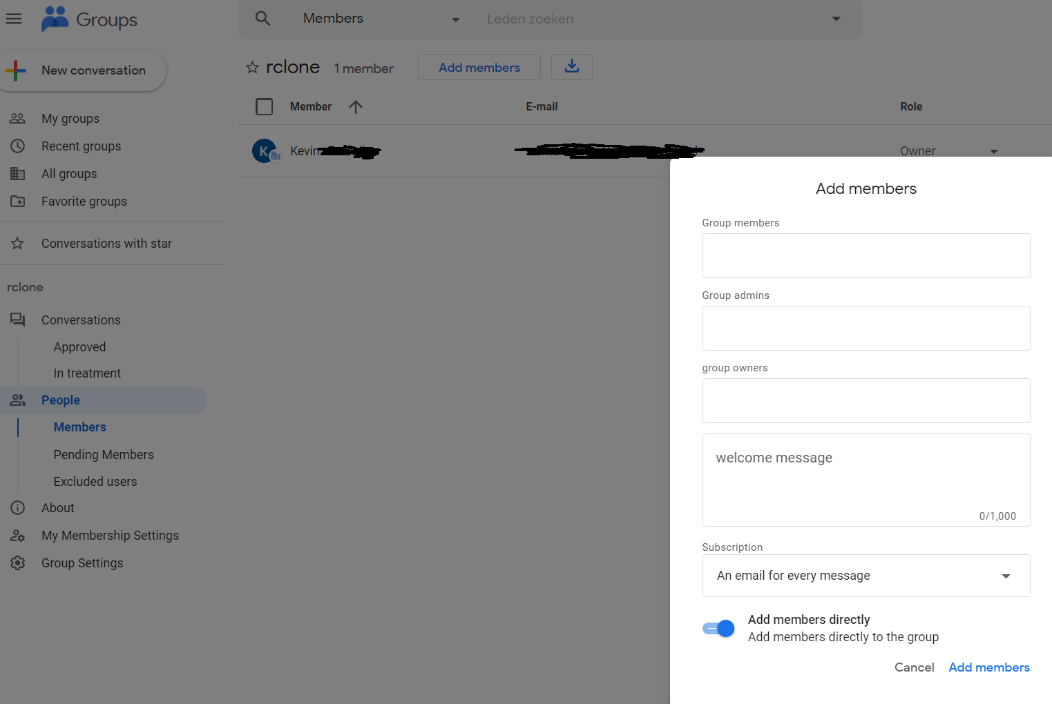

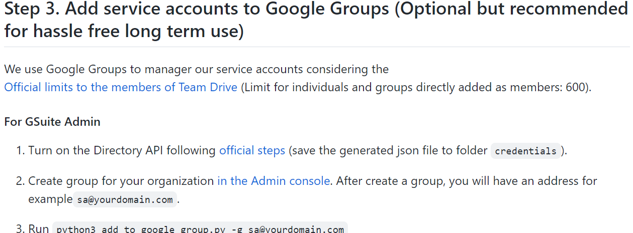

Thanks! Good to know that the shared drive I have already created is a team drive. That clears up some confusion for me. While I have created the group, I have trouble adding the service accounts to the group. I hope that this is the last of the problems I encounter, so I can start the upload process. As I mentioned, I need to enable a SDK API, and then run a command to open the quickstart.py and give permission to something. But I get an error when I do that. I hope @Kaizac or someone else can help with that error. I get the feeling that his is the last of the problems still in my way. Then again, I am a professional idiot and tend to find all the problems that you can find, so who knows. -

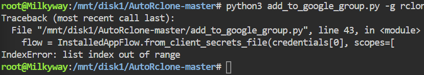

I think that I managed to create 100 of them, but according to the manual, I now need to enable a SDK API and I am stuck there. I get the error's mentioned in the posts above. I can skip those steps and manually add these service accounts to the group I created, but I don't know how to do that. What do you mean renaming? None of the steps mention that. Do you know how I should rename them and how to add them to my project? I am trying these steps (Step 2 is complete, a group is made, but step 1 gives me trouble): In the meantime, I was reading up on the next steps. I see that I need to have a teamdrive. When I login to Google drive, I only have 2 options: The top one is where I am currently uploading data. The bottom one is a shared drive. Is a shared drive the same thing as a team drive? -

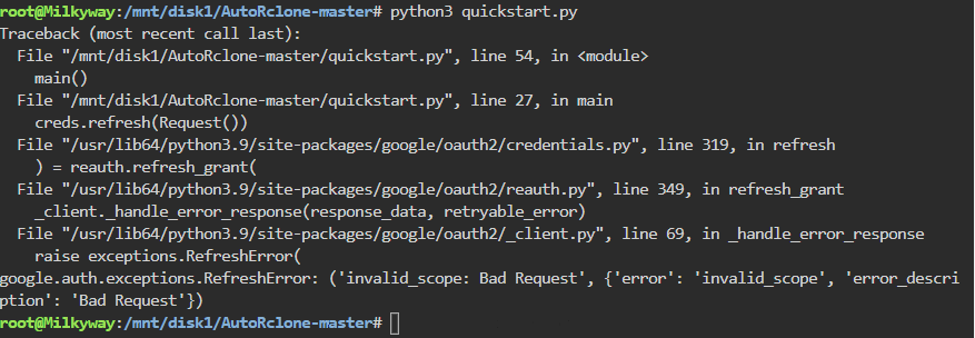

Right, so I kept trying things and thought that maybe I should try to run: python3 gen_sa_accounts.py --quick-setup 1 and have Python create a new project with accounts. There were no errors during this step. Then I went ahead to step 3 and tried the steps again to enable the API: https://developers.google.com/admin-sdk/directory/v1/quickstart/python I can do all the steps on that page, except the last one where I have to run: python quickstart.py I now get a different error when I run that command: I also did not see a second project: So I am not entirely sure that a new project was created in the previous step. Maybe that is the reason why I keep getting errors in this step? I am not touching anything for now in fear of making an even bigger mess. EDIT: how do I manually add the service accounts? I have this screen: And these accounts: What do I need to copy into what field?
