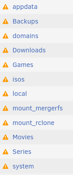

Thanks for the explanation. I now just have one more question about how to handle the media I already have. I have multiple shares on my server containing the Plex media: What would be the best way to get all the media in the Series and Movies shares to Gdrive? Just copy/move all the media in those shares to the media folders in the local share? I can do that, but that would mean moving 84tb and would take a long time. Is there a better way to do this? EDIT: I just moved a small folder (29gb) from the Series share on my server to the TV folder in the local share. I then waited for almost 45 minutes, but it is not being uploaded to Gdrive (not showing up in the rclone_mount). What could case this to not work? This is the upload script: And this is the mount script:

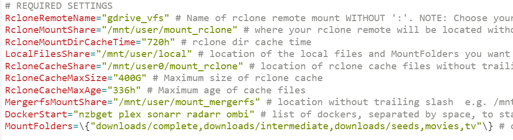

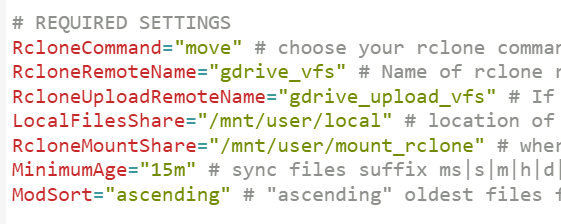

I renamed the mount and both the mount and upload script are running. I have read the first post again but am still a little bit confused about the new folders that have been made. I now want to create the folder structure on the gdrive. Something like this: Media - Movies - TV - Documentaries etc. I also want to start uploading the media currently on my local server to Gdrive. I am confused about what folder I need to use for uploading the data and how he data gets uploaded to the correct folder. If I am reading the mount and upload script right, then the LocalFilesShare is where I need to place the files that are uploaded by the upload script. A local folder has been created on the server and it contains this folder: But that same folder also exists in the mergerfs folder: The rclone_mount is empty Basically, how do I upload my TV files to the TV folder in gdrive?

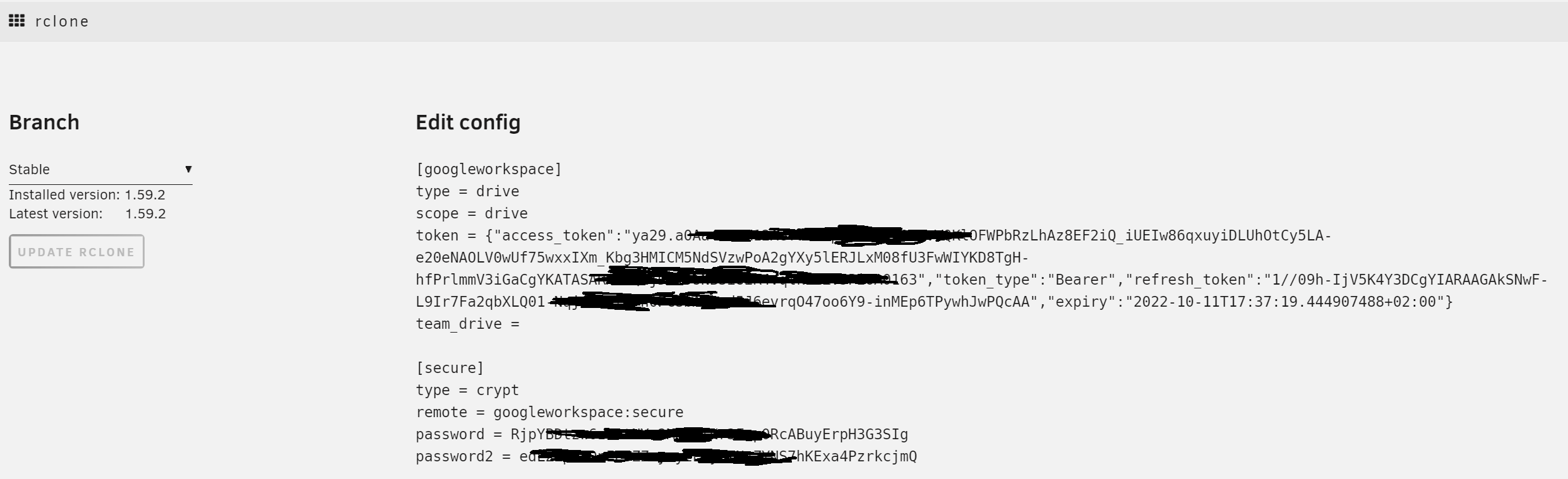

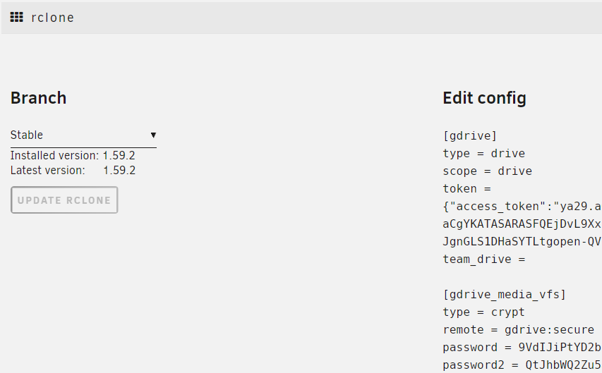

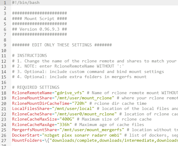

I suspected that names could be changed, but am not that confident that I got it right. These are the 2 remotes I have made: This is the mount script: Could you please tell me if this is setup correctly? I have now tried to keep the names of mounts and folders the same as the default mount script and first post in this thread. Can I safely start the mount script now?

I am going to create the mounts again, since my last ones were a bit weird. I have just one question (for now), you mention that we need 2 mounts. You have given them both a name here, but in the scripts you call the mount "gdrive_vfs". Is this correct? Should the name of the mount in the script not be the name of the crypt remote if you want all the data going to to gdrive to be encrypted?

Can anyone verify that I have made the mounts correctly in the post above? I want everything on the Google workspace to be encrypted

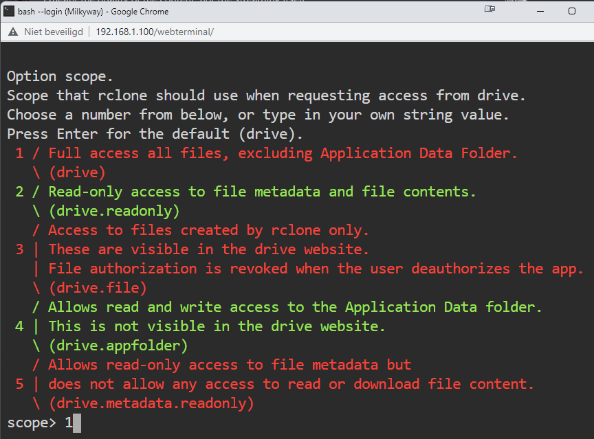

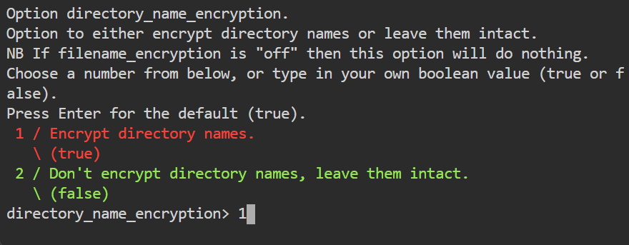

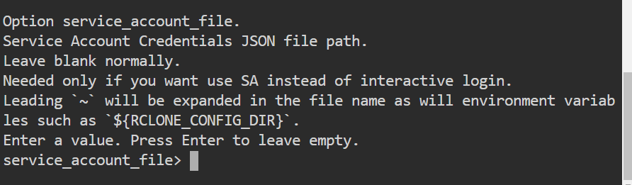

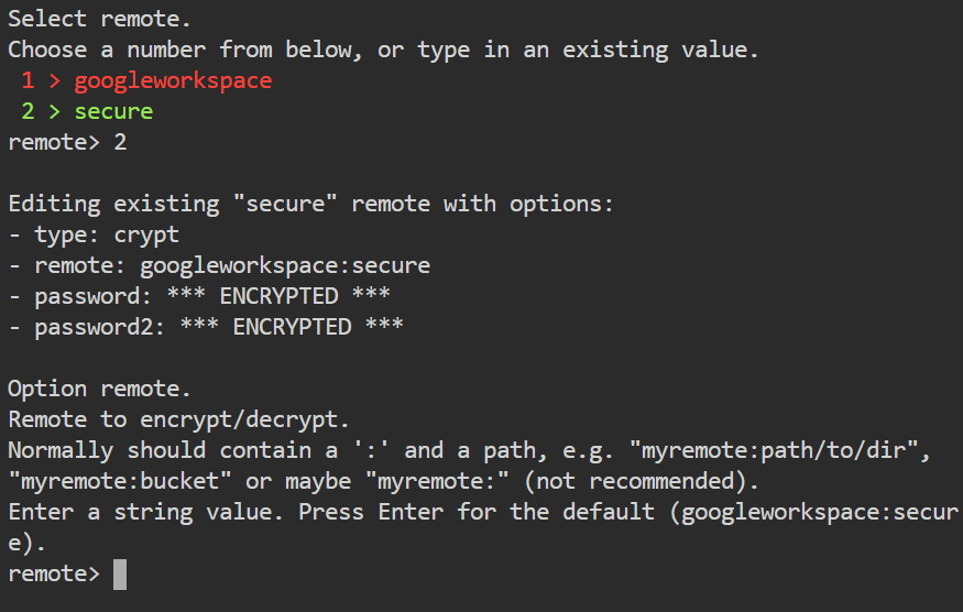

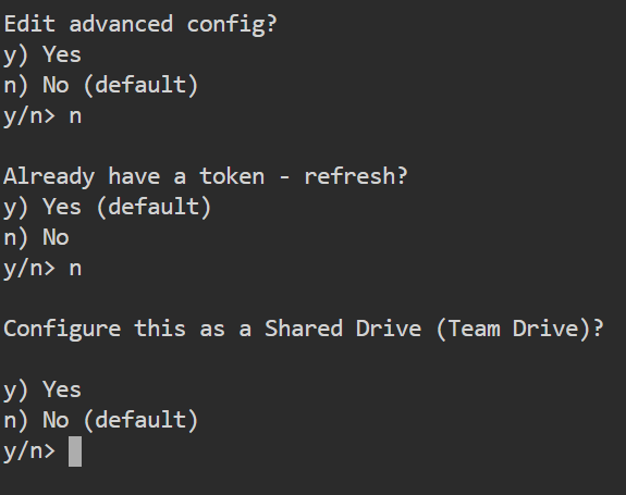

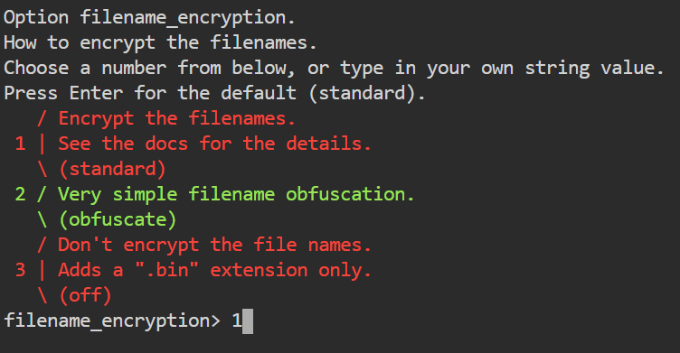

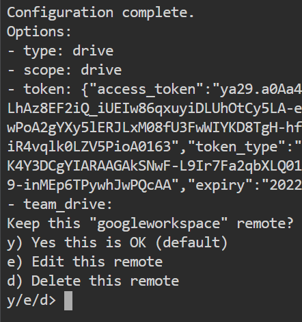

Thanks for your help. I thought that encryption was enabled, but am not sure. I have opened the terminal again: I then edited the googleworkspace remote I select 1 there because I want the remote to have full access. I left this one blank: I left the next options on default, but I am not sure what to do with the shared drive option. I left it on No for now I think that should be fine, but am not sure if it is configured corectly. Here is the encrypt remote: I just press Enter because I want it to encrypt the googleworkspace remote I am not sure if I need to change anything here.

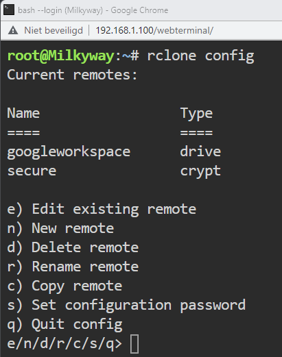

I am trying to get this setup but am struggeling with a few things. You mention that I have to setup 2 remotes, but I don't know how. I found this video from Spaceinvaderone: but that video is very old. I followed what he did and created 2 remotes. Is that the correct way or do we need to create them some other way? This is how they look now: I have made a Google business account and have my own domain. I then upgraded to Enterprise where it said unlimited storage, but when I look in Google Drive, it says that there is only 5TB. Do you know why that is?
