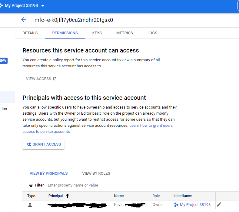

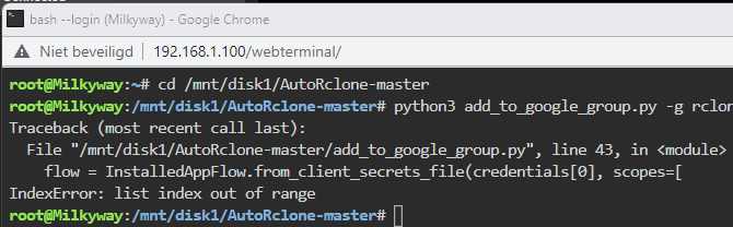

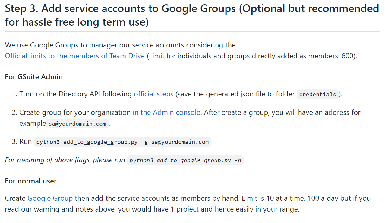

I tried running the same command directly on the server, but that made no differnce. I also tried removing all files in the project folder and start from scratch, to rule out any mistakes or other weird things since I first tried most commands on Windows. I got to the same point where I am now. Since I am stuck at the first step of this part: I decided to try and do step 2. Step 2 is completed and I think that the group I made, should work for the next few steps. I did make sure that the credentials file used in activating the Directory API is the correct one. I tried running step 3, but that gave me this error: I think that I first need to get step 1 to work. Or figure out how to manally add them to the group

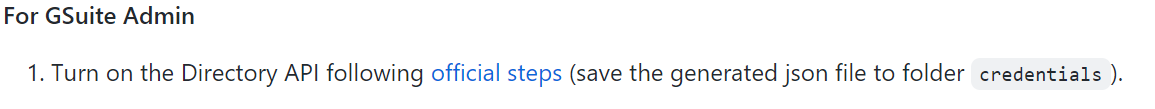

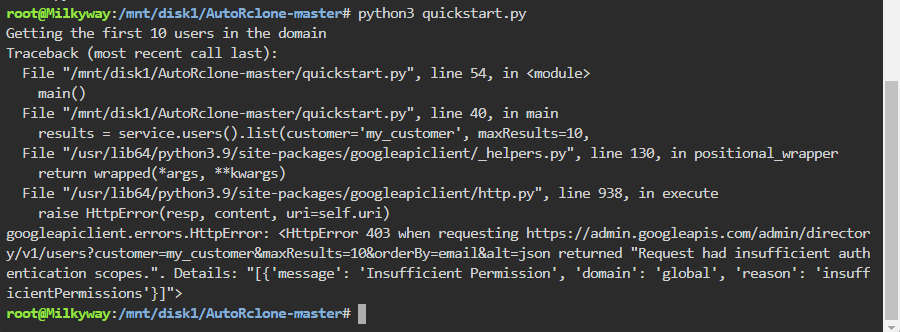

I have already found the next problem. I did try and search for it on the Github link you gave me, but couldn't find it. I have now created a new api according to step 3 of the process (here ) and am trying to run the command: python quickstart.py that I have to run according to this page: https://developers.google.com/admin-sdk/directory/v1/quickstart/python I now get the error that there are insufficient permissions. I expected a screen where I had to give permission to rclone. Since I thought that the problem was most likely the previous command: python3 gen_sa_accounts.py --quick-setup -1 because I am not 100% if that was the option I should have used, I tried figuring out if the service accounts belong to that existing project. They appear to do so. Here is one of the accounts:

Thanks! That solved the problem. I am now going to try and follow the next steps and have dinner.

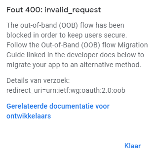

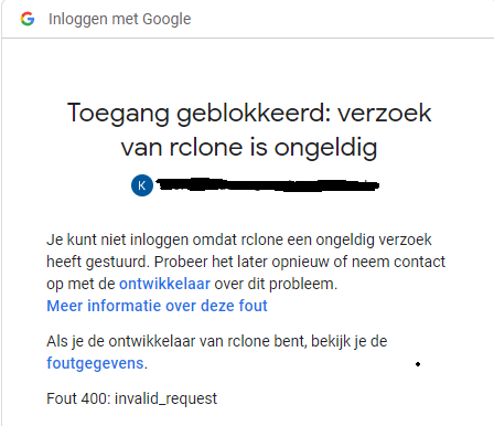

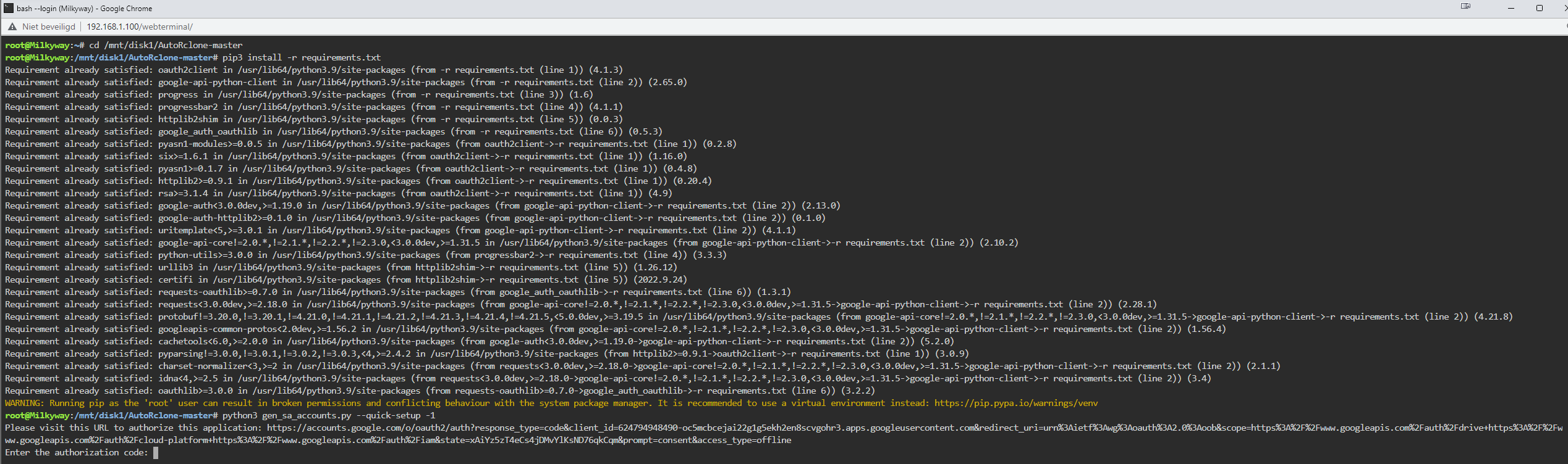

I ran that command and then ran the requirements again. It worked. The errors were gone. I then looked again at step 2 of creating the service accounts, and since I already have a project (you need to make one to enable the drive api) I thought this command: python3 gen_sa_accounts.py --quick-setup -1 was the best one to use. I entered that into the console and this time, it told me to go to a link to give access to the script. This is where I get my next problem. The request seems to be invalid: It says that the access is denied and that I should contact the developer for this problem. I tried doing this on a pc that has the Unraid UI open, and also on the server itself (booted into gui mode). I get the same error. I also tried running the other commands: python3 gen_sa_accounts.py --quick-setup 1 --new-only python3 gen_sa_accounts.py --quick-setup 1 to see if they gave a different result, but nothing helped. Do you know why the request is invalid?

Right. I got pip working (just had to install it in the nerdpack) I am now getting a lot of errors while running the command. I didn't get these before on Windows. What could be wrong here?

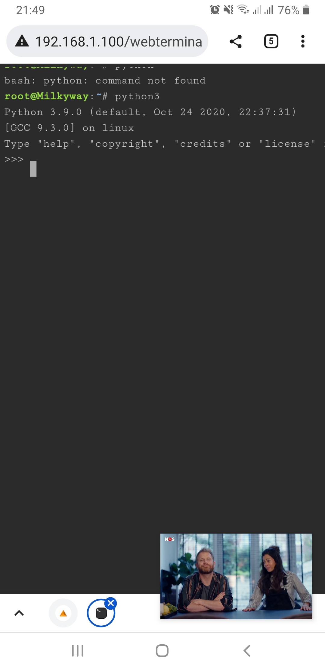

Guide: How To Use Rclone To Mount Cloud Drives And Play Files
I didn't know I could do that. I am going to try that in a moment. EDIT: Trying to run this now. I couldn't find a Python download in the community apps, but then remembered that the nerdpack could have it. I enabled and installed it there: I also moved the project from my windows PC to Disk 1 on the server. But I have no idea how to run the code (I know the directory is not correct in the above screenshot, but it doesn't even find the Python commands) I have never ran anything like this on the Unraid console before, so sorry if I make obvious mistakes. Should the above be enough to work, or should I run these commands in Unraid: EDIT2: I have figured out that I can do this; to start Python. I am now in the project folder, but can't run the needed commands: I now have to figure out how to get pip working
