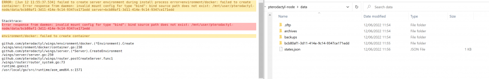

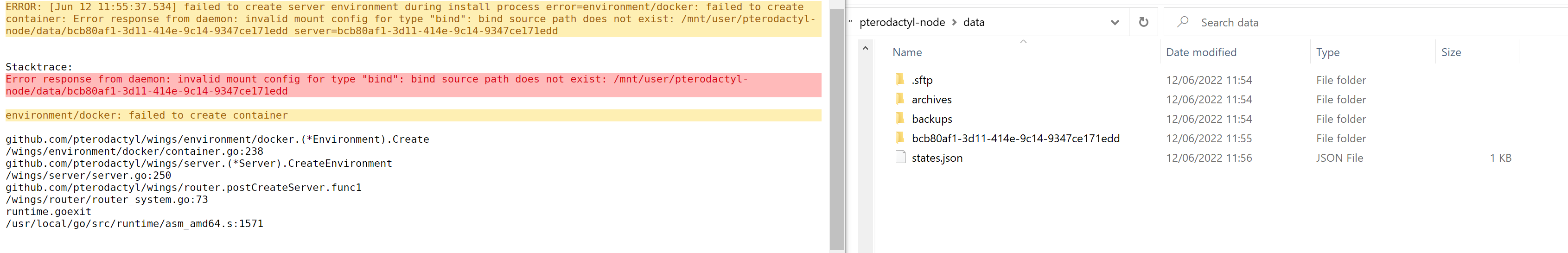

Is anyone able to help with this error I am getting from the pterodactyl Daemon.
ERROR: [Jun 12 09:49:05.975] failed to complete server re-install process error=Error response from daemon: invalid mount config for type "bind": bind source path does not exist: /mnt/user/pterodactyl-node/data/94163d68-1be6-422a-93be-605aee16c962 server=94163d68-1be6-422a-93be-605aee16c962
Stacktrace:
The folder and location it is referring to do exist and it does have access as it actually created the 94163d68-1be6-422a-93be-605aee16c962 folder right before spitting out the error, this happens with any server I try to setup using both the Ibracorp docker template and the official one.
Thanks in advanced for any suggestions.
Stacktrace:
What Unraid version are you using? I had that problem in 6.10.2 because of wrong permissions. Also check the paths in your config
I'm using unraid 6.9.2 probably time to update but don't want to break any of the other dockers which are working by updating.

Just tried to install a new server after a restart I have attached a screenshot showing the error & that it has infact made the folder... this has me mind boggled.
I do not know how to troubleshoot this any further. Sorry, but I have very little experience with this. I can recommend to join the Ibracorp Discord server and post your problem in the "Docker" channel. That is the same channel where I posted my problems, and they were very helpfull.
In my case I had permission issues on 6.10.2. Tried a testserver with the same Unraid version and had the same problems. Then tried a testserver with 6.9.2 and it worked first try.
