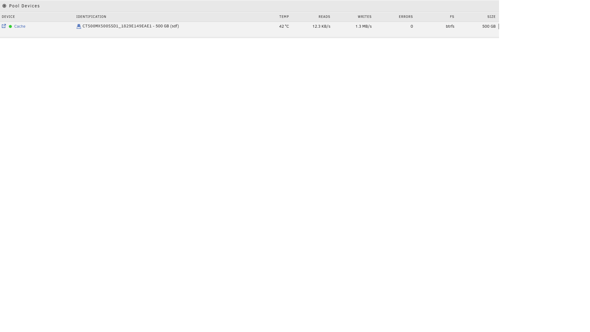

  4. This is my cache
  5. Ok thx
  6. Everything is running again. Should I be worried about my cache SSD drive ? It's 7.5 years old now. Guess it about time to replace anyway

  10. Hi Getting errors with dockers and WM's Did my cache disk die ? Log is full of this error: Apr 14 22:40:32 Tower kernel: BTRFS error (device sdf1 state EA): bdev /dev/sdf1 errs: wr 264, rd 441762, flush 0, corrupt 0, gen 0 Cache drive is sdf Havnt tried a reboot.
