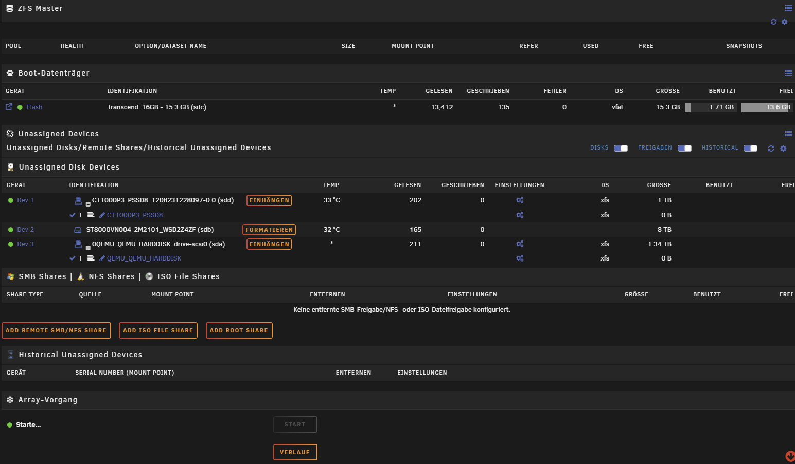

  4. I moved all data to the other disk. I created a new VM-Disk and changed them. I formated the new Disk with btrfs, when it was attached to the Array. Then the update to 7.1.2 was no problem. Then I moved my data back.
  5. the problem still exists, that there is the fdisk error and while the array was broken, the disks appeared as unassigned drives, there I could do a file system check, which was with errors for disk1 and the fix option, didn't work. So I would like to repair this mess, so that next updates will work without trouble.
  6. That's why I asked If I should keep the disk setting with new config. I'm not doing new configs on a daily base, so I'm not familar with it. Right now I'm moving all stuff vom disk1 to disk3. When done, I'll kill disk1 and recreate it. Mabe also with BTFRS instead of XFS

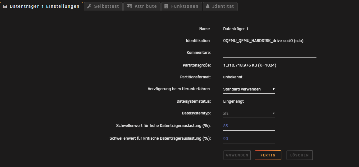

  7. back on 7.0.1 I made all config manually new to the disk assignment, but there is still the fdisk size error. Wouldn't it be good to fix this?

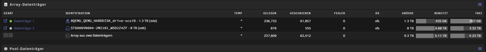

  8. after downgrade and new config it's still a complete broken mess
  9. Doesn't really look good at all.
  10. I'm confused, I thought, this is all available inside this partition. Nevertheless, how can I fix the partition size, best without restoring backups
  11. My partition is also 1,3 TB 🙈 can I fix this before the update or just update an create a new config? Do I need to keep disk settings with new config?
  12. this is the output from 7.0.1 Disk /dev/sda: 1.22 TiB, 1342177280000 bytes, 2621440000 sectors Disk model: QEMU HARDDISK Units: sectors of 1 * 512 = 512 bytes Sector size (logical/physical): 512 bytes / 512 bytes I/O size (minimum/optimal): 512 bytes / 512 bytes Disklabel type: dos Disk identifier: 0x00000000 Device Boot Start End Sectors Size Id Type /dev/sda1 2048 1048575999 1048573952 500G 83 Linux
