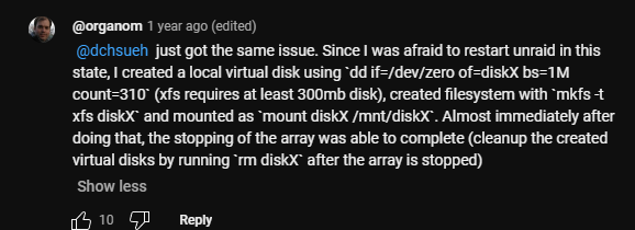

October 9, 20242 yr ran into this problem while trying to shrink my array using the SI video with zeroing the drive.. getting this reoccurring so the array wont stop Oct 8 20:59:07 FatJoe emhttpd: shcmd (315265): umount /mnt/disk8 Oct 8 20:59:07 FatJoe root: umount: /mnt/disk8: not mounted. Oct 8 20:59:07 FatJoe emhttpd: shcmd (315265): exit status: 32 Oct 8 20:59:07 FatJoe emhttpd: shcmd (315266): umount /mnt/disk10 Oct 8 20:59:07 FatJoe root: umount: /mnt/disk10: not mounted. Oct 8 20:59:07 FatJoe emhttpd: shcmd (315266): exit status: 32 Oct 8 20:59:07 FatJoe emhttpd: Retry unmounting disk share(s)... Oct 8 20:59:12 FatJoe emhttpd: Unmounting disks... Oct 8 20:59:12 FatJoe emhttpd: shcmd (315267): umount /mnt/disk8 Oct 8 20:59:12 FatJoe root: umount: /mnt/disk8: not mounted. Oct 8 20:59:12 FatJoe emhttpd: shcmd (315267): exit status: 32 Oct 8 20:59:12 FatJoe emhttpd: shcmd (315268): umount /mnt/disk10 Oct 8 20:59:12 FatJoe root: umount: /mnt/disk10: not mounted. Oct 8 20:59:12 FatJoe emhttpd: shcmd (315268): exit status: 32 Oct 8 20:59:12 FatJoe emhttpd: Retry unmounting disk share(s)... Oct 8 20:59:17 FatJoe emhttpd: Unmounting disks... tried running the 2nd command but it wont work root@FatJoe:~# /mnt# lsof | grep disk10 bash: /mnt#: No such file or directory root@FatJoe:~# lsof | grep disk10 root@FatJoe:/mnt# lsof | grep disk10 root@FatJoe:/mnt# 2nd command not coming back with anything Edit2: fix the loop from SI comments Edited October 9, 20242 yr by ToXIc
