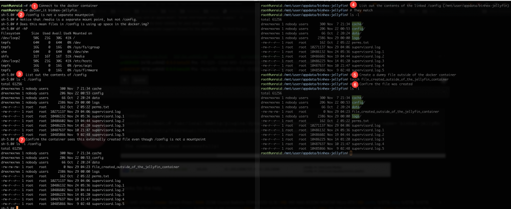

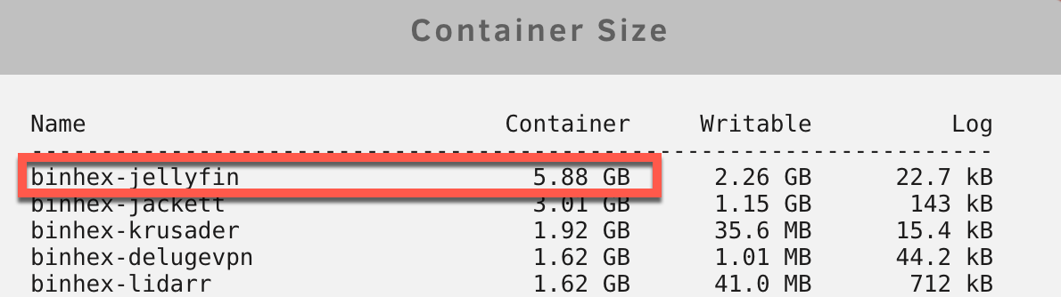

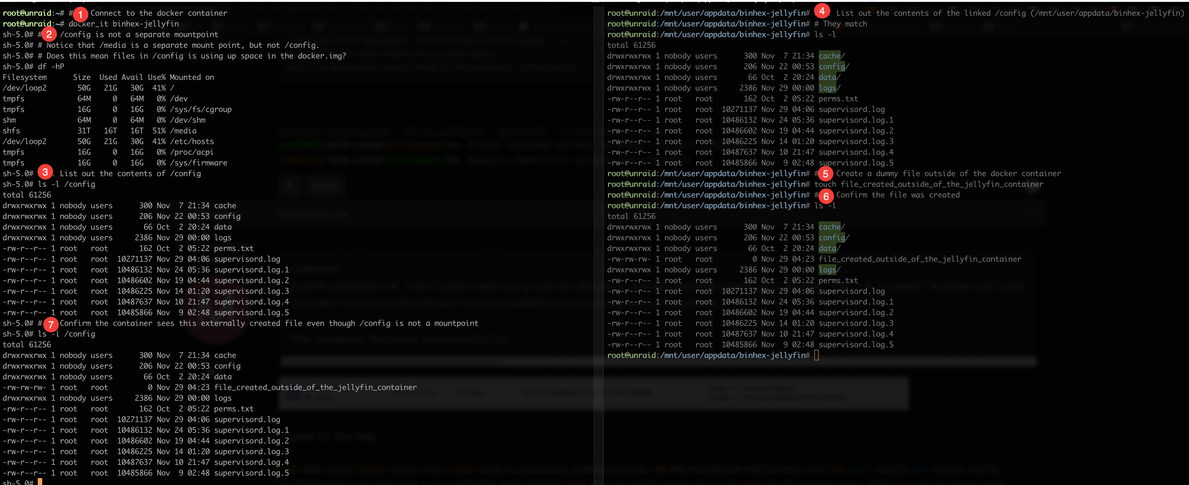

  14. TL:DR I'm finding a hard time finding my config/mapping issues to show that a 20GB of used docker.img is unreasonable with 29 containers. BTW, it seems many of my syslog errors went away after disabling daily plugin checks and disable/re-enable ipmi. I've since re-enabled daily plugin checks and the errors have not come back. I read it could have been related to being unable to connect to github if it had an outage or some other routing issues. Checked what is using up the 5.88GB in the container, but see it's only using up 3.6GB instead. Where is the other ~2.2GB coming from? I see "Writable" is roughly this size of ~2.2GB. Where is this 2.2GB coming from? The only location that's big enough to be considered in the local filesystem is in /home, as there are no other directories large enough to account for the 2.2GB. sh-5.0# find / -maxdepth 1 -mindepth 1 -type d \! -exec mountpoint -q {} \; -exec du -xshc {} + | sort -h 0 /boot 0 /mnt 0 /opt 0 /run 0 /srv 4.0K /.gnupg 12K /root 24K /tmp 8.1M /etc 14M /var 1.5G /usr 2.2G /home # <---------------------- 3.6G total Inside home is just a user called nobody. The files in here do not appear to be user-created files from the application. sh-5.0# cd /home sh-5.0# ls -la total 0 drwxr-xr-x 1 root root 12 Sep 2 01:12 . drwxr-xr-x 1 root root 206 Nov 29 04:06 .. drwxrwxr-x 1 nobody users 130 Nov 29 04:08 nobody sh-5.0# cd nobody/ sh-5.0# ls -la total 8 drwxrwxr-x 1 nobody users 130 Nov 29 04:08 . drwxr-xr-x 1 root root 12 Sep 2 01:12 .. drwxrwxrwx 1 nobody users 38 Nov 29 04:06 .aspnet -rw------- 1 root root 581 Nov 29 04:23 .bash_history drwxrwxr-x 1 nobody users 34 Sep 5 11:32 .cache drwxrwxr-x 1 nobody users 6 Sep 5 11:29 .config drwxrwxr-x 1 nobody users 220 Sep 5 11:35 .dotnet drwxrwxr-x 1 nobody users 10 Sep 5 11:36 .local drwxrwxr-x 1 nobody users 26 Sep 5 11:36 .nuget -rwxrwxr-x 1 nobody users 467 Sep 5 11:28 start.sh drwxrwxr-x 1 nobody users 6 Sep 5 11:32 .yarn sh-5.0# find . -maxdepth 1 -mindepth 1 -type d \! -exec mountpoint -q {} \; -exec du -xshc {} + | sort -h 0 ./.yarn 4.0K ./.aspnet 4.0K ./.config 12K ./.dotnet 254M ./.local 639M ./.cache 1.3G ./.nuget 2.2G total Using mountpoint, I found that /config is actually a mountpoint, even though it doesn't appear as one using df. sh-5.0# mountpoint /config /config is a mountpoint sh-5.0# mountpoint /media /media is a mountpoint sh-5.0# mountpoint /home /home is not a mountpoint sh-5.0# mountpoint /usr /usr is not a mountpoint

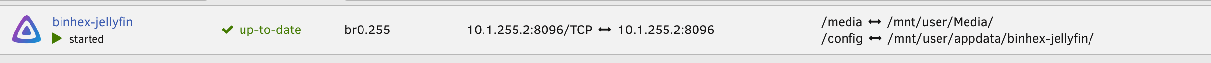

  15. Command: root@localhost:# /usr/local/emhttp/plugins/dynamix.docker.manager/scripts/docker run -d --name='binhex-jellyfin' --net='br0.255' --ip='10.1.255.2' -e TZ="America/Los_Angeles" -e HOST_OS="Unraid" -e 'TCP_PORT_8096'='8096' -e 'UMASK'='000' -e 'PUID'='99' -e 'PGID'='100' -v '/mnt/user/Media/':'/media':'rw' -v '/mnt/user/appdata/binhex-jellyfin/':'/config':'rw' 'binhex/arch-jellyfin' 52e486470c7c51a7f66090a6170f549a9e6b885ce943f28f32fe23cc43cd5358 The command finished successfully! I tested if the container's /config is really mapped to /mnt/user/appdata/binhex-jellyfin. The test below shows that it is mapped, even though /config is not seen as a mountpoint in the container (df -hP). Thanks for the help.
