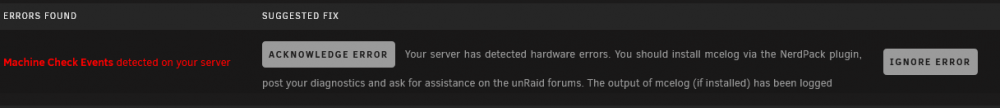

July 2, 20188 yr Author Anyone? I keep getting this message and Google doesn't seem to be any help whatsoever. Your server has detected hardware errors. You should install mcelog via the NerdPack plugin, post your diagnostics and ask for assistance on the unRaid forums. The output of mcelog (if installed) has been logged

December 16, 20205 yr Similar error for me, except for AMD Processor family 25 (5600x). Fix Common Problems alerts on it because of the message added to mcelog. Can we safely ignore this error as AMD users? Full message: "mcelog: ERROR: AMD Processor family 25: mcelog does not support this processor. Please use the edac_mce_amd module instead."
December 17, 20205 yr 22 hours ago, Resviole said: Fix Common Problems alerts on it because of the message added to mcelog FCP won't alert on that message. It will alert on an MCE being logged (which is the only time that message arrives). If the mce happens during processor initialization, then it's nothing at all to worry about as that affects certain combinations of hardware from time to time.
