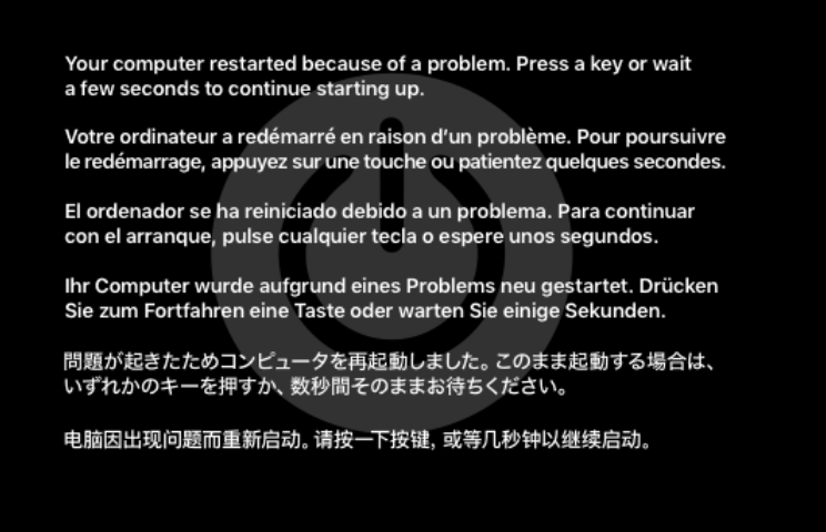

  3. I got a new computer with AMD 5600U, and my Mac VM wont' work anymore, I have tried to do a clean install, but I cannot even get into the format disk part, when I run it, it keeps rebooting. When I checked the log, I got this: -cpu Penryn,kvm=on,vendor=GenuineIntel,+kvm_pv_unhalt,+kvm_pv_eoi,+hypervisor,+invtsc,+pcid,+ssse3,+sse4.2,+popcnt,+avx,+avx2,+aes,+fma,+fma4,+bmi1,+bmi2,+xsave,+xsaveopt,+rdrand,check \ -sandbox on,obsolete=deny,elevateprivileges=deny,spawn=deny,resourcecontrol=deny \ -msg timestamp=on char device redirected to /dev/pts/14 (label charserial0) 2022-06-25T17:05:38.958203Z qemu-system-x86_64: warning: host doesn't support requested feature: CPUID.01H:ECX.pcid [bit 17] 2022-06-25T17:05:38.958268Z qemu-system-x86_64: warning: host doesn't support requested feature: CPUID.80000001H:ECX.fma4 [bit 16] 2022-06-25T17:05:38.959351Z qemu-system-x86_64: warning: host doesn't support requested feature: CPUID.01H:ECX.pcid [bit 17] 2022-06-25T17:05:38.959365Z qemu-system-x86_64: warning: host doesn't support requested feature: CPUID.80000001H:ECX.fma4 [bit 16] qxl_send_events: spice-server bug: guest stopped, ignoring When I checked the Unraid syslog, I noticed this: Jun 22 11:44:34 server mcelog: ERROR: AMD Processor family 25: mcelog does not support this processor. Please use the edac_mce_amd module instead. Is that the reason? thanks

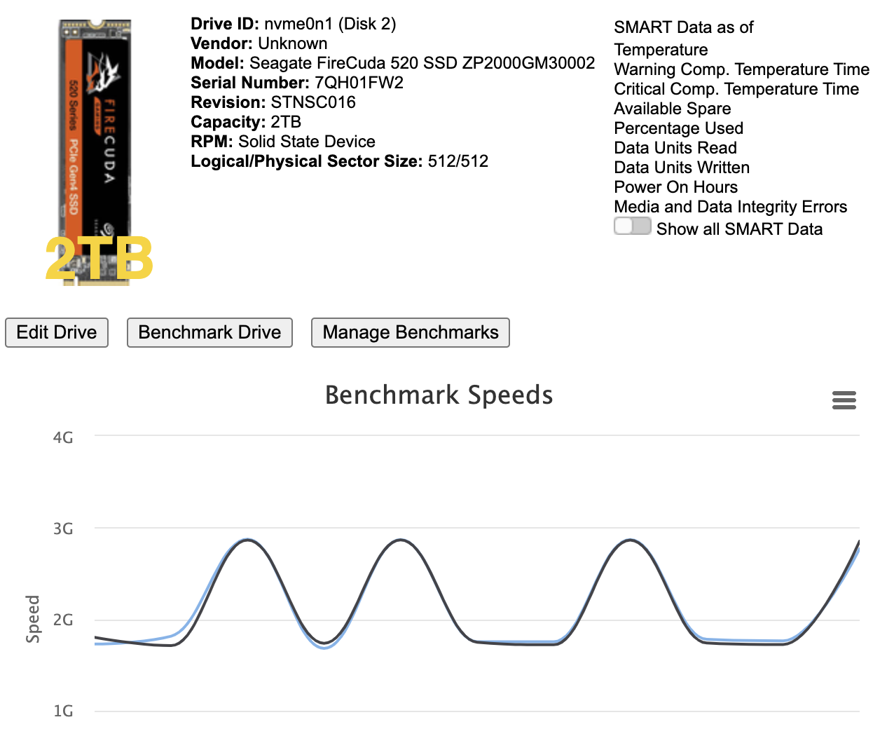

  4. @jbartlett I am testing a few of my NVMe SSDs, and this one is quite stronage, Seagate FireCude 520, the speed was going up and down. Do you think I should replace this SSD? this one is a brand new one, can be on PCIe4, but I only have a PCIe3, so the speed was downgraded. but I should not been seeing up and down like this, right? I think something wrong with the brand new drive?

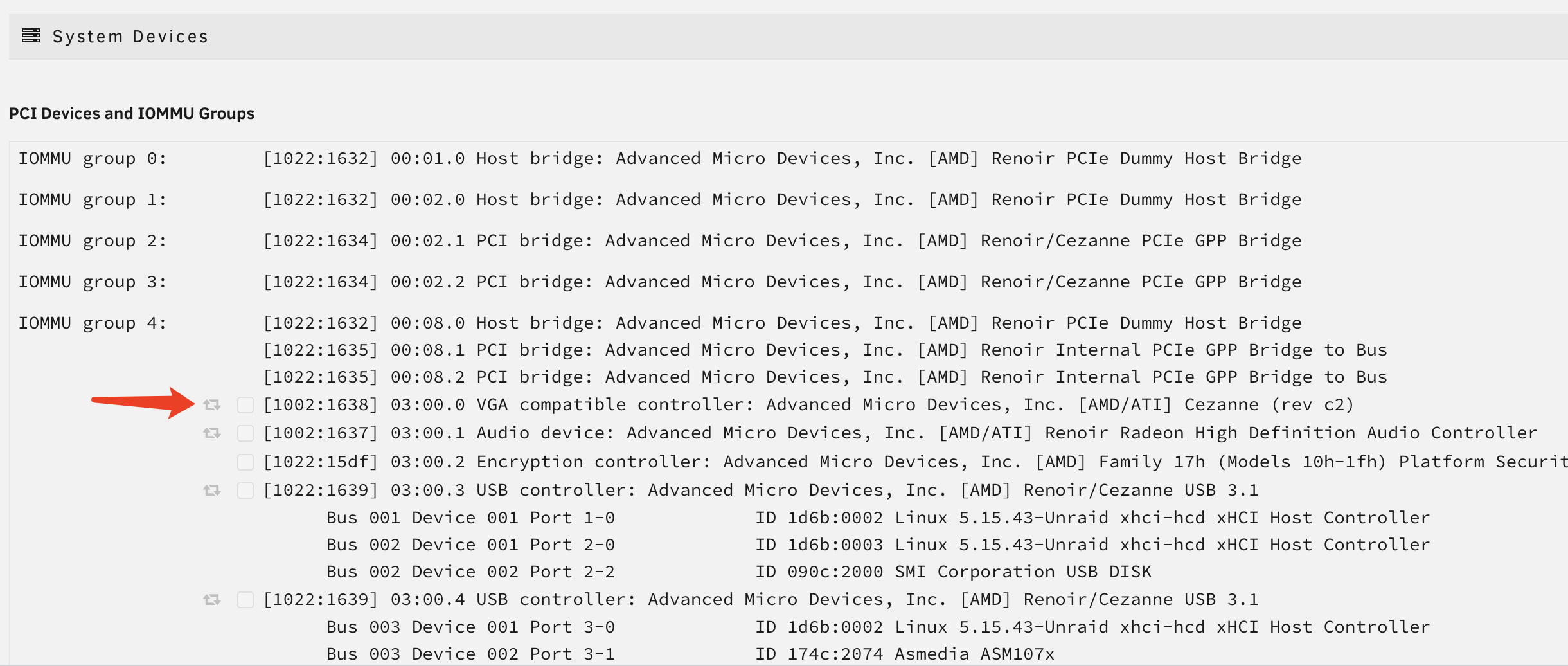

  7. you are right, I enabled PCIe ACS Override on VM Manager page. then I can see my AMD igpu graphic card now. However, when I injected this card into my windows VM. I can get my VM boot up sucessfully, but no output on my monitor. I am thinking if I should setup vbios on my integrated amd grahic card.

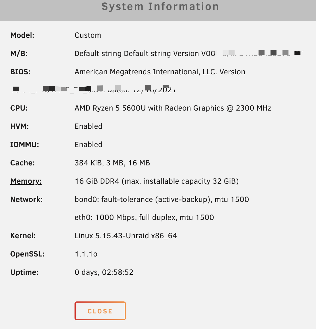

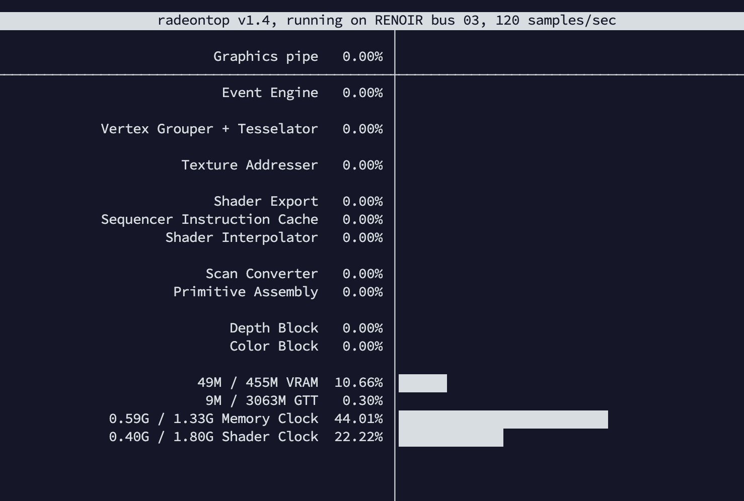

  8. Hi, I have AMD 5600U with the integrated graphic card Radeon RX Vega 7, and I have enabled the HVM & IOMMU inside my BIOS, however I still see my graphic card greyed out and cannot let it passthrough? I am on 6.10.2, and I installed Radeon TOP. I can see that my GPO is functioning if I use /dev/dri on my docker apps. thanks
