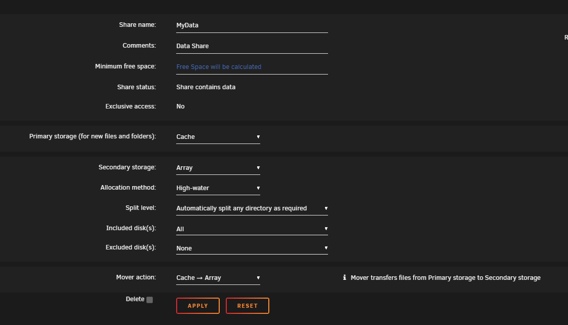

  2. kinda weird that its set to Array but its going to cache.. i see filed from last night in there

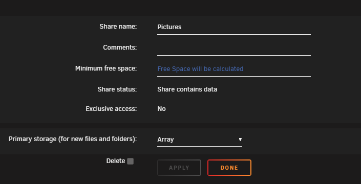

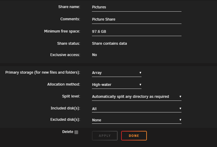

  3. so it showed up like this added a description and now its like this was this because of the 7.0 upgrade? edit: should i change to this?
  4. Everything in MyData Pictures
  5. having issues with mover.. shows it ran but there is no reduction in cache size.. rebooted and tried again no change. enabled logging and downloaded dig, please see attachment. i browsed the cache folders and it definitely have data that should be moved off. fatjoe-diagnostics-20250210-1116.zip

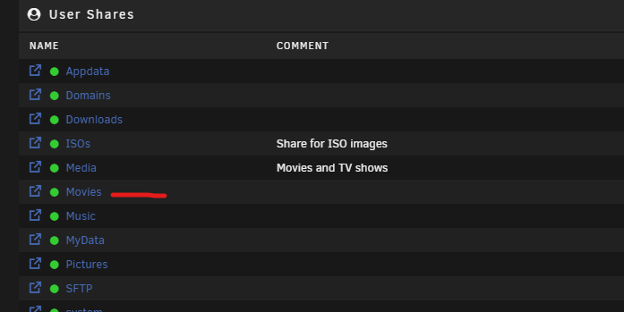

  7. what the heck.. lol looking over the server this am and the movies share is back... lol zombie share.. i even opened my browser in incognito mode and its showing up.. ill put a desc. do not use lol
  8. *zips up flame suite* ok roast me. i truly dont know why/when i changed the mapping to the legacy location.. i activated the legacy share and used MC to move the files off then remapped the dockers and stuff is showing up.. smh sry guys thx for your time. ive deleted the legacy share after moving the files hopefully it wont happen again
  9. i swear to god i hate myself... i think i know whats going on now.. im effing loosing my mind.. its a theory.. looking at my shares i dont even see Movies listed as being shared.. i guess it once existed back in the day (this server been around since v4.3 i believe) so the dockers are configured to use "Movies" back end loc and its copying media to those folders, i can see new media it Movies in the file browser, and "media" share have all the legacy media. i think i need to turn this share and move the files to media then remap the dockers, sonarr and radarr to /mnt/user/media/HD and TV from /mnt/user/movies then remove that share i rly dont know when I may have change sonarr and radarr. and why i would off? but above makes sense to me
