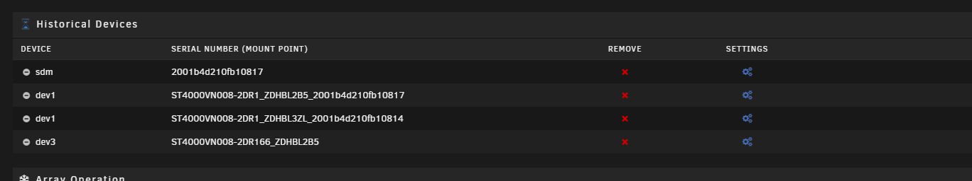

i also have this new section since all this occurred
If you formatted an unmountable disk it deletes all the data, the usual solution for that is check filesystem, do you still have the old disk?
Historical devices are from the UD plugin, but they can be safely removed.
