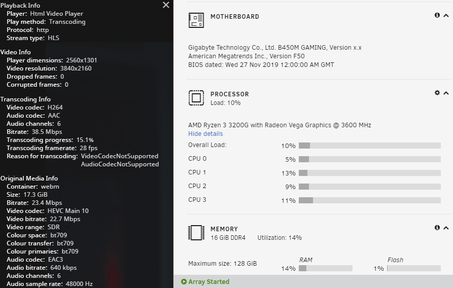

  • Resolved: For now, you have to choose "VA API" as the transcoder and NOT Intel Quick Sync Video. Totally confusing and frustrating but VA API definitely works. I confirmed it is hitting QSV with the I
  • linuxserver.io
    linuxserver.io
    We've made it easier to get Nvidia & iGPU hardware trancoding working with this container.  This post will detail what you need to do to use either of these in your container.   Nvidia
  • Thanks guys, its working!   Here is what I did if anyone else has trouble

I finally got vaapi transcoding working for the AMD 3200G on unraid for this docker image of jellyfin. Thanks for the image.
If anyone needs to know how I can write up what I did.
APU usage on vaapi transcoding a 4k video between 10-20%. This is very good for a small processor.
Previously without hardware accelerated transcoding 4 threads on 90% (software)
