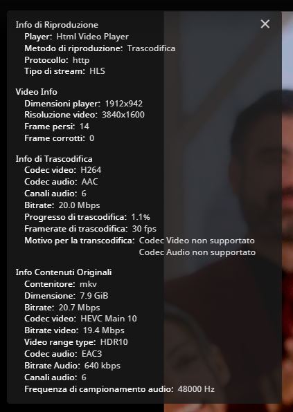

Hi guys, I have just installed this docker and I'm trying to enable the hw transcoding.
I have an Intel Pentium Gold G6405 (Comet Lake-S) with an UHD 610 as iGPU.
I have added the --device=/dev/dri:/dev/dri as an extra parameter and also I've added the docker mod for OpenCL-Intel.
All seems to work but there is something weird that I can't understand.
When I try to play a 4K HEVC HDR with Microsoft EDGE the hw transcoding seems to work but if I watch the system resources I see the CPU at 100% and the GPU at 20-30%:
These are the playback infos:
And this is my configuration:
This is the FFMpeg log:
/usr/lib/jellyfin-ffmpeg/ffmpeg -analyzeduration 200M -init_hw_device vaapi=va:,driver=iHD,kernel_driver=i915 -init_hw_device qsv=qs@va -init_hw_device opencl=ocl@va -filter_hw_device ocl -autorotate 0 -i file:"/data/tvshows/Gen V/Season 1/Gen V - S01E01 - God U WEBDL-2160p.mkv" -map_metadata -1 -map_chapters -1 -threads 0 -map 0:0 -map 0:1 -map -0:s -codec:v:0 h264_qsv -preset 7 -look_ahead 0 -b:v 19371572 -maxrate 19371572 -bufsize 38743144 -g:v:0 72 -keyint_min:v:0 72 -vf "setparams=color_primaries=bt2020:color_trc=smpte2084:colorspace=bt2020nc,scale=trunc(min(max(iw\,ih*a)\,min(3840\,1600*a))/2)*2:trunc(min(max(iw/a\,ih)\,min(3840/a\,1600))/2)*2,format=yuv420p" -codec:a:0 libfdk_aac -ac 6 -ab 640000 -copyts -avoid_negative_ts disabled -max_muxing_queue_size 2048 -f hls -max_delay 5000000 -hls_time 3 -hls_segment_type mpegts -start_number 0 -hls_segment_filename "/config/data/transcodes/39574ced94177e1670d475db775b4b91%d.ts" -hls_playlist_type vod -hls_list_size 0 -y "/config/data/transcodes/39574ced94177e1670d475db775b4b91.m3u8"
Stream mapping:
  Stream #0:0 -> #0:0 (hevc (native) -> h264 (h264_qsv))
  Stream #0:1 -> #0:1 (eac3 (native) -> aac (libfdk_aac))
Press [q] to stop, [?] for help
Output #0, hls, to '/config/data/transcodes/39574ced94177e1670d475db775b4b91.m3u8':
  Metadata:
    encoder         : Lavf59.27.100
  Stream #0:0: Video: h264, nv12(tv, bt2020nc/bt2020/smpte2084, progressive), 3840x1600 [SAR 1:1 DAR 12:5], q=2-31, 19371 kb/s, 23.98 fps, 90k tbn (default) (original)
    Metadata:
      encoder         : Lavc59.37.100 h264_qsv
    Side data:
      cpb: bitrate max/min/avg: 19371572/0/19371572 buffer size: 38743144 vbv_delay: N/A
  Stream #0:1: Audio: aac, 48000 Hz, 5.1, s16, 640 kb/s (default)
    Metadata:
      encoder         : Lavc59.37.100 libfdk_aac
Can you help me to understand why there is so a huge use of the CPU even if the hw transcoding seems to work?

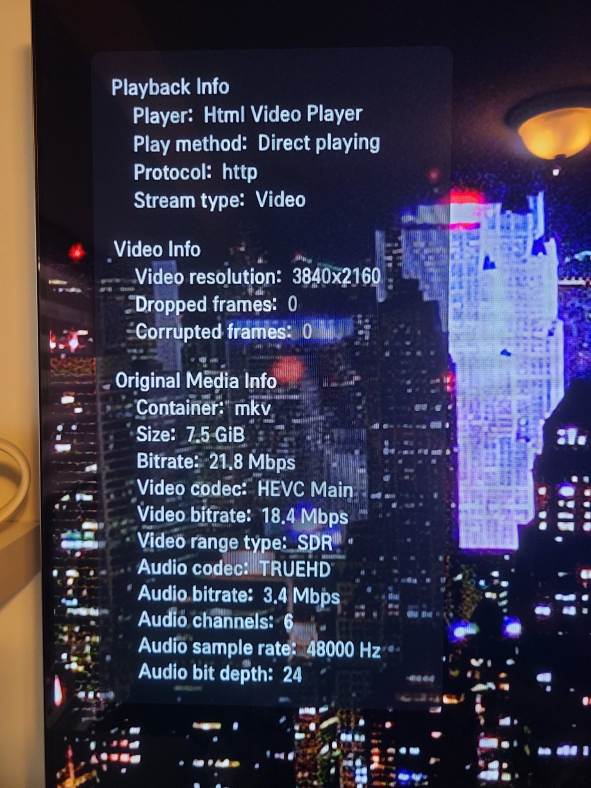

Hey hey! After updating to the latest release (10.8.11-1-ls228), there is no longer any sound output on WebOS when playing mkv files with the TRUEHD audio codec. Before updating, the audio from the same files played without a problem. See the attached image for file details.
Client stack is the Jellyfin app (date version 19/03/2023) on a WebOS TV running v7.3.1-39.
It seems like the problem is on the client side because I can play the same file, hosted on the same server, in the browser on my computer without a problem.
Is there a way to simply pin to a previous docker release? If yes, I'm good with that approach for now, because it worked with the previous version, but need advice on how to do it.
Otherwise any other suggestions would be appreciated! Thanks in advance :)

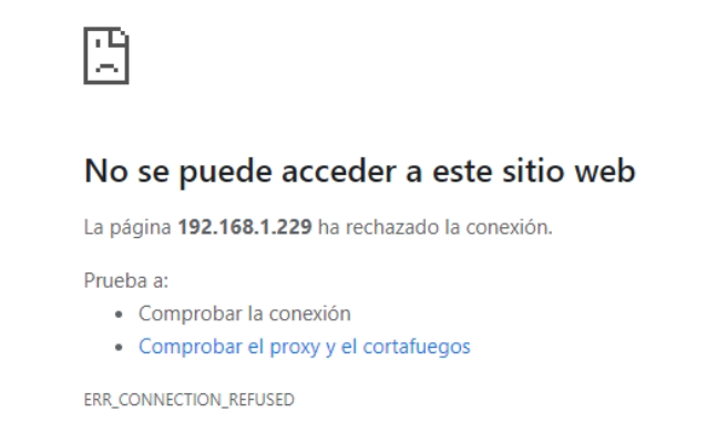

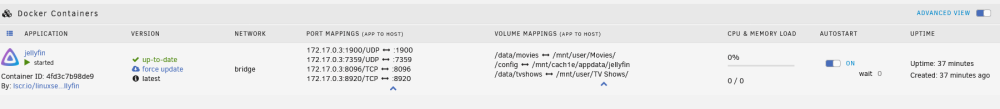

I am having a frustrating issue with the WebGui not opening a webpage.  When I try to access the WebGui i get a blank web page with "about:blank#blocked".  The app was working for a week or so, I was able to setup my media libraries and watch shows on my jellyfin clients.  I just cant access the webgui from my windows PC or my tablet which was no problem before.  I have disabled every security barriers on all my web browsers (chrome, firefox, brave and edge) with no luck.  I have added web IP addresses as trusted site.  I have shutdown & restarted server.  Unistalled jellyfin and reinstalled (along with all  my other containers) still get "about:blank#blocked".  Now since i uninstalled and reinstalled jellyfin I cant access the webgui and I am unable to acces jellyfin from any of my clients.  I've been at this for roughly 5 days and I am out of ideas.

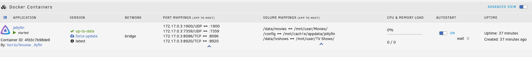

I'm hoping you can help. I've attached the jellyfin logs from when I last installed jellyfin container.
Here also is a screen shot of my container basic stats
Thanks for any help
Tim N
Jellyfin container Log - new instal.txt
This thread "about:blank#blocked for all WebUI links" By Alexstrasza gave me new info.  The container CA form has a generic WebUI address of http://[IP]:[PORT:8096].  Change this to the generic address to the actual hard address eg. http://192.168.0.5:8096, this gave me a Timeout error but it is a change.  The 2 addresses I find for jellyfin are the JELLYFIN_PublishedServerUrl: and the Port Mapping ip addresses.  Both of these address give me a timeout error.  Is there a different ip address that I should be using for jellyfin WebUI?
Thanks
Tim N
Finally got it figured out, going over Network Access again, I saw a little note saying network must be on "eth0"; lght bulb went off. I had taken apart my build again to add some fans and put it all back together & I hooked up my lan cable to the wrong port, its always the small things.
Tim N

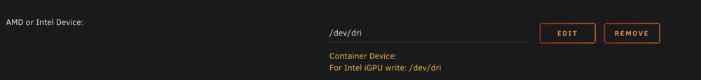

How do I get the iGPU working on the i5 8400 with UHD Graphics 630? I have Intel_GPU_TOP plugin but it's not working. Unraid version is 6.12.10 and jellyfin version is 10.8.13-1-ls9.

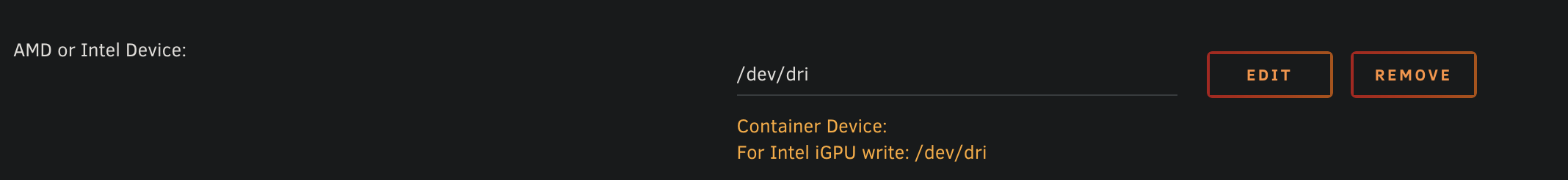

I believe you need to add this line to the container settings.
Is that supposed to be there by default? or could you press edit so I can see how it's setup?
If I remember correctly, when I installed Hotio's Jellyfin container about two years ago, this setting line was there by default.
But from what I see now, new container installs don't have this setting by default.
