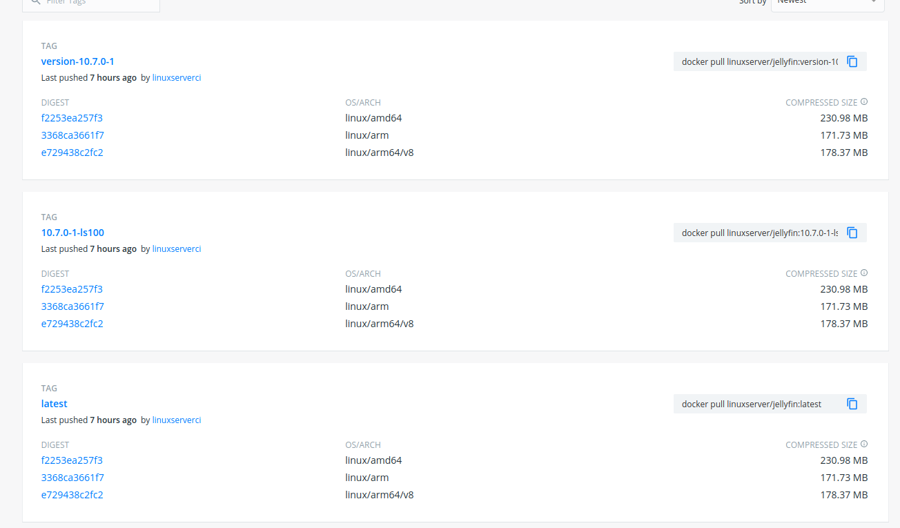

It would be great if you could push a 10.7.0-rc tag. Thanks
We have nightly builds.
I'm not comfortable running potentially unstable (more so than an rc release) builds where there may be daily changes that break compatability with external clients and plugins, as was seen during the time waiting for 10.7.0-rc1. Regardless it's your decision so no worries :D

This only affects manually requesting a library scan, Jellyfin still adds media from watching changes to directories. This has occured on 10.6.4, and still on 10.7.0. Thanks
Sounds like a bug in Jellyfin. We set /config/data as the data for and for some reason Jellyfin doesn't care about that for that file.
Jellyfin 10.7.0 was released a couple days ago but Unraid is not prompting for an update and Jellyfin is still on 10.6.4
Edited by 007craft
The container was updated a couple hours after it was released
