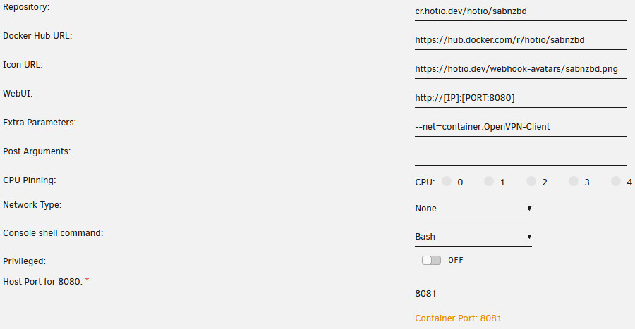

  1. I tried this and I believe the port did change but now I cannot access the container anymore. Not on port 8080 or on port 8081. The template changed to show container port8081 but this is not reflected in the port's listed on the unraid docker tab. I hope I have some time tonight to test some more.
  2. I am not able to check now, no remote access from work to the server. But I did notice that when I change the port through the webui of SABnzbd the container does restart but it changes the port back to 8080 in the webui. I think that port is hard-baked in the template or something? I will try do to this procedure on the other the qbit container, maybe I can change the port there. I understand what we are trying to do, I think

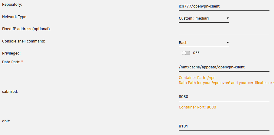

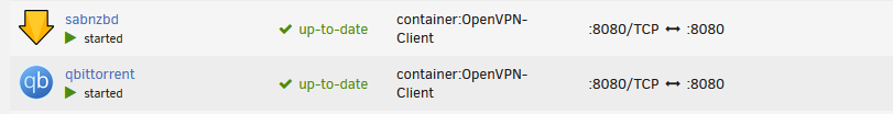

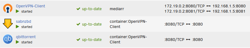

  3. No luck. I followed the steps and the port on Sabnzbd did change but I still cannot connect to it through OpenVPN. See the screenshot below, the port remains :8080/TCP

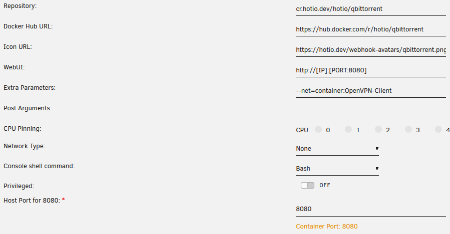

  4. @ich777 Could you please help me with the following. I have two containers that I want to network through the OpenVPN container but they both use the same container port: 8080. I tired to change one of them to use 8181 but no luck. See screenshots: Any help is much appreciated.
