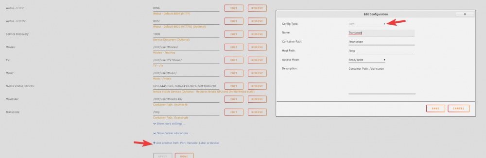

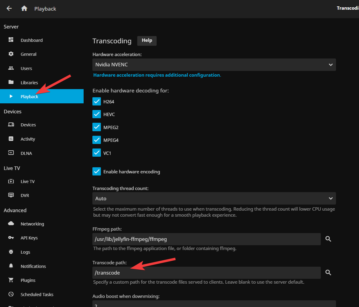

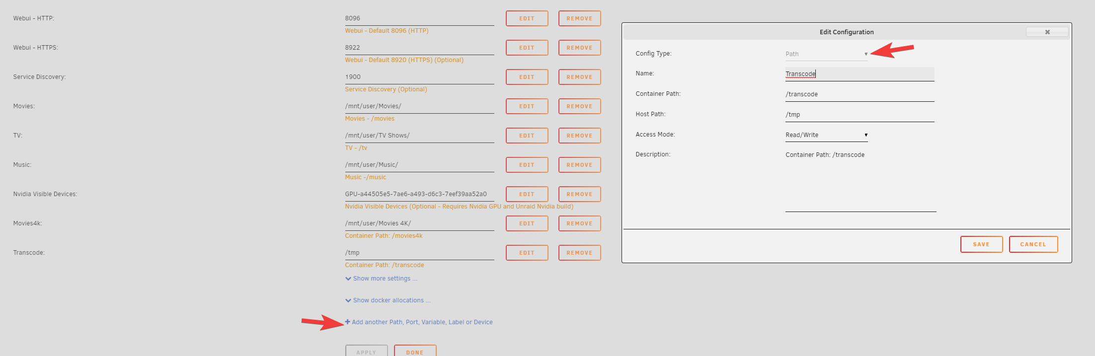

I have the latest jellyfin installed using unRaid nvidia 6.8.3.  I followed the instructions with the Docker setup to use my 1650 Super.  I used the same instructions with Plex and Emby and they can both transcode using my video card, but Jellyfin cannot. I confirmed this by running watch nvidia-smi.   When I go and enable nVidia NVENC and check the boxes, it won't even save, I get this error "There was an error processing the request. Please try again later."
Anything else I can try?
EDIT - Figured it out, had to create and change the path for transcode.  Now it works.

So probably making this way more complicated then it should be. For transcoding dir there is no transcoding location variable in docker.
Would I need to manually add a path with the container path and host path as /tmp ?
If you don't have a path for transcode under edit of jellyfin docker then just add one named Transcode, container path: /transcode, host path: /tmp
/transcode for path in jellyfin transcoding settings path
Edited by jpowell8672
