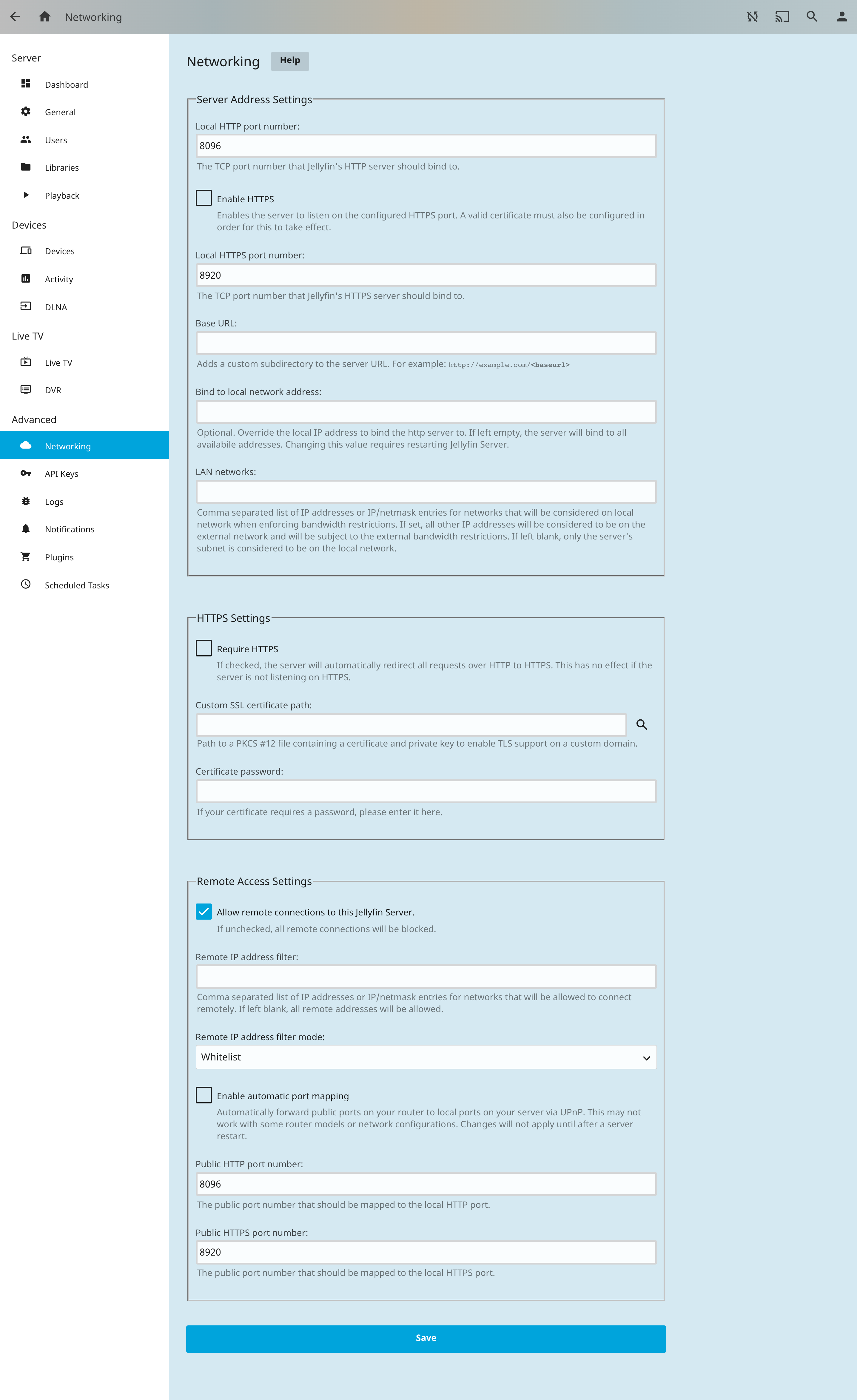

Hi
Not sure if i am being a complete tool, but trying to setup the SSL and get to the bit where it states " Goto Dashboard - Network and set Secure settings mode dropdown to -handled by proxy"
Thing is, for the life of me i cannot see that option anywhere in the settings panel via webui.
34 minutes ago, thering1975 said:
Hi
You don't see the network settings if you go to the server settings?
I see network settings what i do not see is what is quoted in the JF Wiki the dropdown for setting the ssl to be handled by reverse proxy
From the wiki
What do you see?
1 hour ago, saarg said:
What do you see?
See below, interestingly i fired up an Emby instance and that setting is there in Emby, just not in JF
I have Emby setup perfectly with reverse proxy so i am all good now and this is now just for info
They have probably changed stuff, but forgot to change it in the wiki. I have not tested it here, just know it from emby.
Just for info, you were right that option was no longer needed and it is the wiki out of date.
Just mimicked the principal of the LE config for Emby to Jellyfin, only thing that needed changing was the public https port to 443  in the dashboard and boom, reverse proxy working fine and JF running under ssl on the subdomain.
