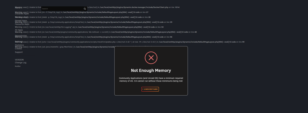

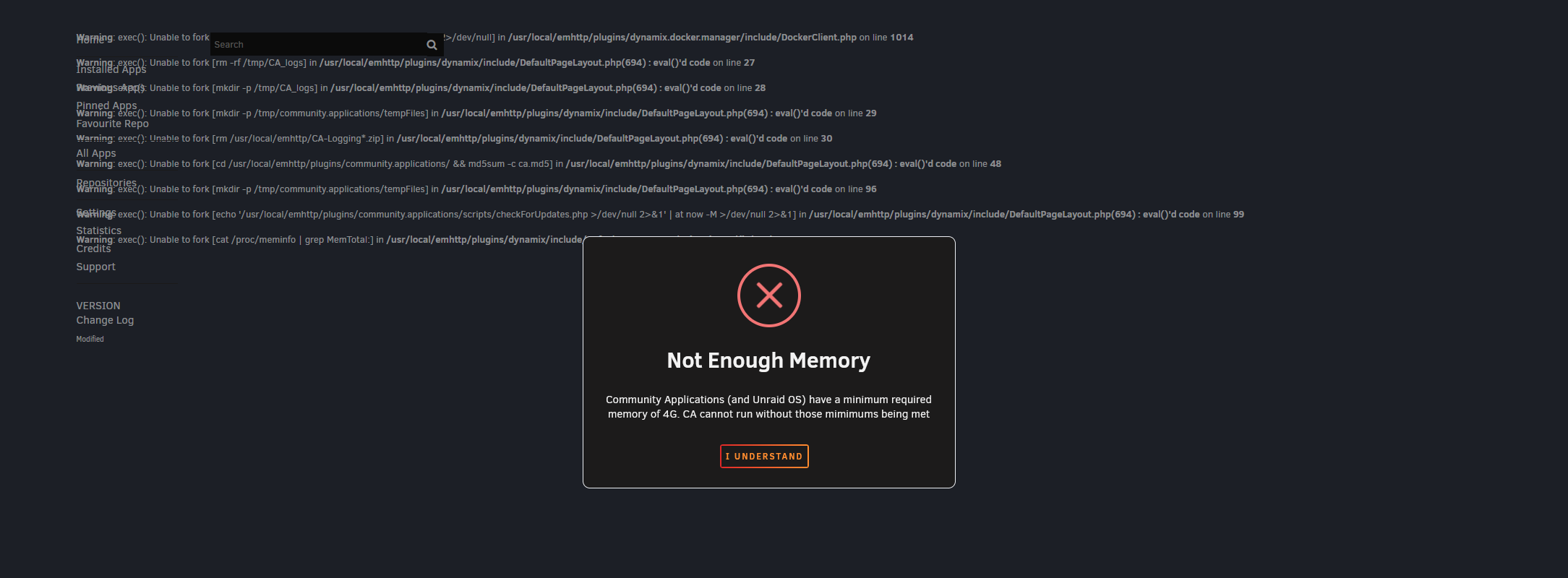

  12. Tried disabling C-states and no help, just failed again. I managed to somewhat load part the apps page and got this message. Why am I out of memory? I have 64 GB of ram on this machine, and usually only 30% is in use. OR is this just a generic message from some other failure?

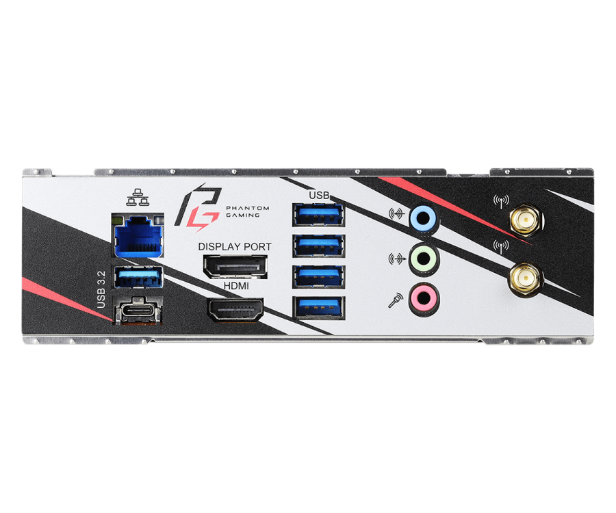

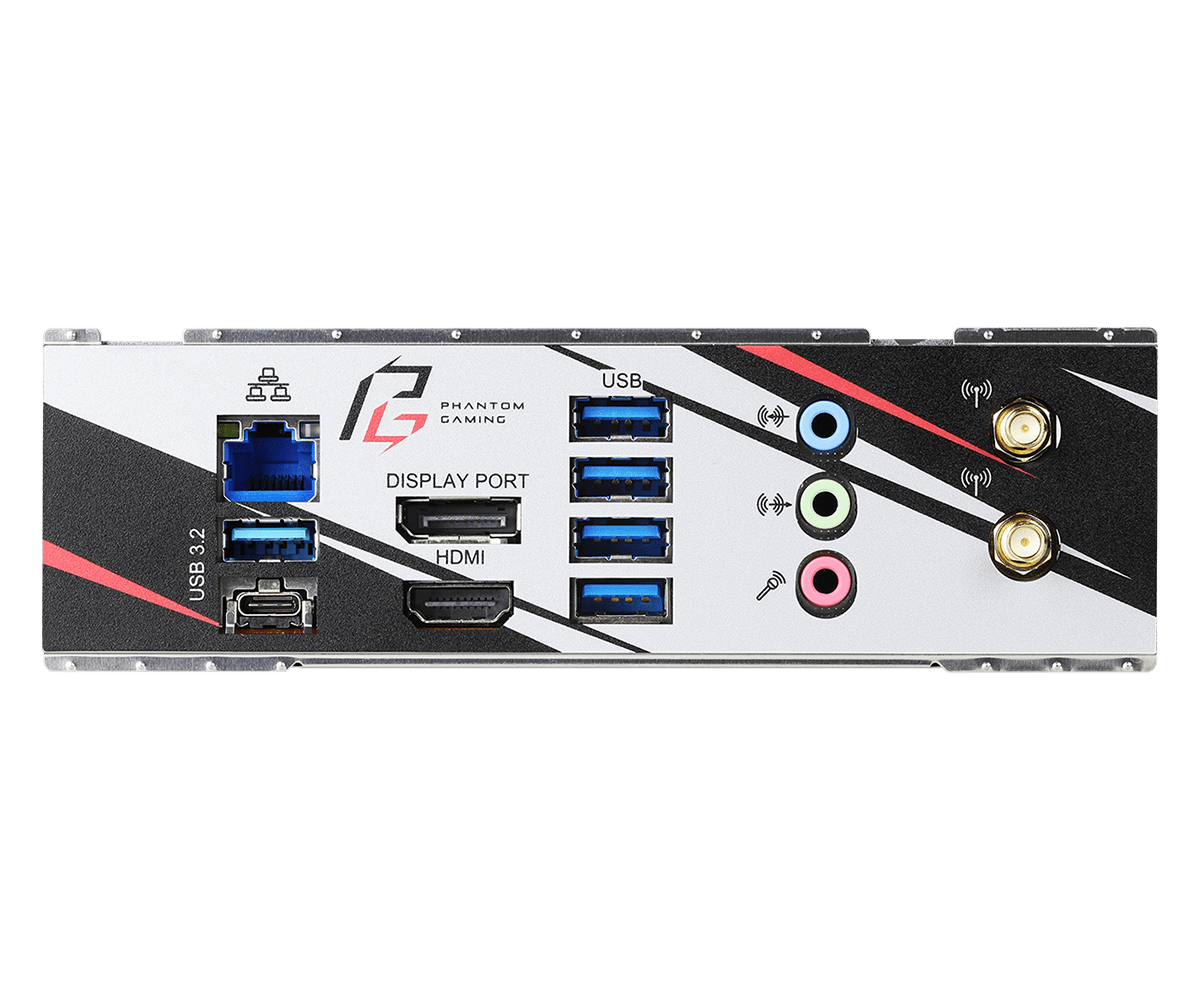

  13. Its an Asrock B550 Itx motherboard. It turns out there was an internal header. I bought a cable to get the USB 2.0 functionality from that internal header. So now Im running Unraid on USB 2.0 and on a USB 2.0 stick. The same problem continues to happen. Its happened 3 more times since I last posted. I dont have logs from the last 3 times cause my main computer died. But now I setup syslog server on my laptop which im on until I fix my main computer, so once it fails again ill have logs. But the symptoms of a fail remain the same: - Unraid is pingable - Cannot GUI or SSH into machine - Dockers stop working - Array contionues to work, Network shares are accessible - Hard reboot of powerbutton required to fix back to normal - Plugging in HDMI to use local command prompt, I just see a message saying out of resources and cant type anything. Now I have rebooted, heres some hardware info from my dashboard: Description UnRaid Server Custom Registration Unraid OS Plus Uptime 11 minutes Motherboard Temperature: ⋅⋅⋅ °C ASRock B550 Phantom Gaming-ITX/ax American Megatrends International, LLC., Version L2.61 BIOS dated: Tue 14 Feb 2023 12:00:00 AM PST Processor Load: 4%Temperature: 59.4 °C Processor Load: 6%Temperature: 58 °C AMD Ryzen 5 5600X 6-Core @ 3700 MHz Hide details Overall Load:6% CPU 0 - HT 62%19% CPU 1 - HT 76%4% CPU 2 - HT 81%9% CPU 3 - HT 93%5% CPU 4 - HT 106%7% CPU 5 - HT 112%2% Memory 64 GiB DDR4 Utilization: 22% Maximum size: 128 GiBRAM22%Flash22% Usable size: 62.7 GiBLog1%Docker48% Interface Inbound: 85.2 KbpsOutbound: 127.5 Kbps Mode of operation bond0fault-tolerance (active-backup), mtu 1500 bond1bond down eth02500 Mbps, full duplex, mtu 1500 loloopback Power UPS Model: Back-UPS RS 1500MS2 UPS Load: 144 W (16 %) UPS status:Online Battery charge:99 % Runtime left:44 minutes Nominal power:900 W Output voltage:- GPU Load: 0% Temperature: 43 °C   Processes: 0 NVIDIA GeForce GTX 1660 Ti  PCIe Gen (Max): 1 (3)  Lanes (Max): 16 (16) Load - Memory0%0% Encoder - Decoder0%0% GPU - Memory (MHz)300405 Fan - Power30%19W PCI Bus Rx/Tx (MB/s)00 Power State - ThrottlingP8Yes (gpu_idle) Active Apps
  14. i've tried 2 different flash drives One USB 3 and the other USB 2, in 5 different ports. There is no USB 2.0 ports on my motherboard, only 3.2 and 3.0
