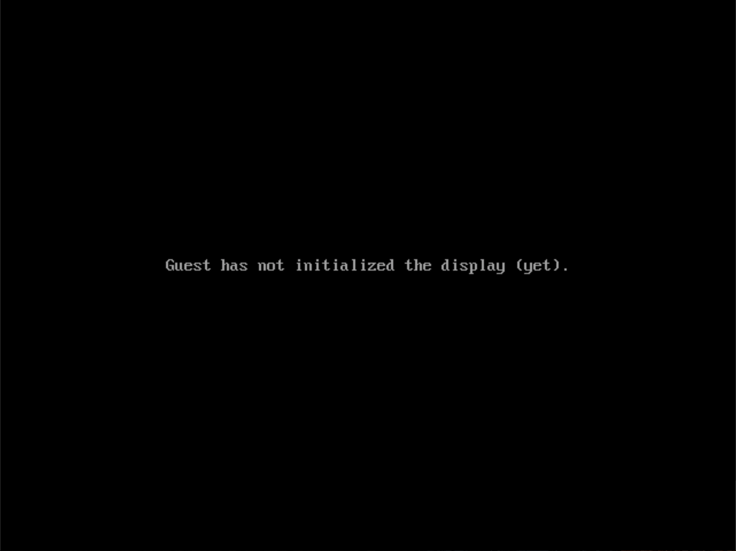

March 3, 20188 yr Hi everyone, I have been trying to setup a Ubuntu server install as a VM. After creating the VM and launching the browser VNC, all I get is a black screen with "Guest has not initialised the display (yet)". HVM is enabled, but my hardware does not support IOMMU. Any idea whats causing this? Using Unraid 6.4.1 and Ubuntu Server 16.04 Thank you!

August 1, 20197 yr ive tried all of the above and am still having the problem. this occurred to me after trying to pass through a GTX 770, not getting anywhere and setting it back to VNC. now no VMs can start. EDIT: creating a new VM and attaching the old disk fixed the problem. Not sure how much damage that does though. Try configuring 2 graphics displays in the VM config: VNC and the GPU Edited August 1, 20197 yr by isaacery

April 8, 20206 yr Hi, I have the same probs with that. Unraid 6.8.3. All Vm´s that switched from or to GPU Passthrough to VNC back have the problems. I find out that after switching the Grafik output the "bus" from 0x00 chnaged to 0x07. With these settings the vms dosen´t work. After change the bus back to 0x00 the vm works fine. If the bus 0x00 is occupied, change the slot to 2 or 3. Sorry for my bad english :-) <model type='qxl' ram='65536' vram='65536' vgamem='16384' heads='1' primary='yes'/> <address type='pci' domain='0x0000' bus='0x00' slot='0x01' function='0x0'/>

August 2, 20206 yr For me the solution earlier mentioned by isaacery was to create a new VM with exact the same configuration as the one which does not work (with the primary vDisk location pointing to the correct old disk). The new VM booted instantly without any problems. My problem started when I changed the Graphic card from VNC to the GPU (and back again as the VM did not start anymore). In VNC I got the message "Guest has not initialized the display (yet)".
January 12, 20215 yr Just had this same issue with "guest has not initialized the display (yet)", deleting the VM (keeping the image) and re-creating fixed it. Thanks.
February 3, 20215 yr On 4/8/2020 at 5:43 PM, Ghostly2002 said: Hi, I have the same probs with that. Unraid 6.8.3. All Vm´s that switched from or to GPU Passthrough to VNC back have the problems. I find out that after switching the Grafik output the "bus" from 0x00 chnaged to 0x07. With these settings the vms dosen´t work. After change the bus back to 0x00 the vm works fine. If the bus 0x00 is occupied, change the slot to 2 or 3. Sorry for my bad english :-) <model type='qxl' ram='65536' vram='65536' vgamem='16384' heads='1' primary='yes'/> <address type='pci' domain='0x0000' bus='0x00' slot='0x01' function='0x0'/> I had the same problem with Macinabox BigSur after removing the graphic card and trying to get back to VNC. I also had to change the controllers that were on bus='0x00' slot='0x01' to slot='0x02' to fix the problem. Thank you!!!!! This community is AMAZING!!!!

September 21, 20215 yr To anyone coming with similar issue- easier way to solve might be to run qm cleanup <vmid> False True It was a solution for me Edited September 21, 20215 yr by newinthis new info

March 16, 20233 yr Thanks every one...I've had the same problem but ended up just re-creating the VM as it was not playing with me. For any one doing this for a windows machine remember to get your UUID saved first. And for any one wondering where this xlm is just go in to the Vm and go to Form View./XML View Look for <video> and </video> - I found making sure I had only set VNC and then saved, then gone in the view I was able to locate. T Edited March 16, 20233 yr by ccsnet
September 30, 20233 yr @Ghostly2002, your advice is still useful 😊 I managed to fixed an Ubuntu VM. Tried to make an iGPU and during the tests switched over to VNC and then got the "Guest has not initialized..." message. Similarly, the issue lied in the bus being changed to 0x07 and slot to 0x01. Changed the bus to 0x00 and the slot to 0x02 and the VM booted just fine. Edited September 30, 20233 yr by 5ven
