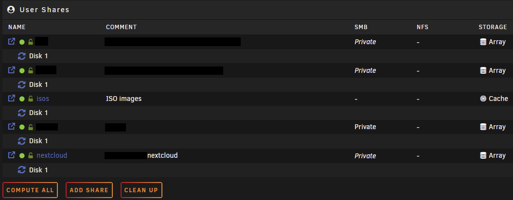

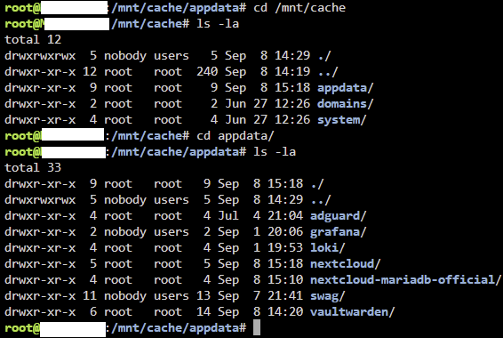

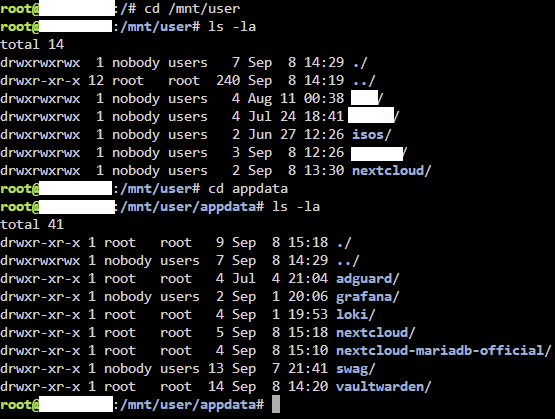

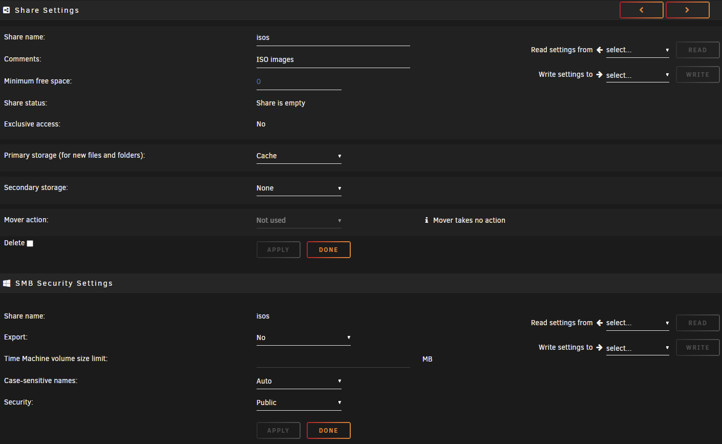

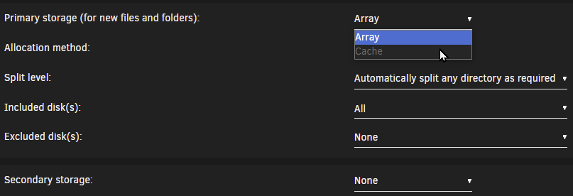

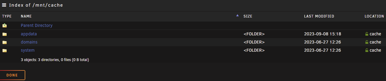

OK, so I went back and checked everything from the start. Saw that user share assignment was disabled on cache, enabled it and all the shares (re)appeared. So if anyone gets in the same mess as I did - that was the solution for me. Thanks to anyone who spent even a second looking at my troubles.

I'm sorry, I'll include it in the original post. To tell you the truth, I though I was helping by listing only what I thought was relevant from the diagnostics package. About the "missing share names", they're not missing, they have been clumsily "redacted" in my attempt to be as private as possible. To hell with it, it'll all be seen in the diagnostics anyway. Thanks for your time. If you find it in yourself to take another look, now I've posted the diagnostics, I'd be very garetful. Thanks in advance.

Hello, thanks in advance to anyone reading this with an inclination to help out; also, sorry for the long post. So, slowly setting up UNRAID 6.12.4 (first installed @ 6.12.3 version, upgraded recently) on a retlatively modern machine to replace my ageing i3-4330 CPU with 8 GB of RAM that served me and my family for years. The disks on the new one are setup as one zfs-enrypted drive in an array with an identical drive as parity, one cache disk formated as zfs. At first, while setting up the server, I kind of missed the fact that "appdata", "domains" and "system" share were missing from the GUI and then thought it was because I disabled VM and docker to be able to play with network settings and get them configured according to my need and my existing network environment and that they (the forementioned shares) would appear once I enabled the VM and docker service. I was wrong. Here's the config (appdata.cfg), as I've found it in the "diagnostics package" of the "appdata" share (the "domains" and "system" configs are identical except for the filename): # Share exists on cache # Generated settings: shareComment="..." shareUseCache="prefer" shareCachePool="cache" shareCOW="auto" shareSplitLevel="1" shareExport="-" and the share(s) itself/themselves are indeed located on the cache drive according to the GUI browser , but accesible both through /mnt/cache/appdata (or /domains or /system) and /mnt/user/appdata (or /domains or /system) in the terminal; probably because they're set to cache "preferred" instead of "only" as I'd prefer or? through cache: through user: The only "default" share present in the GUI is the "isos" share, for which the "isos.cfg" # Share exists on disk1 # Generated settings: shareComment="..." shareInclude="" shareExclude="" shareUseCache="only" shareCachePool="cache" shareCOW="auto" shareAllocator="highwater" shareSplitLevel="" shareFloor="" shareExport="-" shareFruit="no" shareCaseSensitive="auto" shareSecurity="public" shareReadList="" shareWriteList="" shareVolsizelimit="" shareExportNFS="-" shareExportNFSFsid="0" shareSecurityNFS="public" shareHostListNFS="" differs from what's (pre?)set in the GUI: The funny thing is, when I go and try and change the primary storage, I dont't seem to be able to (re)select cache. Through the cli, the "isos" directory/folder/however it's called is accessible only via /mnt/user/isos. Please help.
