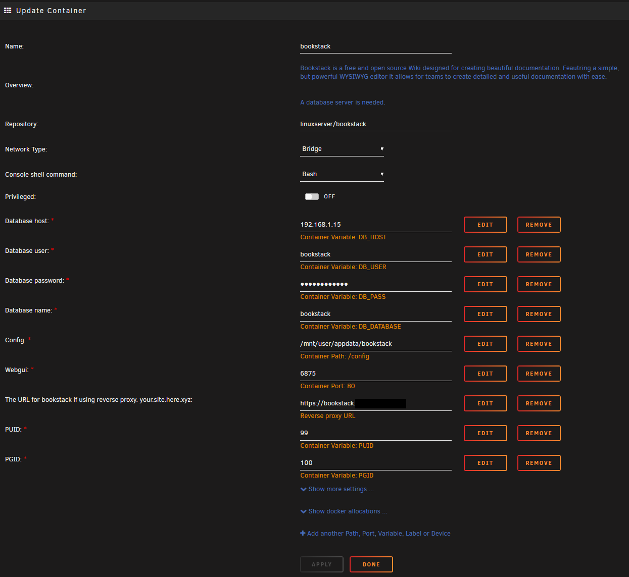

  7. Is there any guide for how to change the default username and password?
