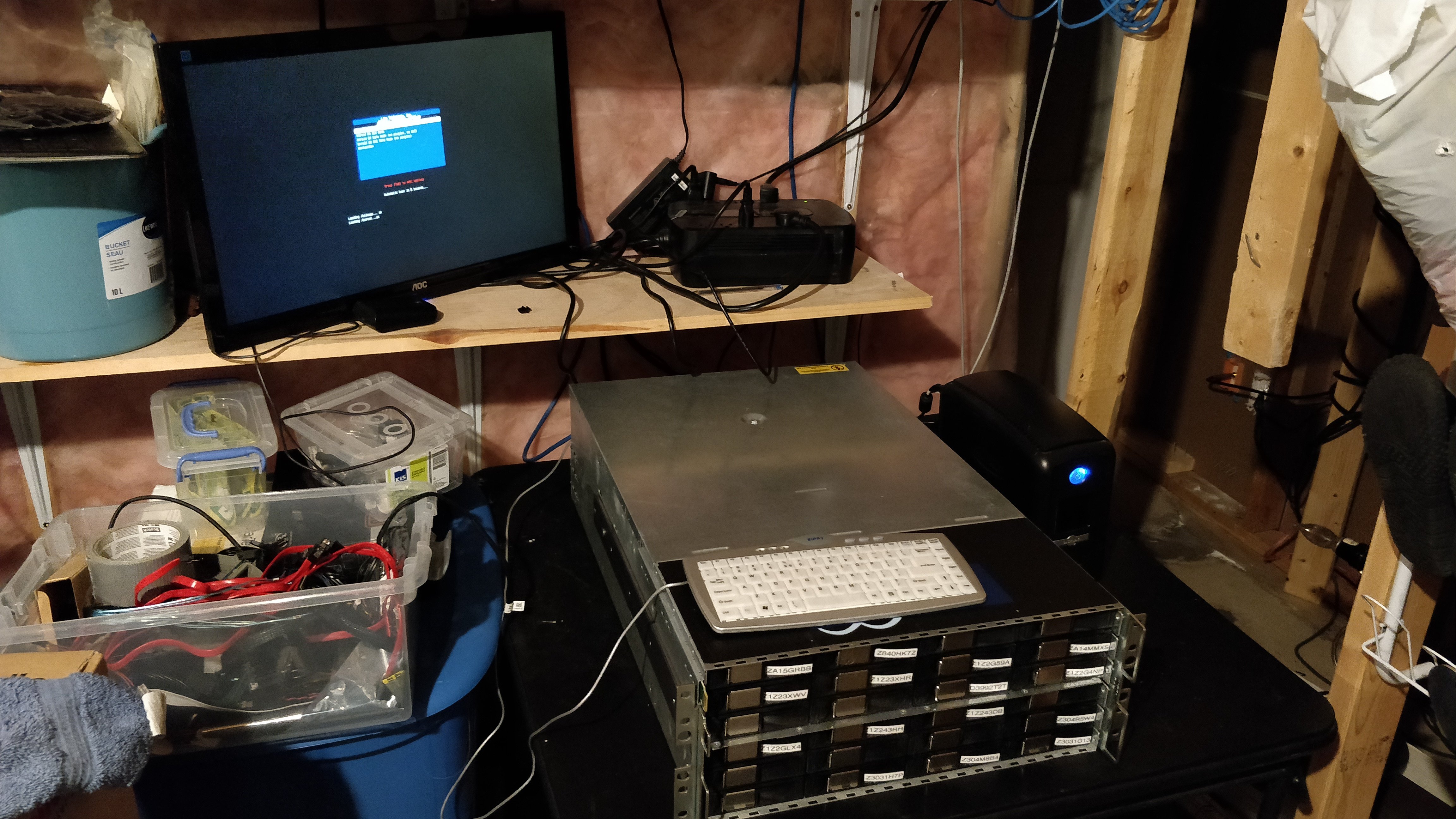

  1. it wouldn't let me type anything. I had to do a hard reboot.
